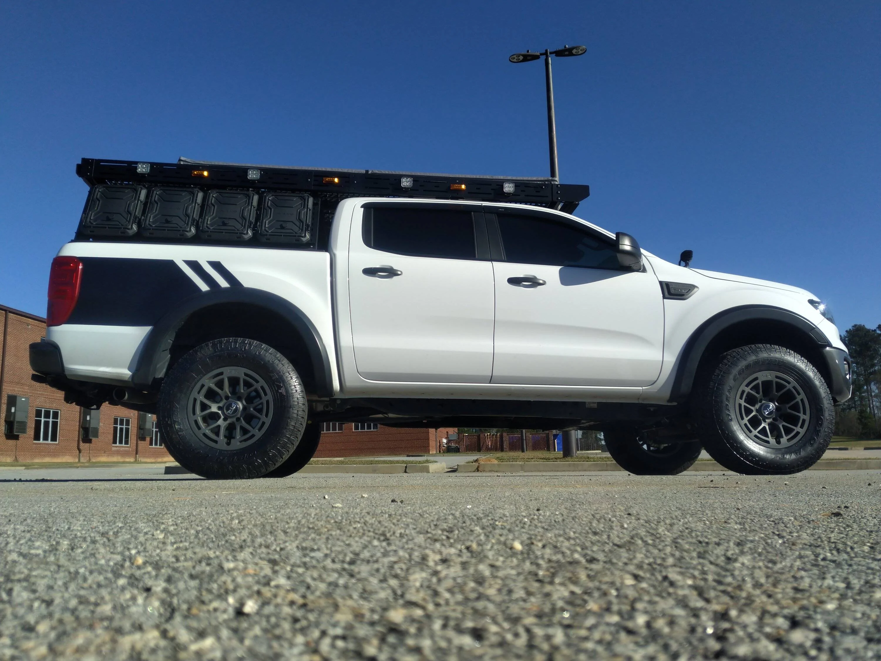

I've been trying to find good lights that won't kill me on cost. I like the flush mount style and would build/design/3D print a bracket to angle it towards the ground, but $60 a light is too rich for my blood. I need 4 to get the coverage I want.

Here's my setup. I just bought random 42'' LED light bars (single row) from Amazon - one for each side, and mounted them between the towers - they're secured but loose enough that I can rotate them. I still haven't actually used them along with the paddles to know if I need to relocate the paddles out of the way, but I plan on doing that anyways this winter. I also have small pods in the back that double as reverse lights as well.
https://www.ranger5g.com/forum/attachments/20210527_193203-jpg.88930/
Here's my writeup on it: https://www.ranger5g.com/forum/thre...-and-a-new-3rd-brake-light.12187/#post-243460
