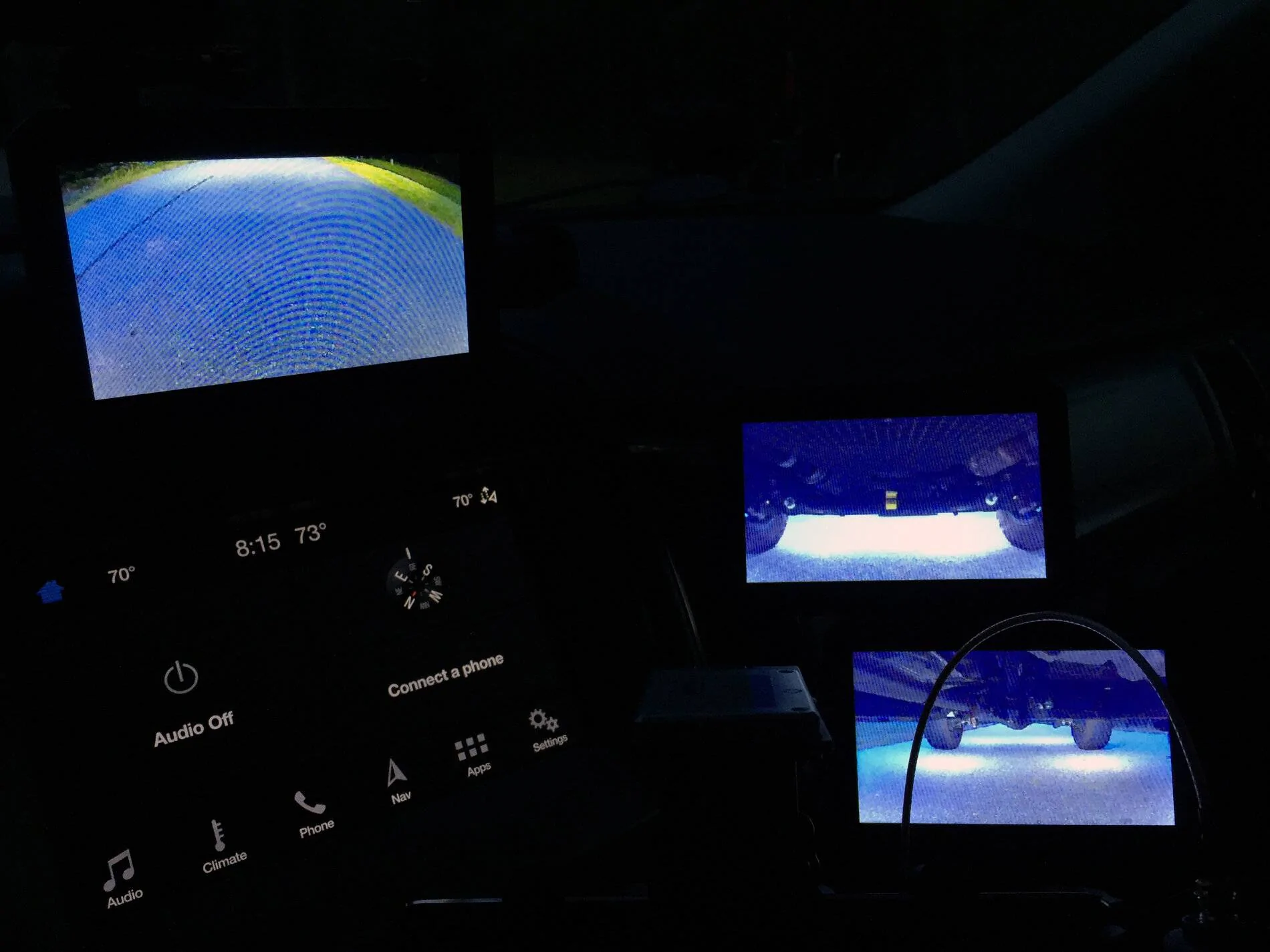

I have 8 under the truck and they're working great...haven't moved in many 10s thousand miles...at night, sometimes on pavement, I occasionally turn them on so I can see the wheels/tires in action (from my cameras of course)...I mount them to the frame, not in the wheel well...me, I prefer to see where my tires are on the trail...wheel well mounted rock lights are great for photo ops but in practice, just cast a black shadow right where you want...the contact patch... ?
The top monitor covers front bumper blind spot below the hood, middle monitor is facing forward, bottom is facing rear...

thats a damn set up! :clap: thank you for all that. if you dont mind me asking; how did you mount them? With that fender liner; im not sure how to mount them since there is not metal contact surface. Also, did you run the pro installer for aux switches or just wire yourself? Im going to be running the trigger 6 and it sounds like I dont need the additional pro installer set up or not. Not really sure what the "extra" options are. Im hoping I dont need them so I can buy the larger set for same price as just the small set with the switch lmao

Thanks Derrick...as I mentioned, I did not mount in the fender well as they'd be useless for lighting up where the tires contact the trail...my lamps are all magnetically attached directly to the underside of the frame in front and back of each tire...I also didn't use pro installer kit and just ran them up front, tied the lines together and wired to one of the Trigger 6 outlets...

oh shoot I misread that part of attaching the lights. I got so into your set up I got lost lol But that is good to know about not using the pro install kit as I did not see the need to add that if I plan to run to my trigger as you did. All that feedback helps!
