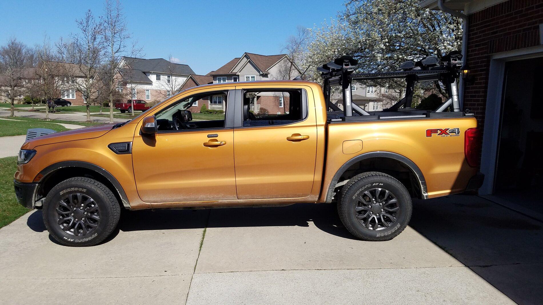

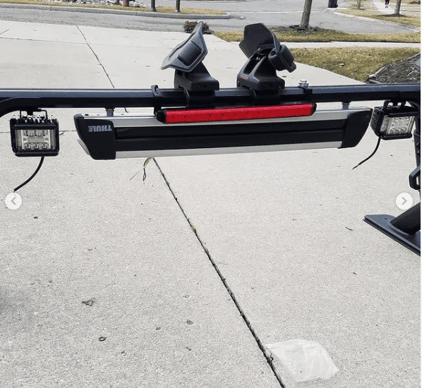

So I finally dialed in my Yakima Overhaul last summer to work as I wanted it (though I'm still debating on getting some side rails - Primarily for a recovery track mounting location), but realized that I'm pretty much completely blocking the 3rd brake light now. Whether or not it's legal, it isn't particularly safe that way, so as a winter project, I decided I was going to fix that by mounting a 3rd brake light to the rack.
Of course, as soon as I decided I was putting a light up on the rack, it spiraled into a lot more. I might as well add new reverse lights up there - the stock ones aren't as good as I would like, plus they get blocked and shadowed quite effectively when I have the bikes on the hitch. And if I'm going to be doing that, I might as well have a switch to toggle them on so I can use them to help setup camp at night. And if I'm going to be adding a switch, I might as well add some bed lights - the hard metal tonneau cover really keeps everything dark, even in the middle of the day. Heck - I might as well even put some side lights on for camping - the rear lights might not be the right angle :p.

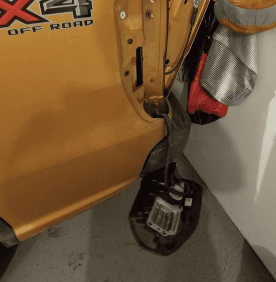

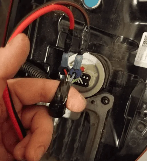

Up first was getting the brake and reverse light signal from the tail light. After popping the light out, I just did a quick pin out to determine which wires were the two signals I was looking for, and then used T splices to grab some power off of them.

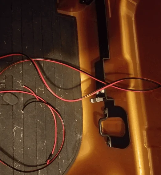

Up next was to route the 12V power for everything else. I used the harness designed for the 12V power outlet, but since I didn't have the right connector to just plug in, I used the same T splice method. Thus, I had all of the power into the bed that I needed.

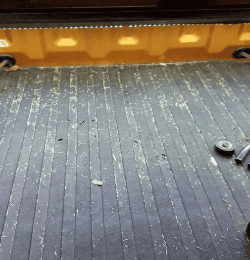

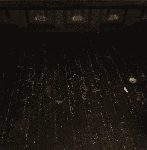

Up next was installing the bed lighting. I used 4 strips - one on either side, one under the cannister, and one on the side face of the cannister. Before and after pictures. Note - don't do this in the winter. They really didn't want to stay stuck in place due to the cold weather, and I actually had to redo a bunch of the tape this weekend.

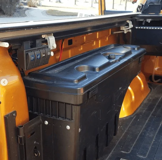

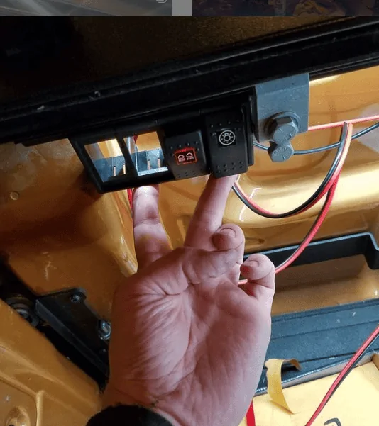

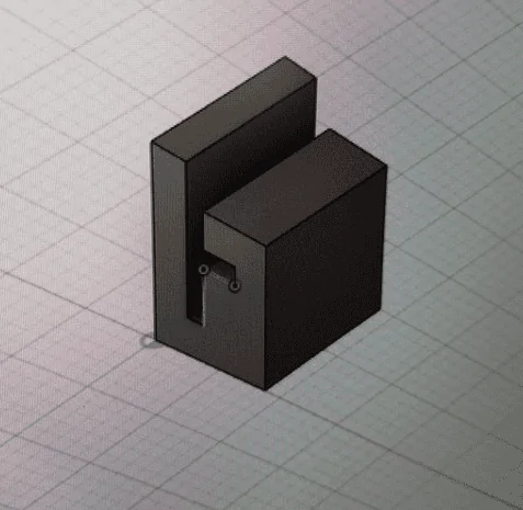

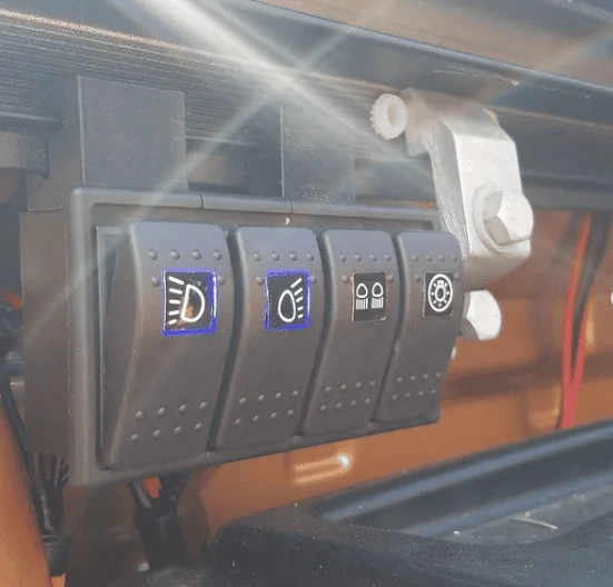

At this point, I needed to work on the switches. I knew exactly where I wanted them, but was struggling to figure out how to mount them. They fit perfectly above the swing away, and then are convient to access and everything is right there by the driver's side - The tonneau latch, the key for the tonneau, the swing away, and the light switches. Except I didn't want to drill anything into the truck, so I at a loss for awhile on how to actually mount it.

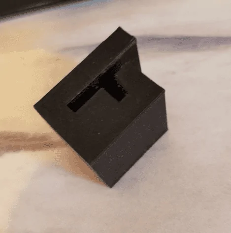

Enter 3D printing. I realized that I could leverage the bottom of the tonneau rail and make my own mount adapter that would just slide onto the rail and the switches would be suspended from that. So a few measurements, and a couple of trials, and I ended up with one of the few practical things I've used my printer for.
Originally I was thinking that I was going to use a screw to attach the switches, but after struggling with it for a bit, I ended up just saying screw it, super glue it is. After all, it is plastic to plastic. But I finally have switches mounted properly.
Now, one thing that I don't particularly like, but don't care enough about to fix... When I was first thinking this through, I was expecting to have a bi-pole circuit switch, such that I could toggle the reverse lights to be powered by the reverse signal, or by the 12V power. But since I switched to these 20A switches, they are just on/off. So when I turn the 12V power on, it turns on the reverse lights on the truck as well. Oh well - a bit extra light when camping.

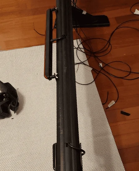

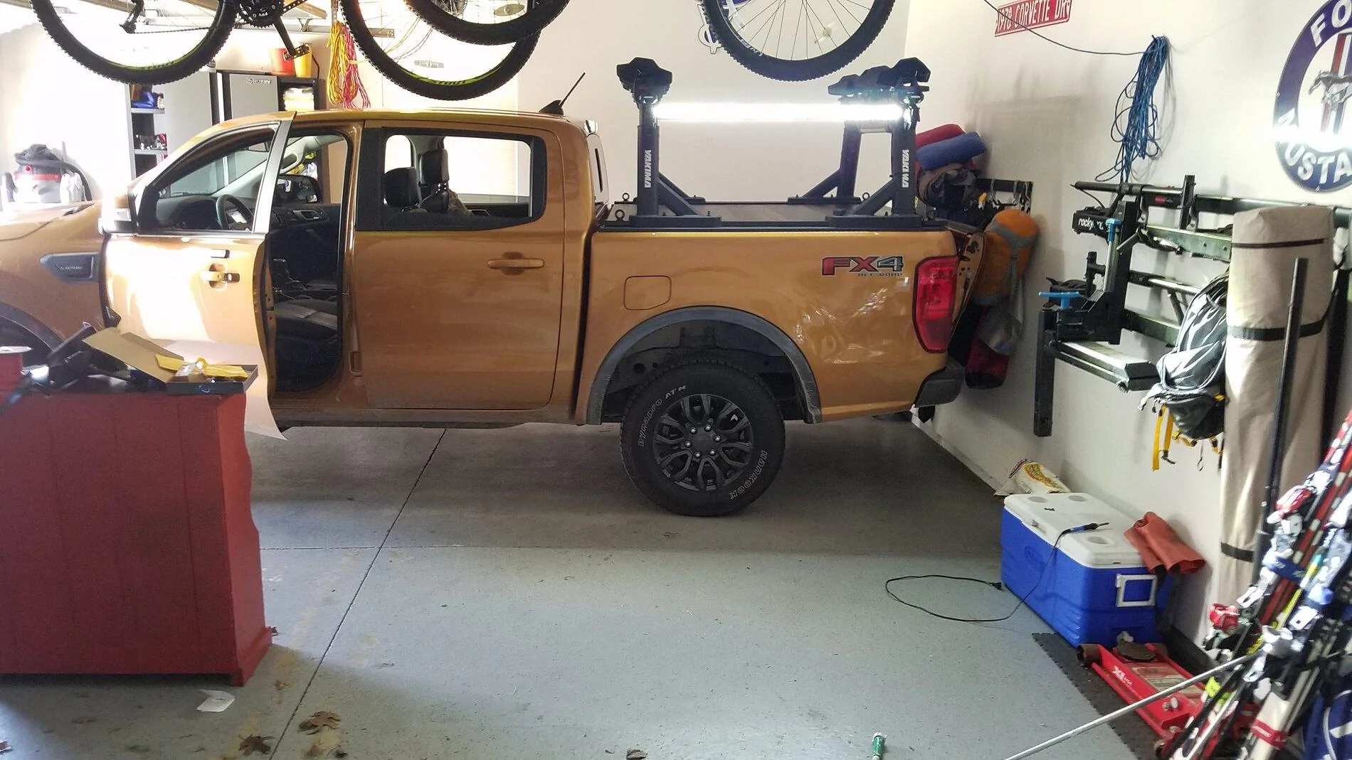

Moving my attention to the rack, I've gone ahead and mounted the lights (well, test fitted at least) to the rear rack - everything just barely fits. I still have to wire it all up over the next few days/weekend. And then once everything is wired up, I'm going to go ahead and mount it up on the truck a bit early this season, so I can measure the spacing between the two bars, so I can by the right length of light bars for the L/R camping lights.
I'm pretty sure I'm starting to run out of real estate on the rack (not pictured are the kayak paddle holders on the underside on the outside of the uprights with custom brackets to angle them at a 45 to allow them to clear the uprights). But it does look like there's a bit of space right between the kayak mounts, and obviously a bit of space on the front bar where the reverse lights are on the rear bar...

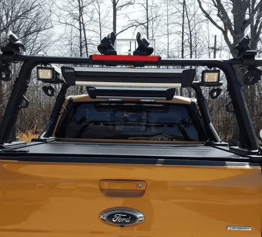

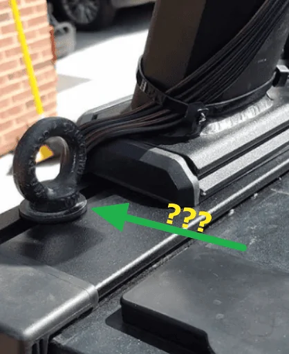

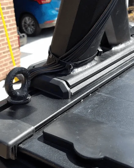

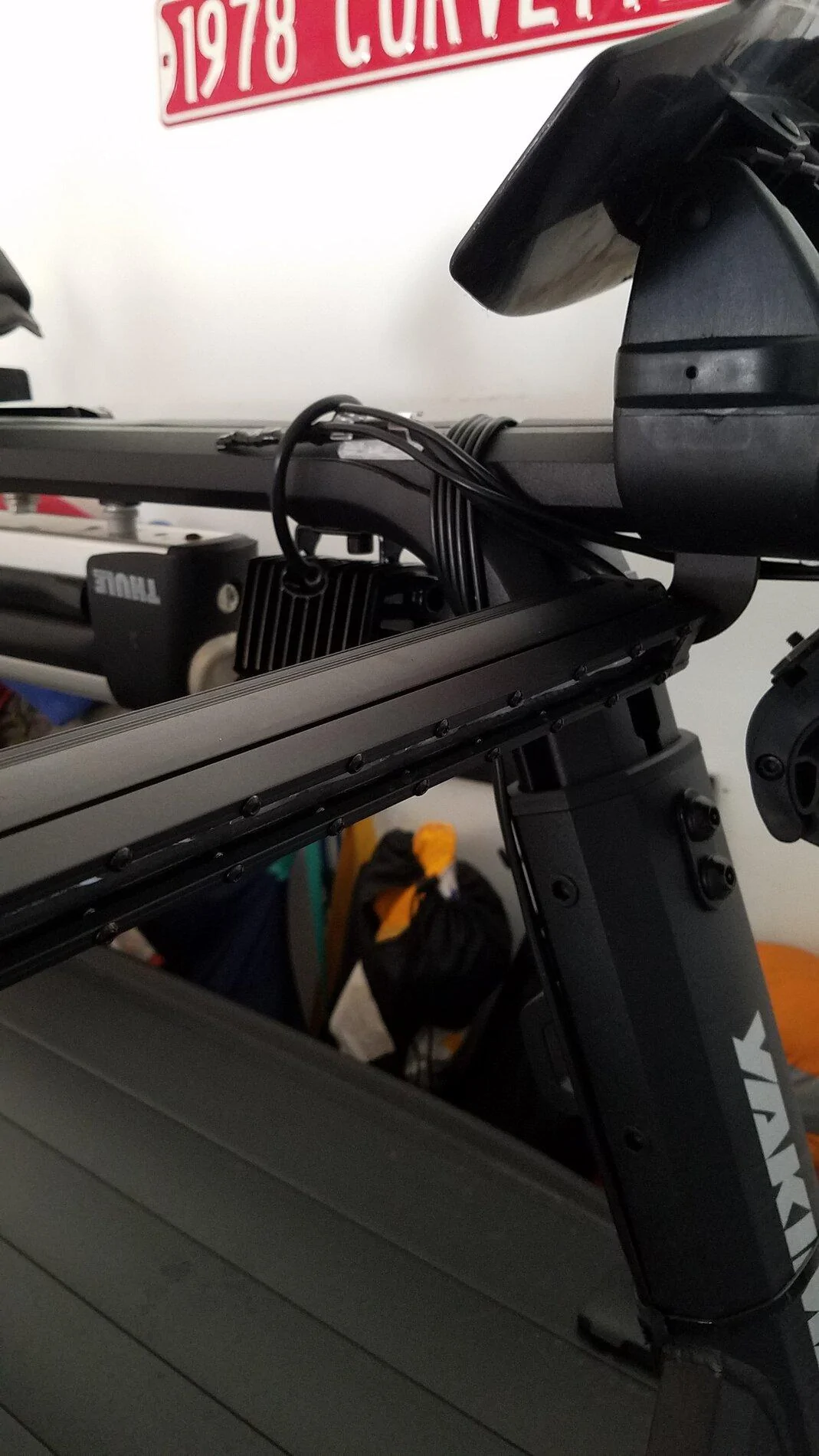

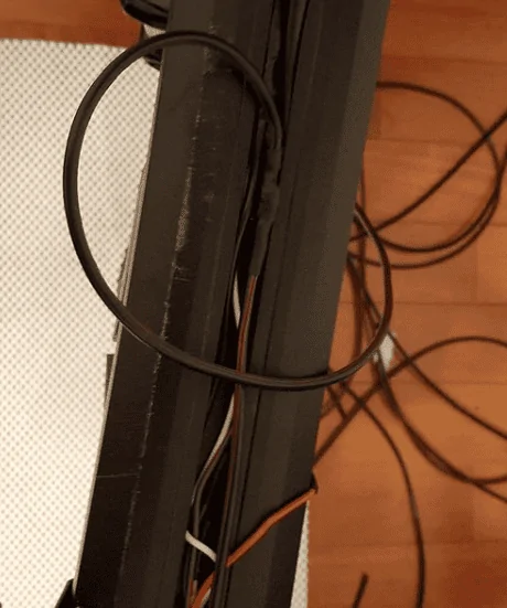

Part two... I finished running the wires along the rack. This was the one place that I decided to solder the connections instead of using wire nuts. This kept the profile of all of the wires low enough that I was able to reinstall the weather strip onto the crossbars, keeping all of the wires inside and neat.
From there, I used some heavy duty zip ties to keep them neat and aligned going down the inside of the upright, and twisting around under the tonneau cover.

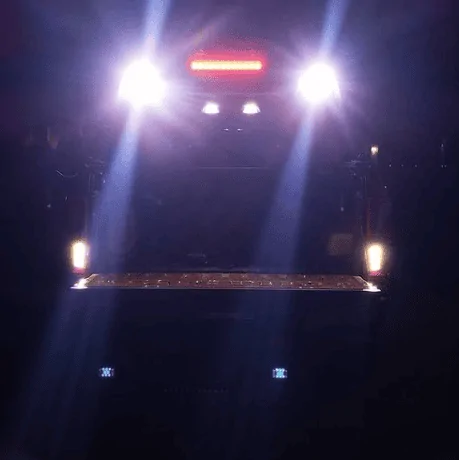

End result for the brake and reverse lights:
I currently have the side LED wires just wrapped around, waiting for the delivery of the LED bars. I had to reinstall it all so I could measure the proper length between the two uprights to order the right sized bars.

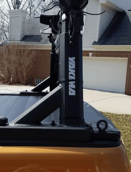

Nice clean install. Are you still able to raise/lower your rack ?
Did you mount the side LED strips to the bed or cover rails ?
Which t-slot eyelets are those ?

I haven't actually tried to raise/lower it since I have it all dialed in at the perfect height (minimum height to mount the paddles and have them clear the doors, maximum height for it to clear the garage). That said, there is excess wire inside the bed that I could use if I ever wanted to raise it.
That is the Yakima Eyebolts. They work great in the back as a tiedown spot for the stern lines of the kayaks - allows full usage to the bed/tailgate. I picked up a second set for the front, and they really aren't anywhere near as useful up there. Every time that I've thought about using them, I end up just using the forward tie downs in the bed itself (2019 Ranger, so I have all 6).
The side LEDs (which should be showing up in the mail on Thursday) will be mounted to the cross bars - one mount on the front bar, one mount on the rear bar. Looking at where I have space on the rack, it should be on the underside, inboard of the kayak paddle mounts (or possibly sharing the same bolt).

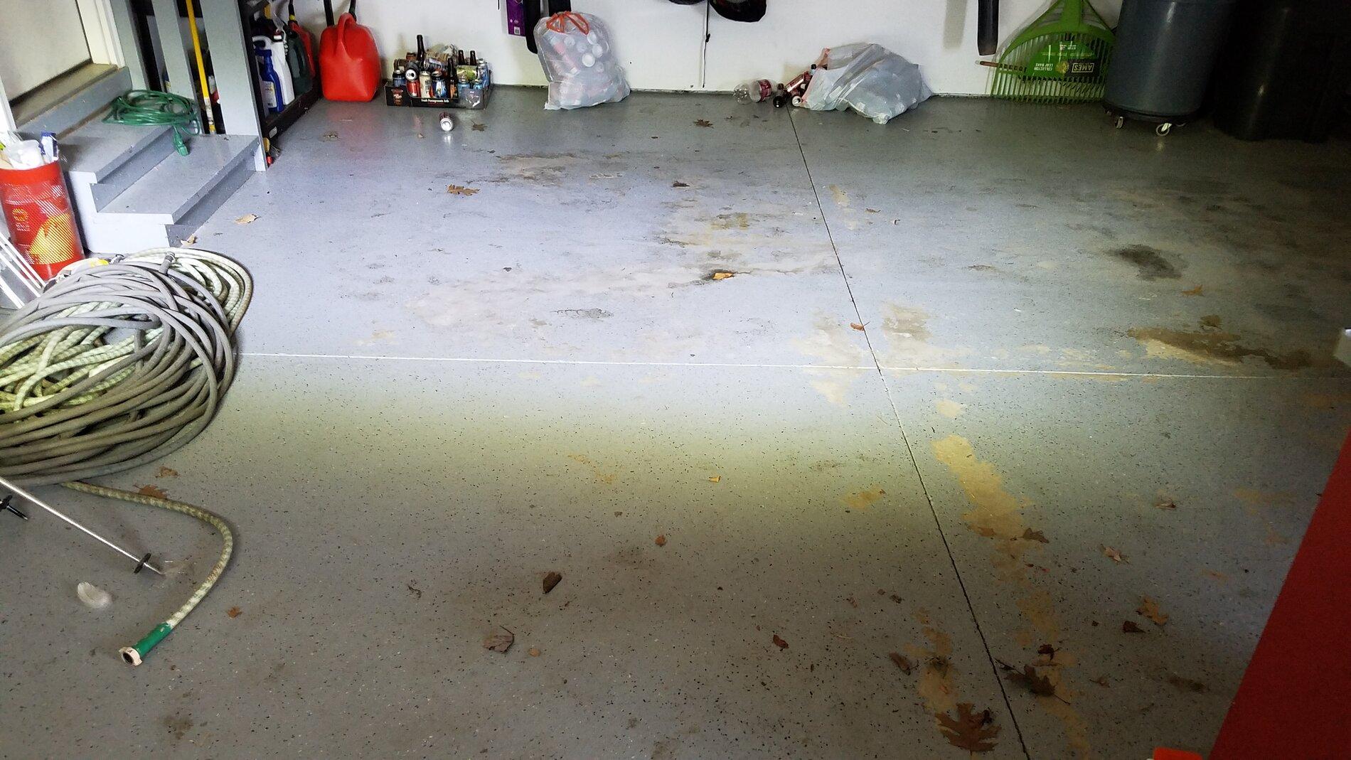

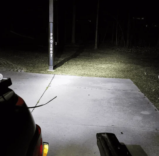

I ended up using these 40'' lights for the sides. https://www.amazon.com/gp/product/B0829PQ5WC/ref=ppx_yo_dt_b_asin_title_o03_s00?ie=UTF8&psc=1
I finished it all up last night, but forgot to take pictures in the dark. Whoops. I adjusted the angle such that as long as you're more than ~2ft away from the truck, the light isn't in your eye, so even looking back at the truck, it's not blindingly bright, which was something I was concerned about. They provide a nice bright area 5-15ft away from the truck (though you can still rotate the bars slightly if you need to adjust the aim), and even though they're tied to a 20A fuse, I can have all 4 switches turned on at the same time without any issue, though it does dim them *slightly*. Please ignore the messy garage - cleaning it up is now on my weekend todo list.
Once again, I soldered the side bars. If I had them in advance, I would have tucked them inside the weather striping like I did the others. But since this was an "add on" type thing, I ended up soldering them outside, and then just using a cable holder to tuck them up against the cross bars. Probably the messiest part about the entire install, but they're not really visible anyways. The connections are soldered, heat shrinked, individually taped, and then taped together, so the end result is a bit of a blob, but shouldn't have any weather related shorts.
The wife complains that the reverse lights are too bright to use as camping lights, but that's kind of intentional. Unlike the side bars, the pods provide a much broader illumination - their main purpose is for backing up after all. But as such, when you look towards the truck they're super bright in your eyes.
