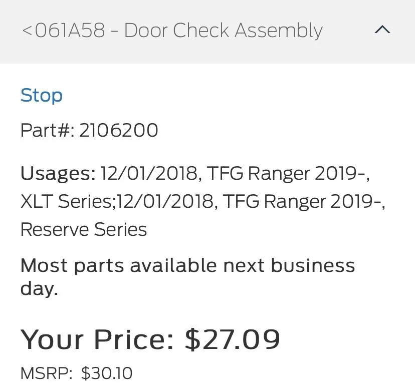

That is unfortunate, I suppose they forgot it or we found another thing Ford cheaped out on
I don't see the need for the tether cable really if the glovebox is still retained in a manner that supports the weight which it does... Probably has to do with being an XL owner lol. Maybe some other 19/20 XL owners will chime in

My 2019 XL has no glovebox damper

In case an XL owner feels slighted... $27 to get to that XLT level
As I imagined lol. Someone here really thought I was trolling about a stupid f*cking glovebox damper and had to ask if others were the same lol.
I don’t feel slighted by any means. I think they didn’t put it in the XL’s because XL owners are strong enough to drop their glovebox to a resting position without the need of assistance ;)

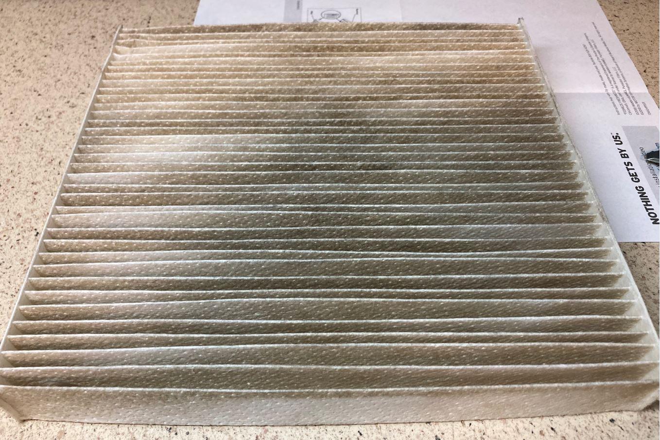

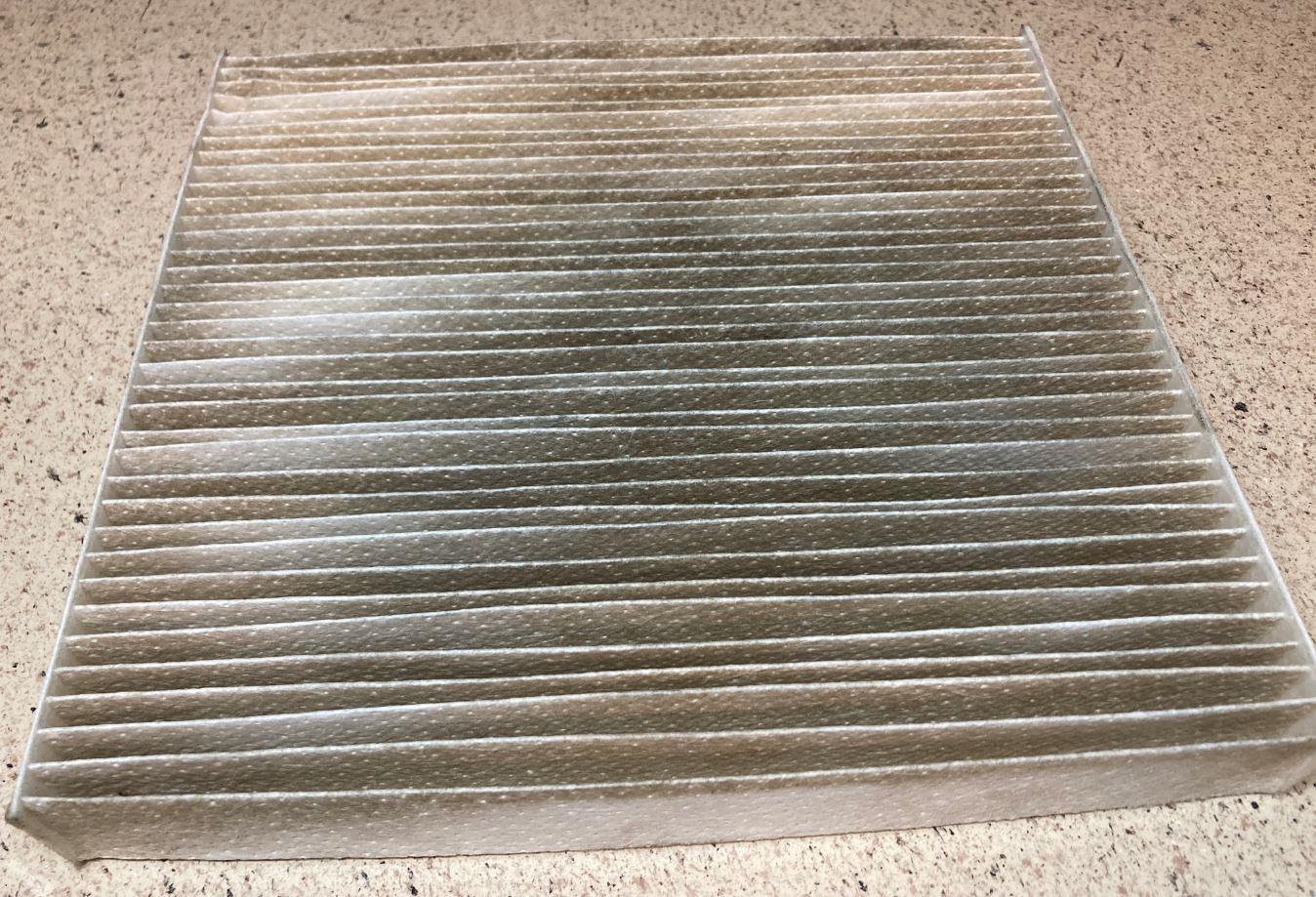

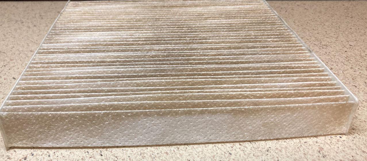

Hey guys, check out the old cabin filter I replaced. Bought the truck with 14k on the clock and the previous owner had obviously smoked inside. Treated the cab with ozone which zapped almost all of the smell. Replaced the cabin filter with this one and the smell 100% is no longer present. Just wanted to share!
Makes me glad I gave up smoking.
