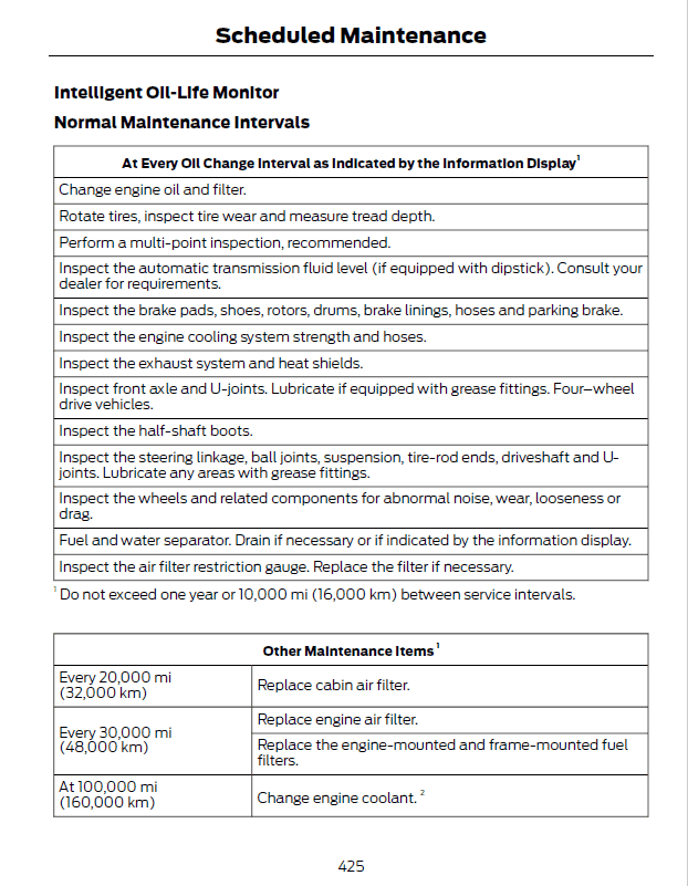

From the manual, but I don't know the procedure for replacement.
CABIN AIR FILTER
Your vehicle is equipped with a cabin air filter, which gives you and your passengers the following benefits:
  • It improves your driving comfort by reducing particle concentration.
  • It improves the interior compartment cleanliness.
  • It protects the climate control components from particle deposits.
You can locate the cabin air filter behind the glove box.
Note: Make sure you have a cabin air filter installed at all times. This prevents foreign objects from entering the system. Running the system without a filter in place could result in degradation or damage to the system.
Replace the filter at regular intervals. See Scheduled Maintenance.
For additional cabin air filter information, or to replace the filter, see an authorized dealer.
