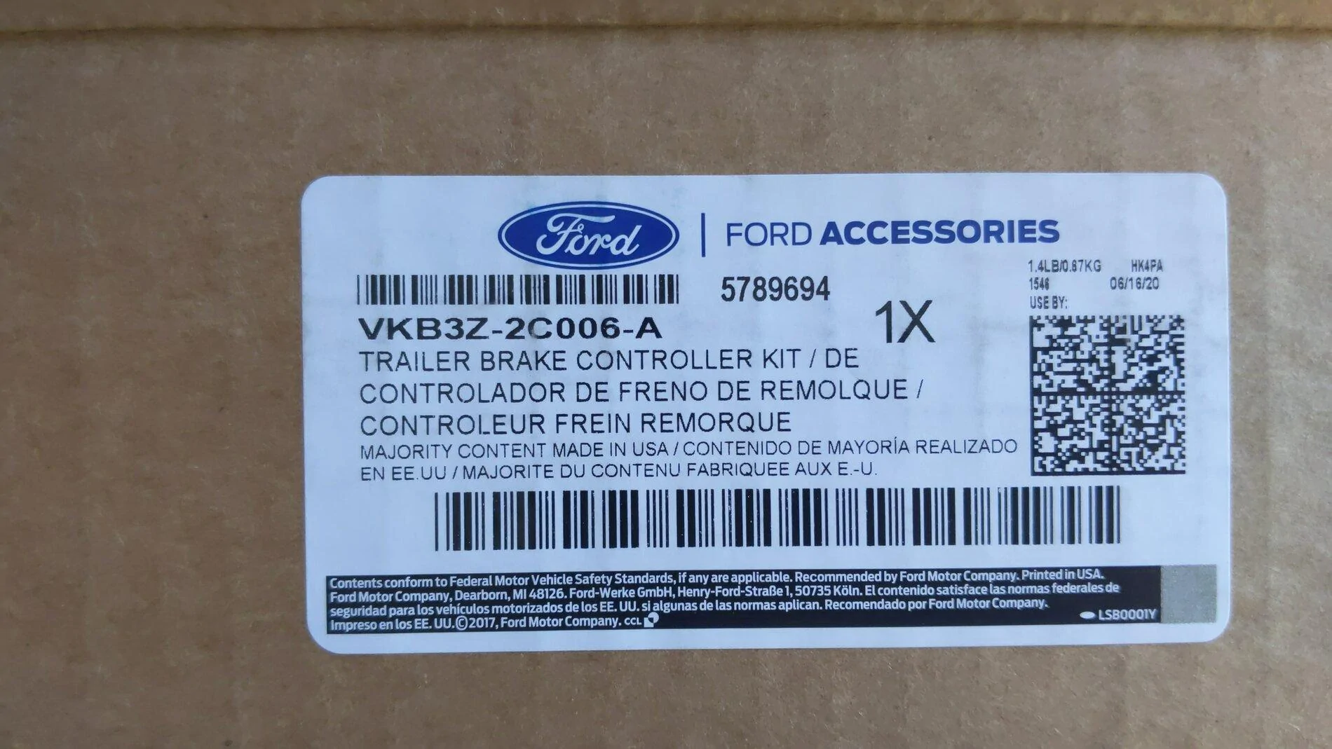

To whomever ask, Ford now has a genuine Ford trailer brake controller for the Ranger. I just installed mine, it was kind of a pain in the ass. you have to run the wire from under the dash all the way to the third brake light. And then it comes with a set of connectors to connect in line with the third brake light. And you have to put the pins into the connectors yourself.
Here's a picture of the label for the brake controller.
