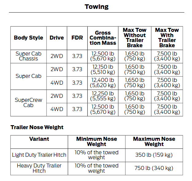

There is no brake controller for the Ranger available through dealerships yet. There wasn't even a part number when I asked my lead parts manager 2 weeks ago. When that original info came out quite a while back, it was determined that the one single dealer making those claims was looking at the F150 add-on brake controller, and then making the assumption that the Ranger would have the same setup, which is not the case.
When one comes available (ford OEM dealer installed type) will someone make a announcement for all to know? And yes I don't understand why they couldn't get some Chinese company to do this a year or two ago when they knew you had to have one to pull that much weight or get a surge break trailer. Oh have any of you guys seen how much your truck is rated for or are you just assuming 7500?? Mine says 6060 what's yours rated for? Check the tag. Buy a drop hitch that's rated for 8000 lbs. And that's not the el cheapo one at wally world they only go to 5000. Change the things you can accept the things can't and foremost know the difference.
GVWR is the total weight of the vehicle plus any cargo/tongue weight of a trailer. Mine is 6050 LB.
