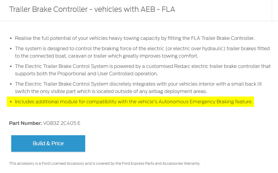

This is why I think it has to have some kind of flash in order to work. Unless we're not getting this feature and the truck will use it's own brakes autonomously and not tell the trailer.
Straight from Ford.com.au
2019-03-20 08_24_29-4x4 XLT Double Cab 2018 Ford Ranger Accessories _ Ford Australia.png
In general what AEB changes for brake controllers is that you can't necessarily tap the brake lights to see if the brakes are activated, because some AEB systems flash the brake lights. If you dig into the redarcs in .au you'll find that they're very clear that the AEB trucks need a slightly different harness that taps into a "brake on" signal in the newer global ranger. I don't read the above as suggesting it's some kind of flash to enable anything in the dash.

A module is an additional piece of hardware that plugs in. That is completely different from a software flash.
All it takes is a simple misinterpretation of a description online, and all sorts of folks start spreading rumors, and then trashing a manufacturer and it's suppliers for knowing nothing about some fictional feature that doesn't really exist on their product.
Gotta love the internet.

It doesn't help that other dealers confirmed that there is something available and were quoting 75$ for a PCM flash, this is straight out of an email from a dealership that one user on this forum posted, so yeah, they don't know anything... And a module could very well need a flash to enable the truck to talk to it, so I think it's a reasonable assumption to make.
