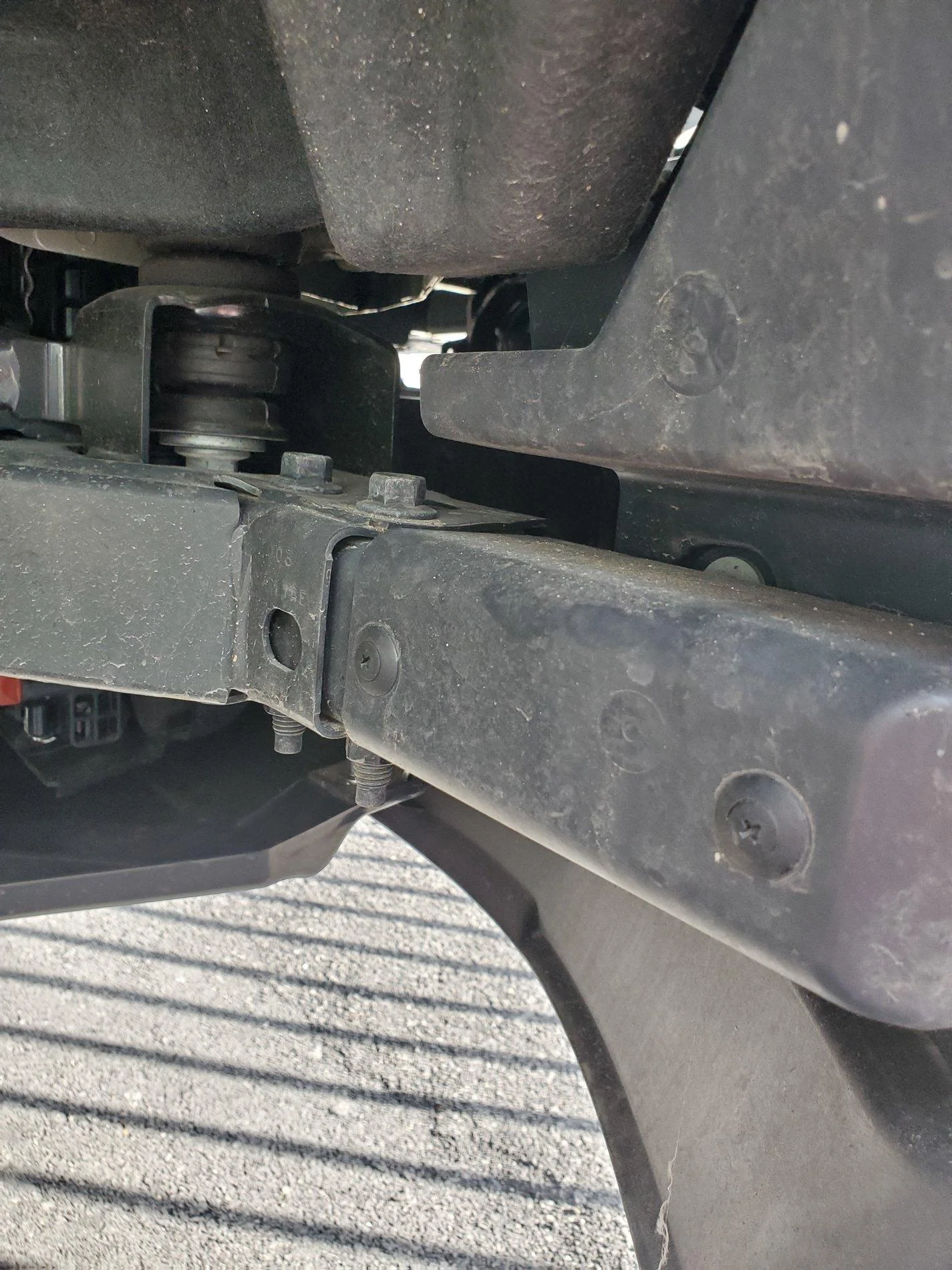

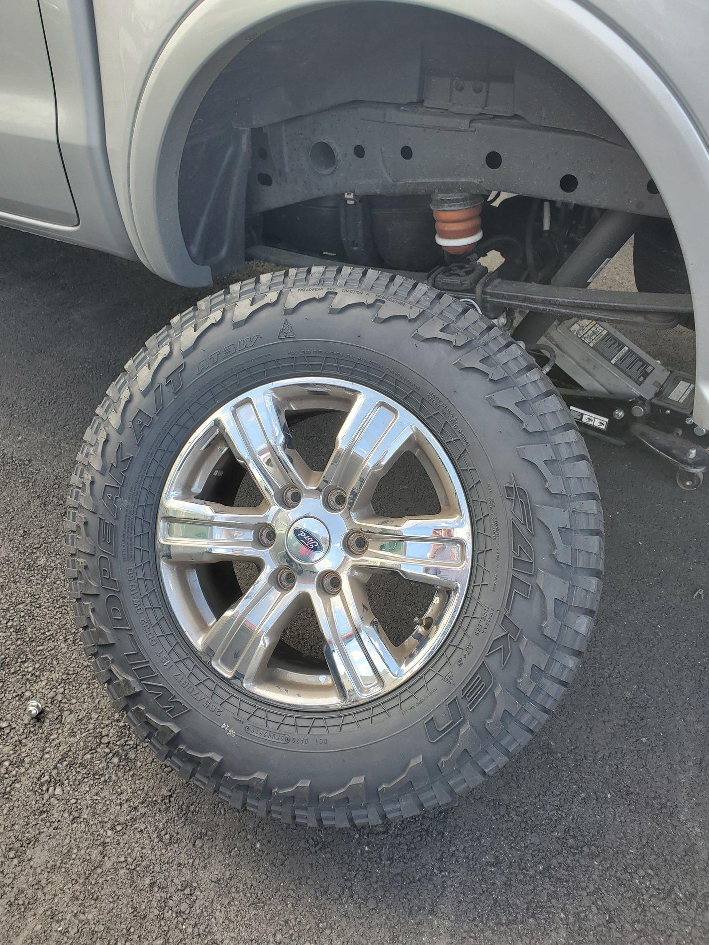

This forum is very helpful, so I am posting here my setup which no one really had. I have chrome wheels on my truck and could not find anyone with those wheels and a bigger tire. So here you go, stock chrome wheels with Falken Wildpeak AT3W 265 70 R17 tires. Stock height, light rub full locked when backing up,
crash bars pushed forward on right side but still rubs.

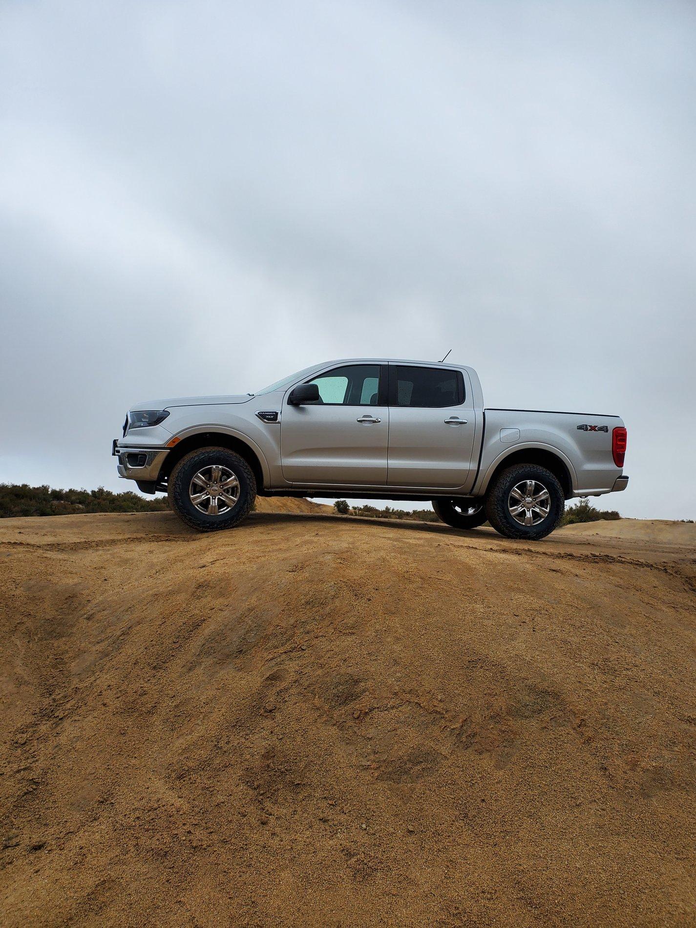

I went with the Nitto Ridge Grapplers 265/70/17 which are 1" taller and WAY more aggressive than the stock tires along with a 2.5" RC level kit. I wanted to go 285's but didn't want to kill my mpg's and then you have to modify the crash bars which is no big deal but I wanted to keep it simple.

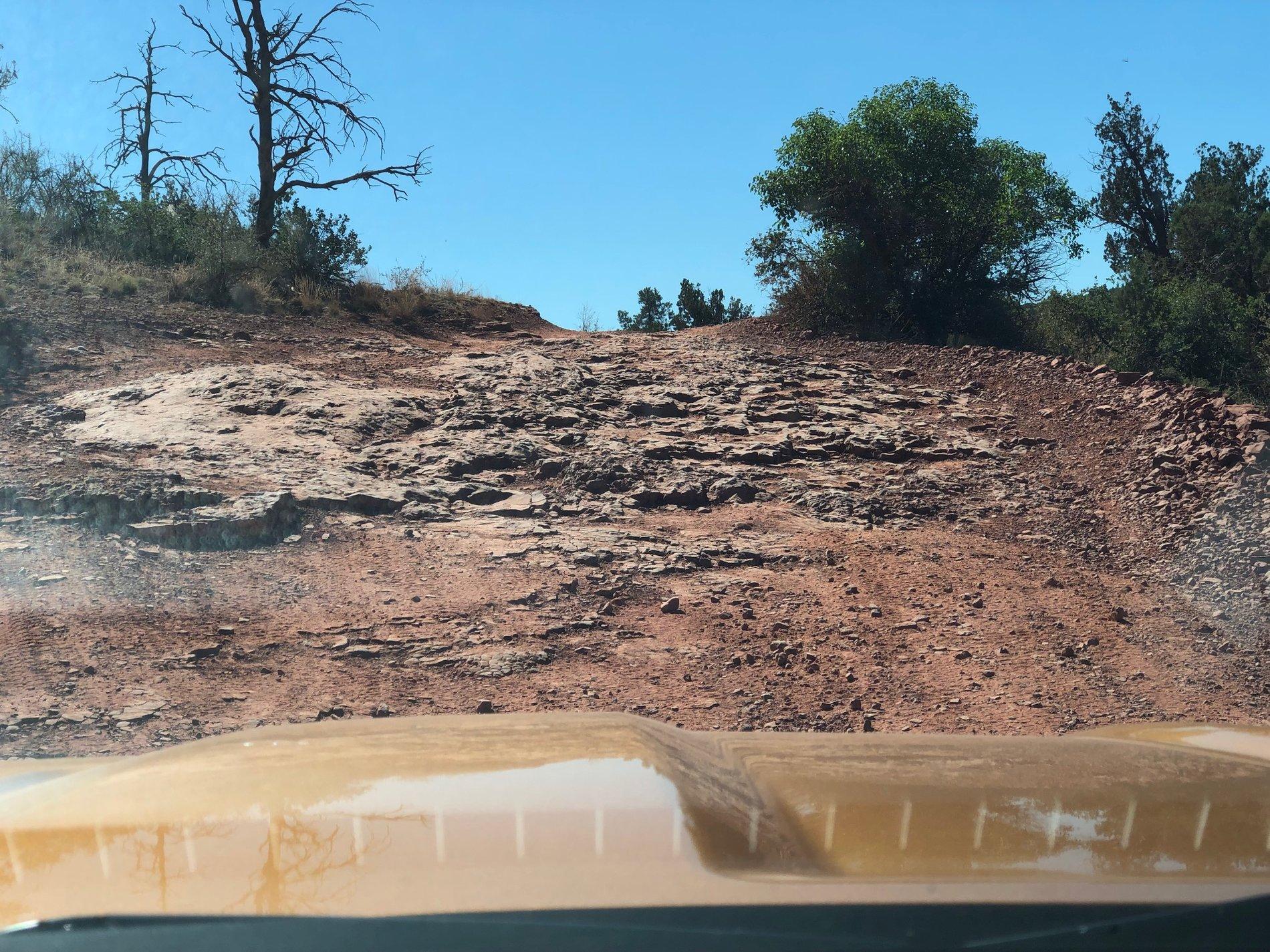

I think you might be confusing yourself with the performance....street vs off road. You're going to get better performance off road with these than the stock tires. No way I would take the stock ones off roading in rocky terrain but for fire roads and soft sand the stock ones will be fine. You're going to get better mpg's with the stock ones on the street as they have less weight,they're only 35 lbs where my Nittos are 43.65 lbs. I will say that mine are just as quite as the stock ones and I'm still averaging around 21 mpg if I drive it normal with a mix of 70% city and 30% highway driving.
We go shooting out into the desert a lot and there's a mix of soft sandy washes and some rocky stuff depending on where we go. We also go up to Sedona a few times a year and it's pretty rocky up there so having a more aggressive tire is a must. I run mine at 32psi cold and when off road I'll air down to around 22-24 psi but only in the rocky terrain,in soft sand I leave it alone unless we get into some really deep soft stuff.

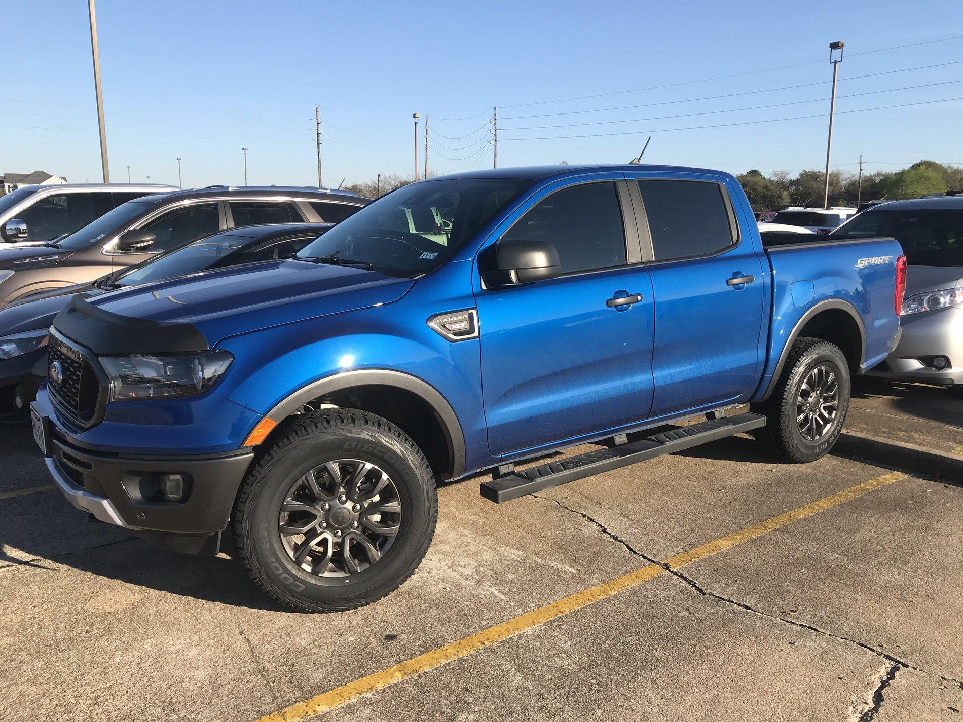

I went with 255/80/R17 Nitto Ridge Grapples. Zero rub at full lock both forward and backwards with a Fabtech 2.5" leveling kit. The tire measures 32 5/8" tall although the tire size sites list that size tire as a 33.1".
I don't know about the sizes you have listed but I can assure you the tires I am running are a almost 3" taller than stock, so 1.5" higher. That's 1.5" more of ground clearance and who knows, that maybe the amount needs to clear something or get through a deep spot.

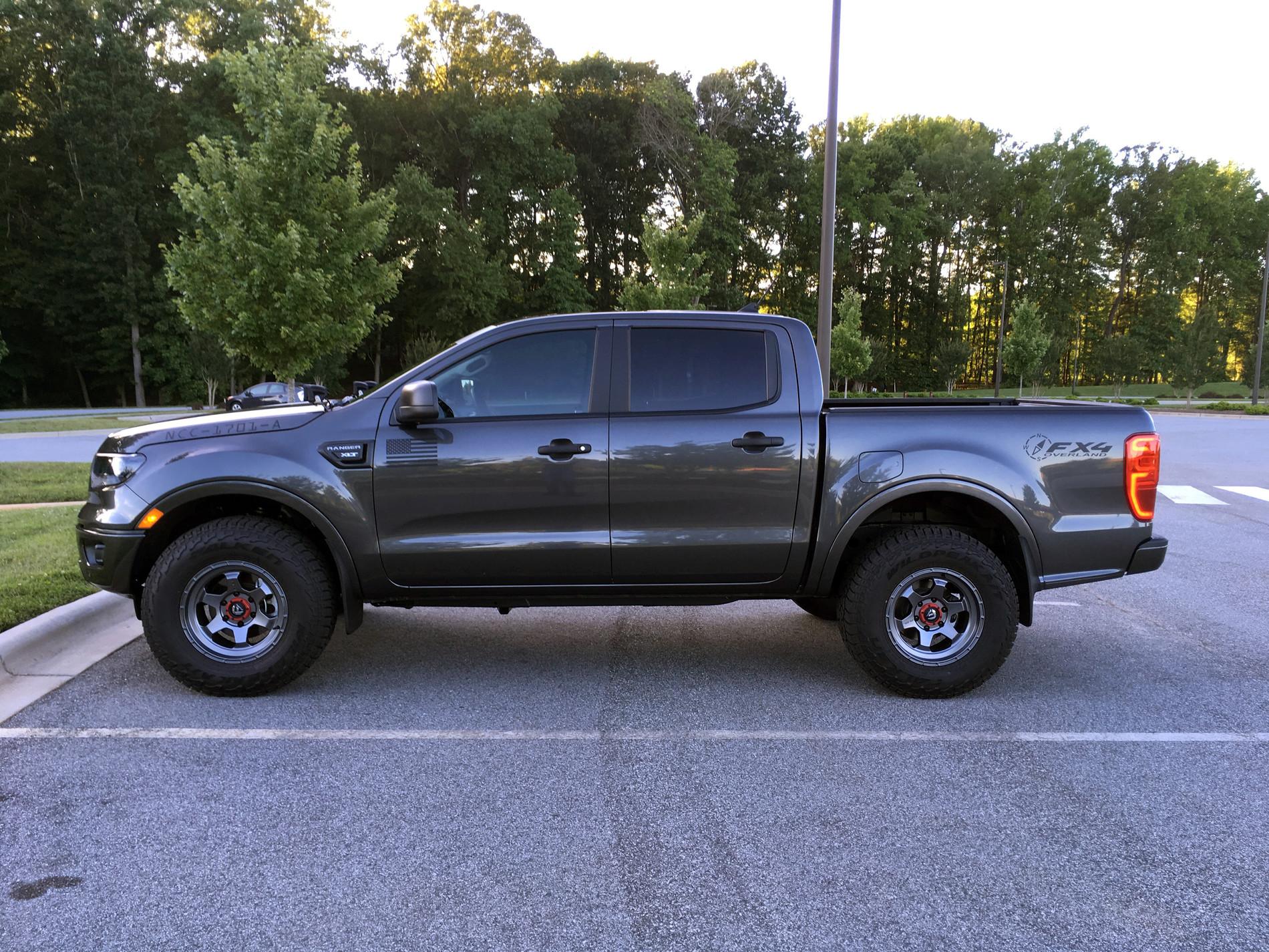

285/70-17, no lift yet thanks to Eibach dropping the ball:headbang: But with the front/rear beams removed, everything clears. Slight rub on rear liner at extreme lock but not an issue. Liner shows no wears after thousands of miles. Caveat...I have +20 offset and you will need the same if you want the same result :)
Okay I loved this look with the metallic grey and finally pulled trigger on the fuel shok grey 17x9 +20 wheels with radar renegade 285/70/17 tires. and woolworth 3 in level. level kit in and wheels shipping soon hope to share pics soon. not trying to steal look but loved it
