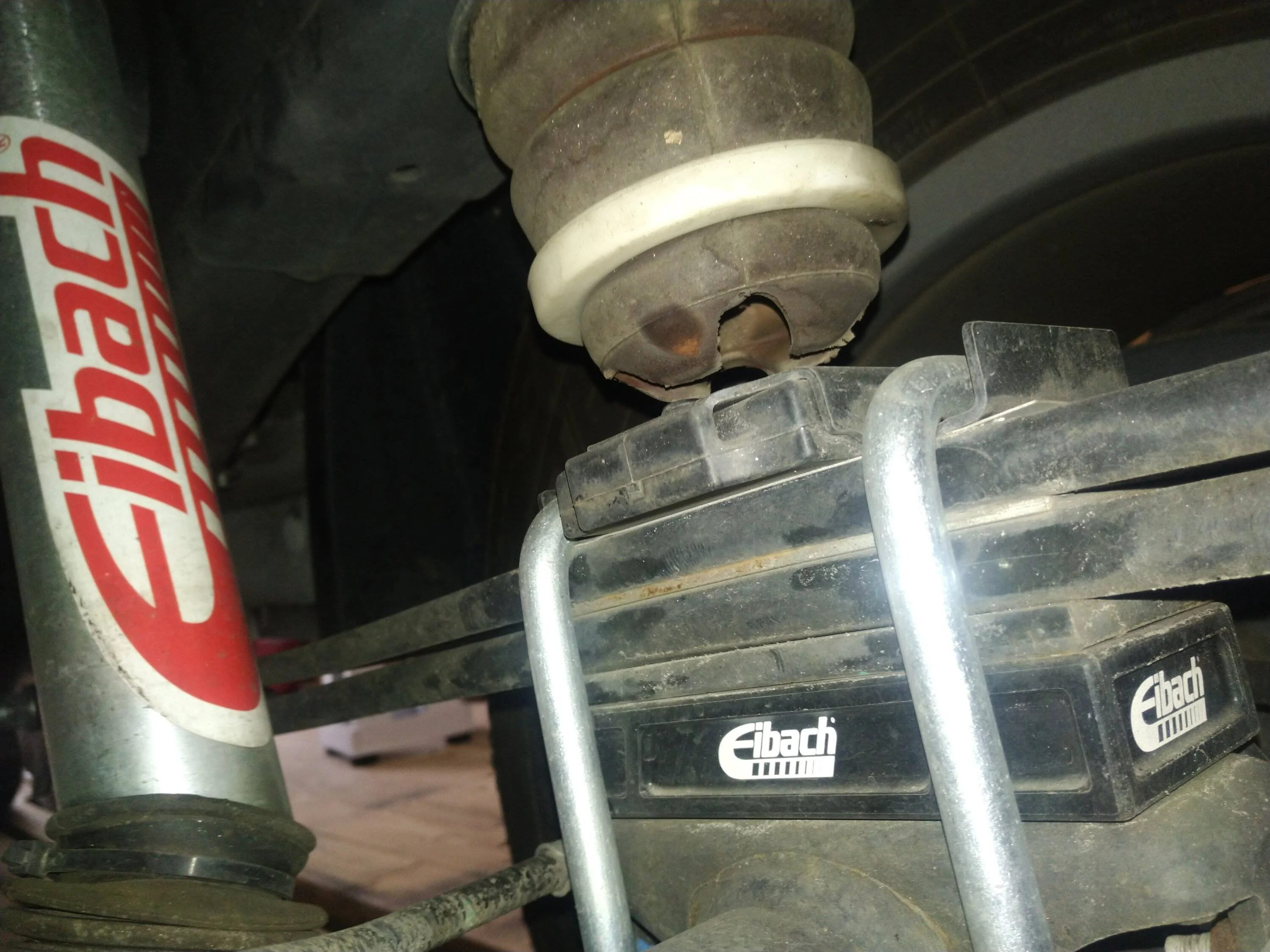

Jack, Sumo's aren't "springs" but replacement for the stock bump stops. OE bump stops are basically hollow rubber sleeves with that plastic type ring. Theres no "progression" per say...when your springs bottom out against them, it's basically a "jarring" severe hit.
The Sumps are made of a material that is made to compress...the more pressure the more it supports the pressure placed on it, but without any "bottoming out" that you get with the OE bump stops.
Check out your truck to see how much room is between the OE bump stop and the spring perch.....if very little room that means that any additional load, or bumps in the road are causing your OE bump stops to bottom out.
With the Sumo's, even if the spring perch is resting on the Sumo's, it's not a problem as they will progressively compress.
Think of the oe stops as plain foam rubber, and than compare that to memory foam.
I know your carrying a fairly heavy load, and you still might want to look at springs, but the Sumo's will also help.

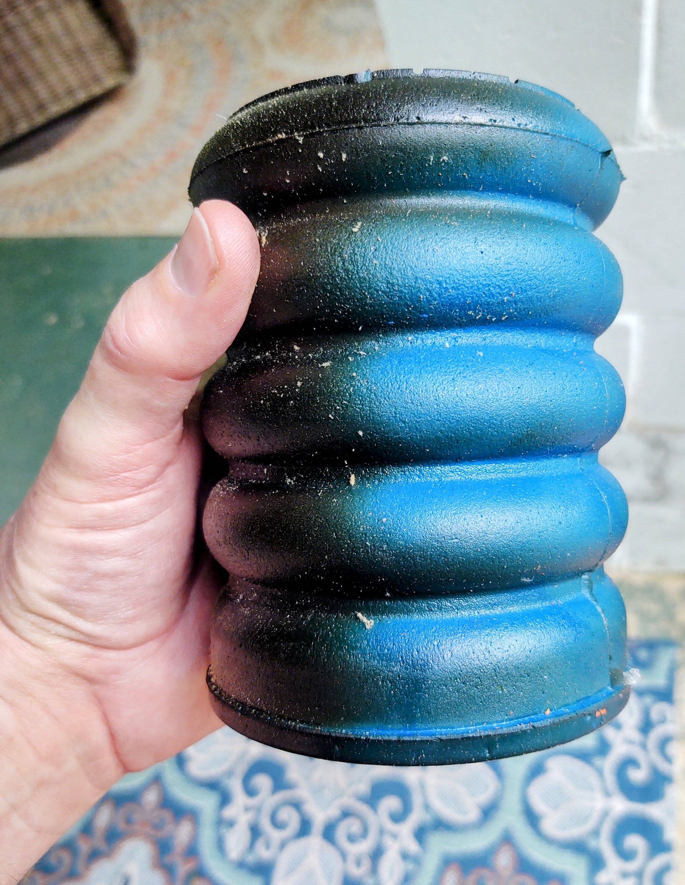

For reasons I haven't had a chance to install mine, and left the box under a carport at one of our properties. Three months later I'm back and noticed the sides oriented to the sun has turned black. In a panic I messaged/emailed Adam asking if this would affect the integrity of the Sumos and he said no. He pointed out a lot of things can cause them to discolor, but I think I'd like them black all over.

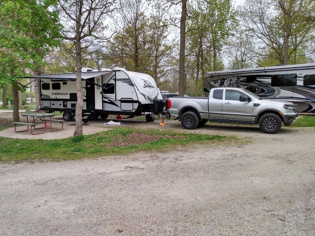

I'll jump in and tell you they are worth every penny. We're on the road now heading up to Mackinaw and towing our 7000 lb trailer/700 lb tongue weight.
When we're hooked up the spring perch is actually contacting the Sumo's and when drivin there is no jarring when we hit a bump/road transfer/ bridge crack, ect.
The stock bump stop is hollow and compresses violently, but the Sumo's cushion the ride compressing as needed.
100% sold on them.

Apologies if you've mentioned it before, but do you have the blue or the black sumo springs? I ask because I have a similar weight TT (6,000lb loaded, approximately 700lb hitch weight) and am trying to determine if it's necessary to go with the black sumo springs over the blue.
