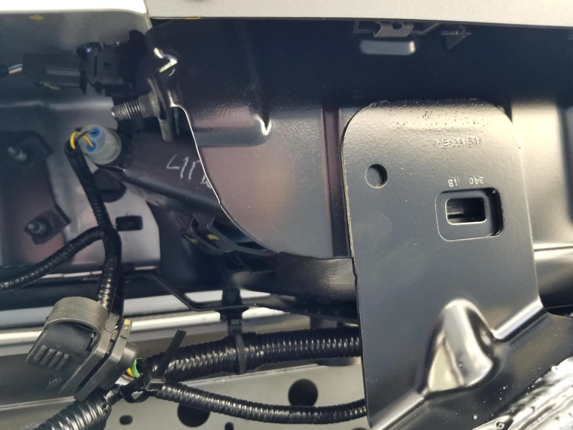

You more than likely have the 4 pin. It was installed on the truck from the factory, it would have been under the bumper just left of center. When they put the new receiver on, the wire is too short to clear the added girth, so it's probably hanging just behind the bumper. Someone posted a pic further up. That is where mine is now, and I am towing just connecting it there (I only need 4 pin for now).
The wire harness needed is on backorder. There is nothing "being created or tested" they just don't have enough stock. Wire harness is super easy to pop in. You also need the "outlet sleeve", the black cover you see on the bumper, that part is available (I already installed it) just cut the outline imprinted on the bumper with a utility knife and snap it in.

I noticed in the other thread you have a pic of the outlet outline. You cut on that outline (thin plastic) and the outlet pops in and clips to the metal frame behind it that is already there (it's part of the receiver they installed).
The 4 wire connector will be behind that point, it was mounted under the bumper. You can still use it, it's just inconvenient to dig under bumper to connect.
There is a connector under the bumper that the 4 pin connects to. It's about 4ft of wire in total. You disconnect the harness and replace it with one that plugs into the back of the 7 pin. There are a few other "snap on connections" on the harness, 4 for backup sensors and 2 for license plate lights. There are 8 snap connections in total, all reachable without removing the bumper.

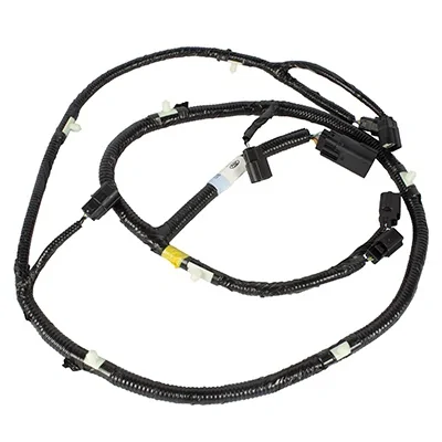

Here's a picture of roughly what the 2 parts you need look like (not exact part numbers). No tools required.

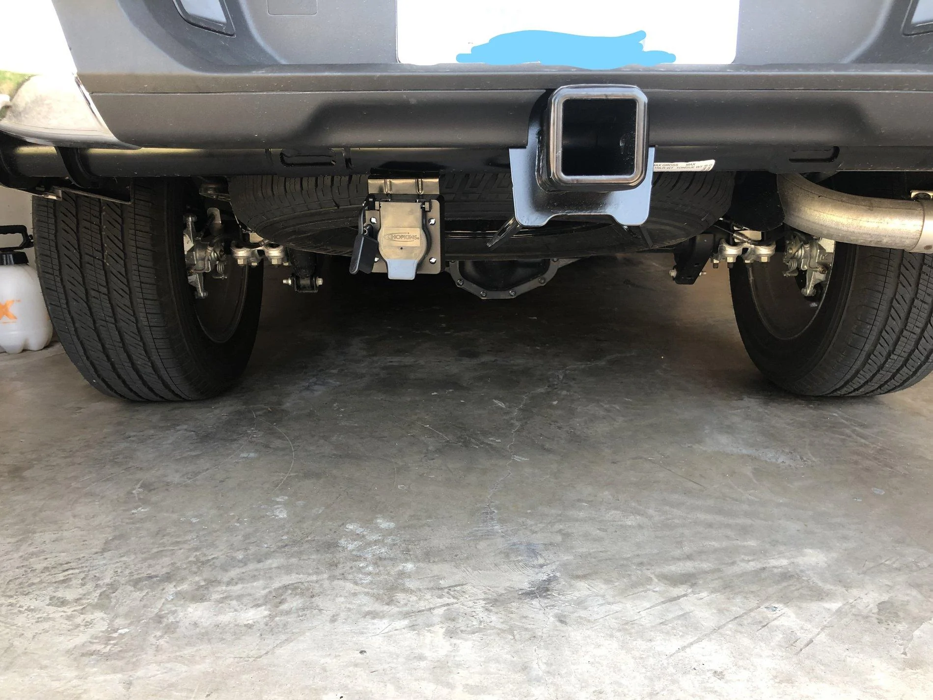

So, went back to the dealer this afternoon and they did finish the job. The dealership sent it out to an aftermarket company that does all sorts of custom work--lift kits, bumpers, performance mods, and of course trailer hitches and wiring. Took less than an hour including 5 minute drive each way. It's amazing what competent folks can do.
They installed an aftermarket 4 pin and 7 pin connector under the bumper and screwed it into the receiver hitch, The dealership is sticking with their line that "only Ford can install the wiring on the bumper." I'm tired of working with them, so I took it immediately to a H-Haul dealer and the let me test it by hooking up to a trailer with a 4 pin connector. Trust but verify. Everything worked fine. I will probably never tow a trailer big enough for a brake controller or 7 pin connector. But, its there if I need it.
Photo below--and no, the connectors are not attached to the spare tire, but it does look like that from the angle I took the photo. :LOL::LOL::LOL:
