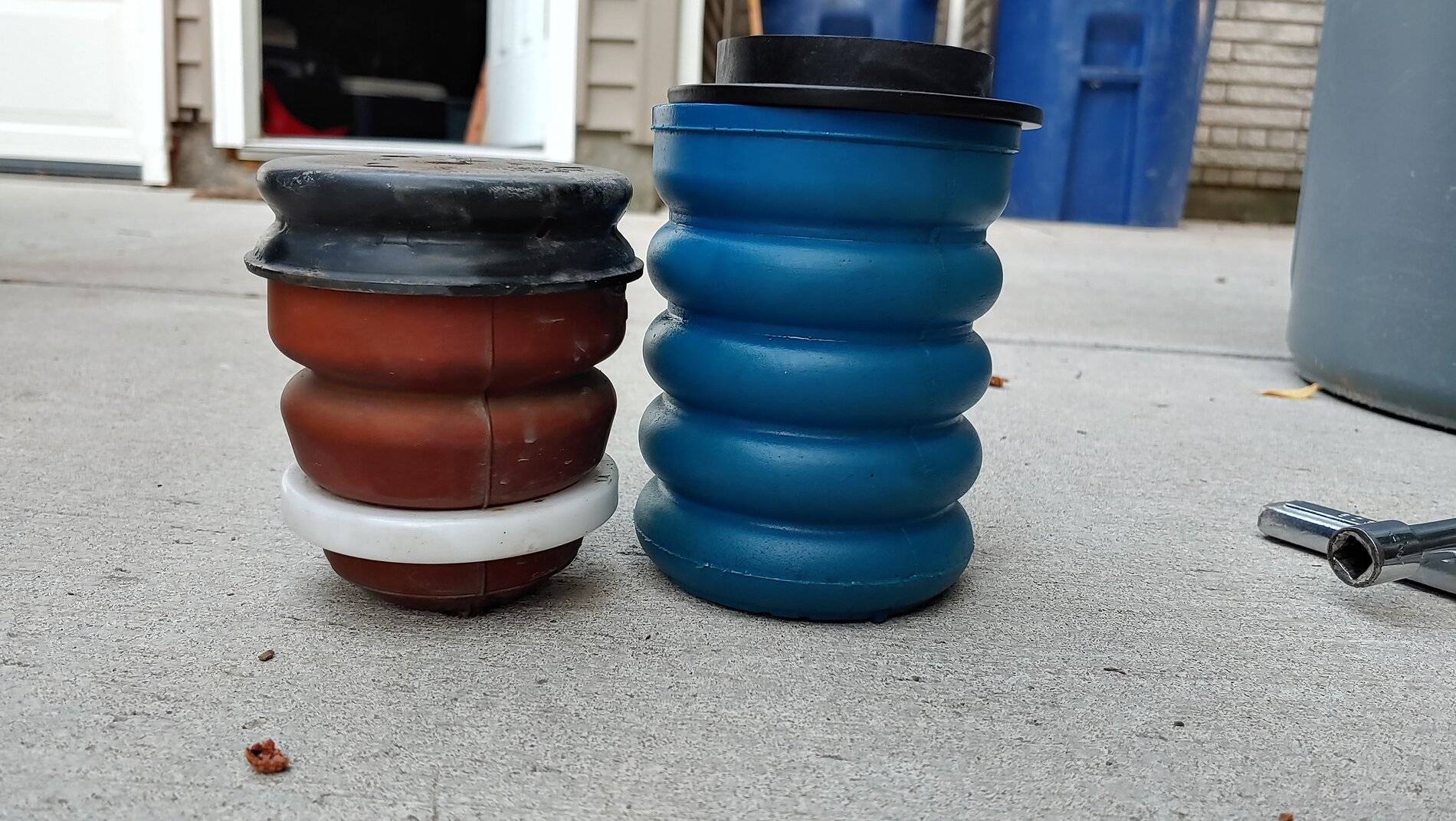

Edit: found this image of the factory bumpstop next to the Sumo
https://www.ranger5g.com/forum/threads/sumo-springs.7751/post-150933

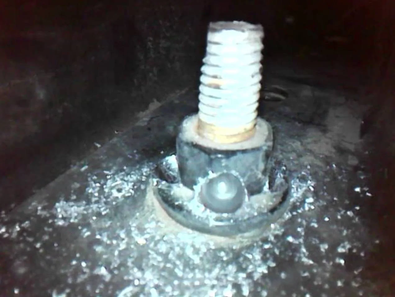

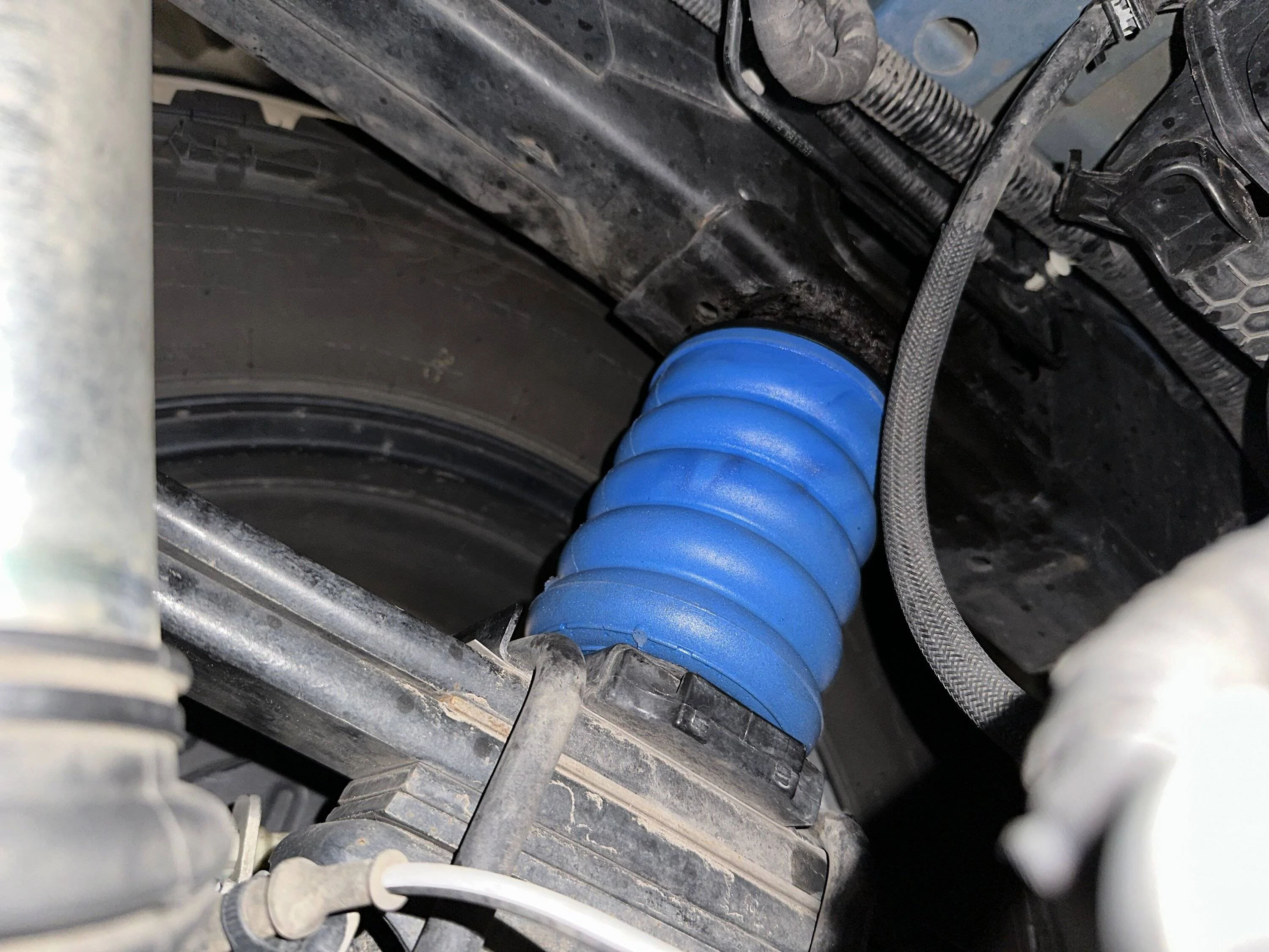

We got the job done - carbide burrs for the win on the side where we broke the bolt! Unfortunately, after breaking the bolt we started with a pretty small drill bit to hopefully get an easy - out in... but broke the drill bit after getting about 1/2" into the bolt. And, of course we broke the bit off flush right at the base of the broken bolt. Thus began 2 evenings worth of work with increasingly more aggressive attempts to get that bolt out of there no matter what. Eventually we were able to grind enough of the bolt away with a combination of other drill bits, carbide burrs, and cuss words that we could drill up at a sharp angle through the sides of the factory welded-in nut inside the frame. Once we punched some holes in the nut, we widened them with carbide burs until it finally popped free under the force of a pneumatic hammer.
Here are a few pictures of the carnage:
After hours of drilling and numerous ruined bits, we finally punched through the walls of the nut.

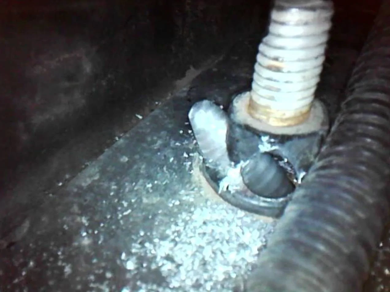

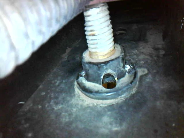

Then we widened those holes with a carbide burr:
And finally popped it free with a pneumatic hammer:
Then just had to wiggle it around with a wrench to get it to break completely free:
On the other side I spent 10 minutes heating up the bolt, then we just cracked it loose, then tightened it back up again. Then cracked it again (it went further this time), then tightened it back up again. Did this back-and-forth procedure 4-5 times and then the bolt just came right out with minimal fuss. The longest part of putting the spring in on the second side was waiting for the frame to cool enough that we could install the second spring.
I don't care what anyone else says... if I'm EVER going to take out a bolt that has been installed into a captive nut in the frame, out comes the torch before any wrench.

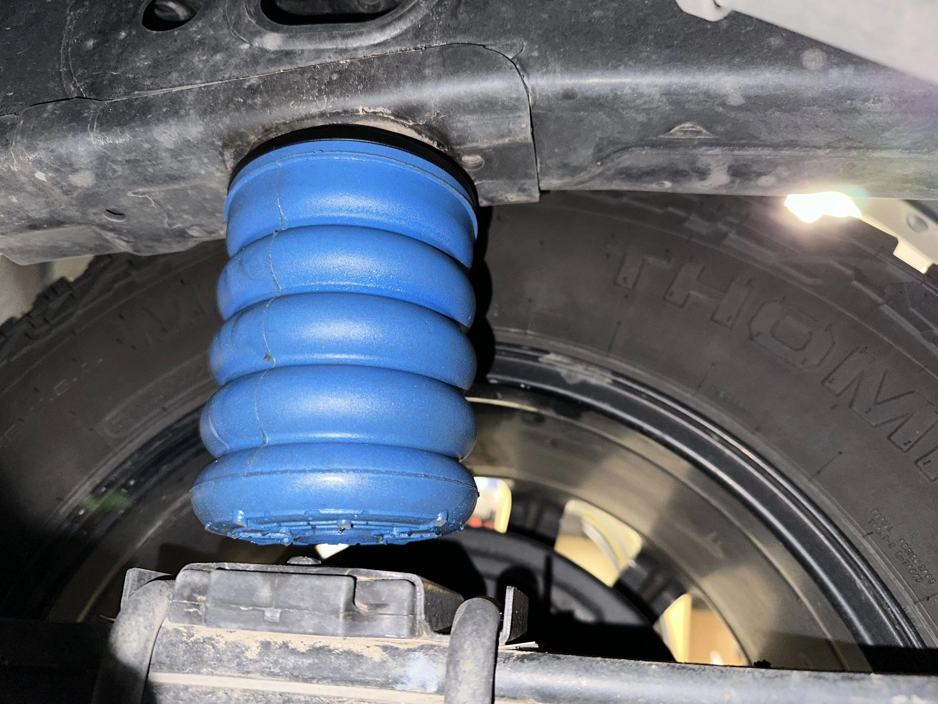

Finished shots of the installed springs:
