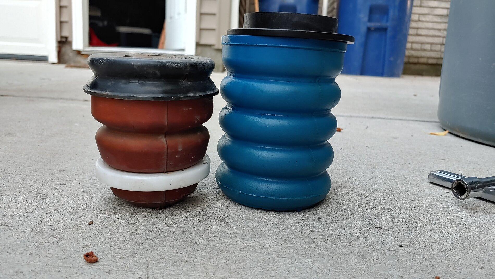

I decided to be the test mule for this, as I could find any real world experience with these.
I ordered the blue Sumo springs, the lightest ones, I just installed them on my FX4 that has a bed cap on it. You’re basically on the sumo spring all the time, and the factory shocks have a hard time keeping up with them. Perfect candidate for upgrade springs. All this experience is unloaded, I’m hauling my camper this weekend, so I’ll update after that.

After towing my 3500lbs camper a few hours on the highway with the SumoSprings, I can say I’m really happy with them. I have always used a WD hitch when towing, but the SumoSprings made a huge difference, a lot of the floating sensation is gone, along with the wiggle from the rear. The FX4 shocks still have a hard time keeping up though.
While unloaded, the body roll is significantly reduced as well, but it’s still pretty stiff over speed bumps and our terrible roads where I live. I’m going to try to remove the small spacer that was provided with the springs to help give a bit more up travel before the SumoSprings come in contact with the leaf springs.

So I would agree that the sumo springs helped out. Couldnt resist with free shipping, no tax and 10% off. But I would say the eibach rear shocks were the single biggest improvement. I also removed the spacer as they engage too early unloaded. Actually that spacer on the factory bump stops and a longer bolt may have achieved a similar result and I woulda had enough left over to take the wife out to dinner.

I’d recommend putting the spacer back in, they’re there to make sure the sumo spring sits flat. The frame as small protrusions that prevent the large metal washer from sitting flat.
i actually ended up cutting the first rib of the sumo spring off. This allows the leaf spring some more movement, unloaded, allowing for a softer ride. huge improvement on ride quality doing this.

I bought the Sumo Springs also. The Blue one is the lowest duty one (1000 Lbs), the black one medium (1500 Lbs) and then the yellow heavy duty one (2000 Lbs).
I have the black one. I don't have my truck yet from Ford (back order....), but contacted Sumo Spring after reading this Thread. I was concerned about stiffness!
They told me you can safely remove the spacer (1/2" thick one), but keep the washer.
You can also cut the lower bump off if you want, but this mod voids the warranty.
I have a heavy RV to tow once the truck arrives (5,300 Lbs), why I bought this in the first place.
I will post what I end up doing with the Spring once I finally get my rig.......
