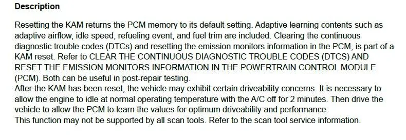

As mentioned above (TIME) is the key factor.
Note there is NOT a detailed document as to how long - KAM will retain its memory with a battery disconnect.
Most general time frame = 15 minutes to 1 hour
Note: Adaptive Learning (INCLUDEDS) the transmissions tables.
My curiosity on this question had me attempt to find exact answers to this as well as finding out how long the battery had to be disconnected to drop all the Sync (Memory) Presets etc.
Never found a definitive answer.
Being that the - ONLY noted item that must be reset with a battery disconnect is the - One Touch Window (Control) - That requires human interaction. That switch is always powered via the BCM
Note: KAM is not completely wiped, the KAM reset only resets the LEARNED values (adjusted values) from stock default base values which will never be wiped unless you are tuning / reprogramming the PCM.
The only KAM reset - human interaction would be for the Idle Air Control (Learn) to aid in a fast learn of idle control. The rest is automatic and learns as you drive.
The various drive monitors (On-Borad) test cycles will also relearn when the conditions are met for them to run.
So, if simply replacing the battery (normal) time frame under 15 minutes the KAM should retain and the only thing you will need to do is the - One Touch Window (Reset) from the information (or lack of information) I can find in the manuals.
Sorry but there is no clear & precise answer to the question from the service manuals on this.
Note even the service manuals use the word (MAY)
