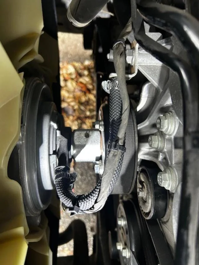

Well, I had a day.
While working on my daughters' boyfriends 2019 Ranger XLT, guess what I found.
A nice little broken hose, I played with it some as I wanted to compare his vs mine.
I noted allot of slop in the module as compared to mine.
Well, I ended up grabbing some extra 3/8 HP Fuel Line I had in my spare line box and added (2) clamps.
OEM Hose was deteriorated pretty badly and crumbled in my hand.
So, we can add another failure of the hose to the list.
I will have him monitor it.

Well, I had a day.

To bad you couldn't wire in some kind of break away connector so if it fails it won't destroy the harness.

My 19 just turned 38,000. Doing some under hood checks the other day I gave special notice to this hose
Mine appears to be good as new, no signs of cracks or being brittle. Makes you wonder why some are bad & some are not. ?
