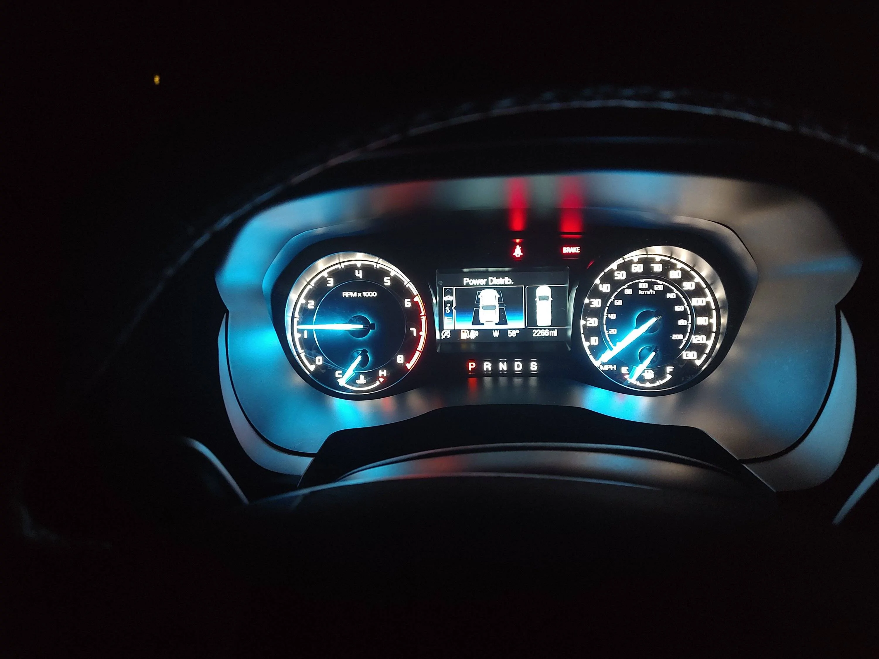

BTW check out the dash board instrument panel. Layout is different then my 2022.

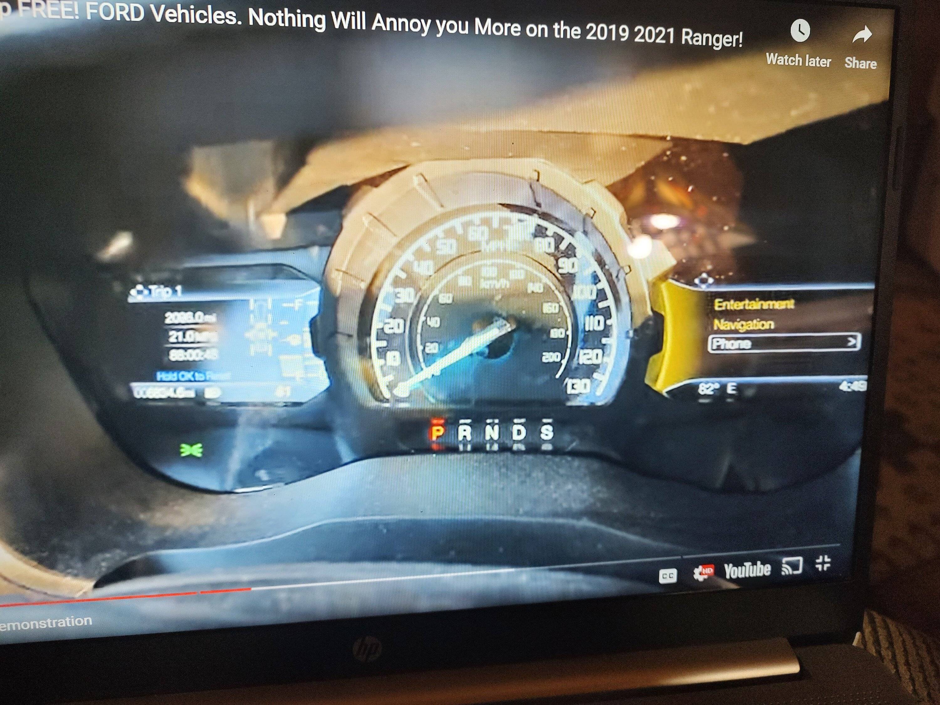

Check out the difference in dash panel cluster.
In the clip 2020:

Anyone else have the dash cluster like the clip?
Looks like the standard XLT cluster to me. Just has the power dist screen up in the middle.
Kevin,
I think the Ranger in the video is a Lariat - different cluster than our XLTs. Also, unclipping the terminal affects the Battery Management (or is it Maintenance?) System (BMS). Is it harmful? I don’t know but really, really smart engineers, like Phil, designed and tested the heck out of it for a reason.
