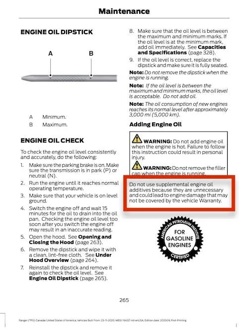

Ford says no, too.
edit: @OrangeStreak already pointed this out- didn't see it until now
