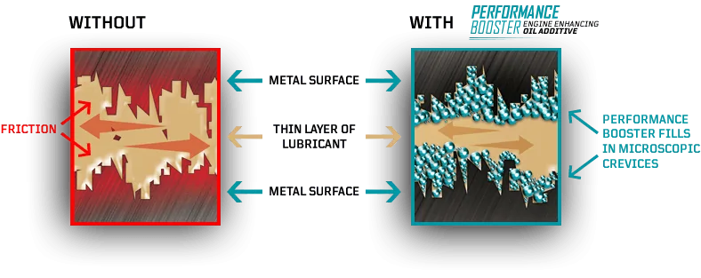

Can someone with some experience or science knowledge tell me about this product and the claims they make?
https://www.shinearmor.com/collecti...booster-oil-additive-1?variant=29406697685078
Our Performance Booster Oil additive is a cutting-edge, nanoparticle-based solution that works great for gas and diesel engines alike. It boosts the performance and lifetime of any oil-lubricated system under the hood, aside from the air conditioning unit.
Our clients have been stoked about this product because you really can tell the difference in your engine after using it. Our booster oil pumps up your horsepower and extends the durability of your entire engine.
Did we mention it’s eco-friendly? We made sure not to use any harmful chemicals that would damage your vehicle or the environment, so you can rest easy knowing your car is about to get a jump start to its energy.
Use Performance Booster Oil Additive after getting a fresh oil change, or use it on the oil that you have now. Doesn’t matter if you use conventional or synthetic oil blends either; we got you covered.
Our advanced formula works its way through your engine system’s microscopic crevices to reduce the wear and tear the years have put on it. It can even reverse existing engine wear.
We’re so proud of this product and know it’s going to change the way you drive that we offer a 100% money-back guarantee. If you aren’t satisfied with the boost in performance, just send it back and get a full refund.
  • Safe & easy to use
  • Increase Horsepower and Torque
  • Works in almost every type of vehicle
  • Quieter Engine, Reducing Noise and Vibration
  • Stops Cold Start Problems (Tested to -40 Deg.)*
    Increase Fuel Economy up to 4.2%*
It all sounds oddly too good to be true but I really don't know much about cars and the science behind things nor how far technology has come along. Also would it be safe in our engines you think?

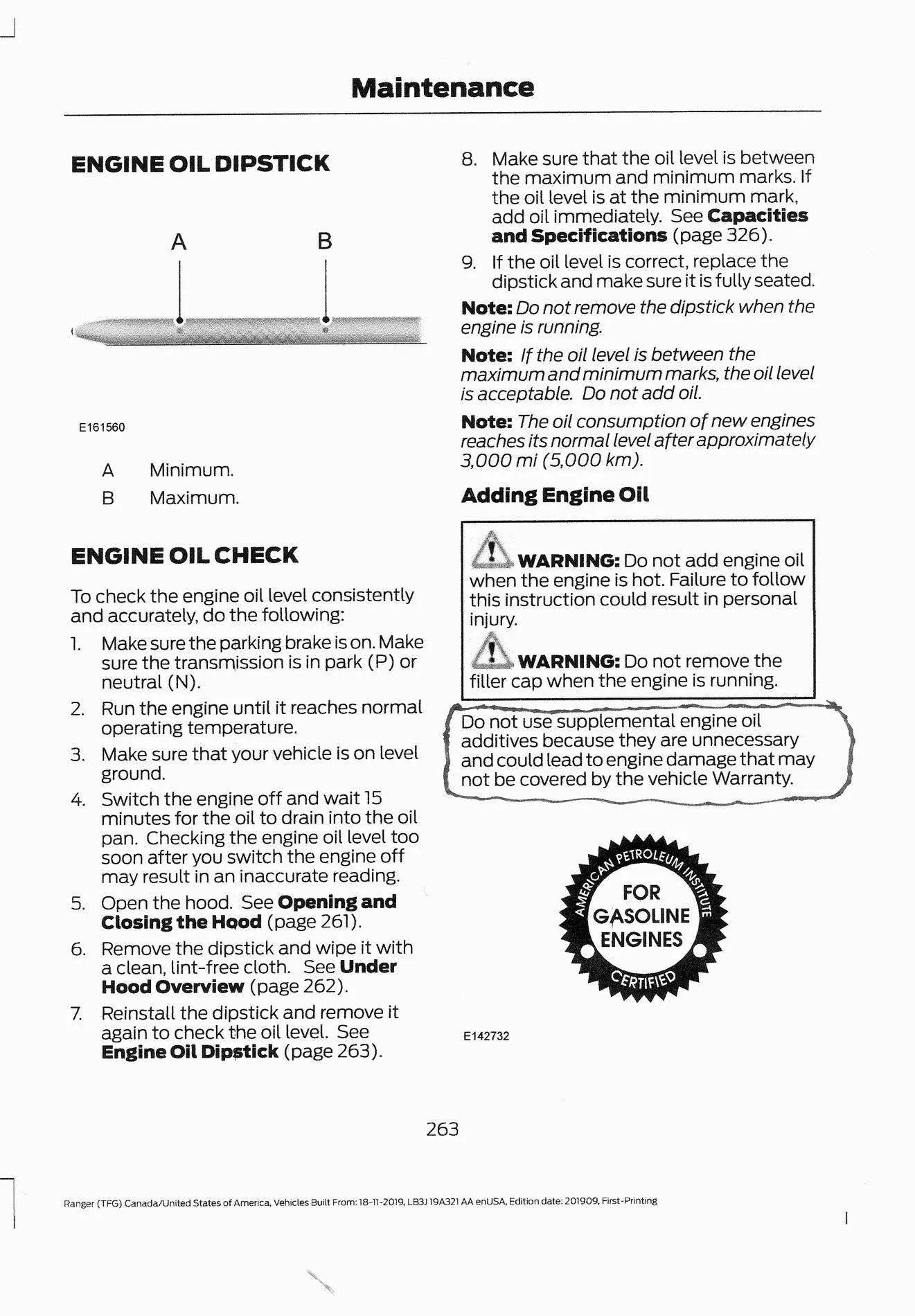

To answer your question: YES
Also(from the Owner's Manual)(I added the bold font):
We recommend Motorcraft® motor oil for
your vehicle. If Motorcraft® oil is not
available, use motor oils of the
recommended viscosity grade that meet
API SN PLUS requirements and display the
API Certification Mark for gasoline engines.
Do not use supplemental engine oil
additives because they are unnecessary
and could lead to engine damage that your
vehicle warranty does not cover.

Most people want to get protection and as much longivity out of their vehicles as possible. My view is not scientific but practical. I don't feel that it is a good idea to add anything to the oil. Quality oil is designed for modern vehicles to give the maxmum lubrication and protection as long as it is changed at substancial intervals. See Edmunds video below which shows how to choose the right oil and also mentions needed additives that are already included in oil that is retailed. I believe that Ford's advice about additives on p. 263 of the owners manual is correct and the safest route...
