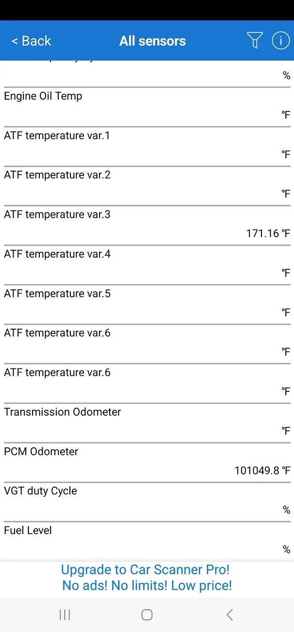

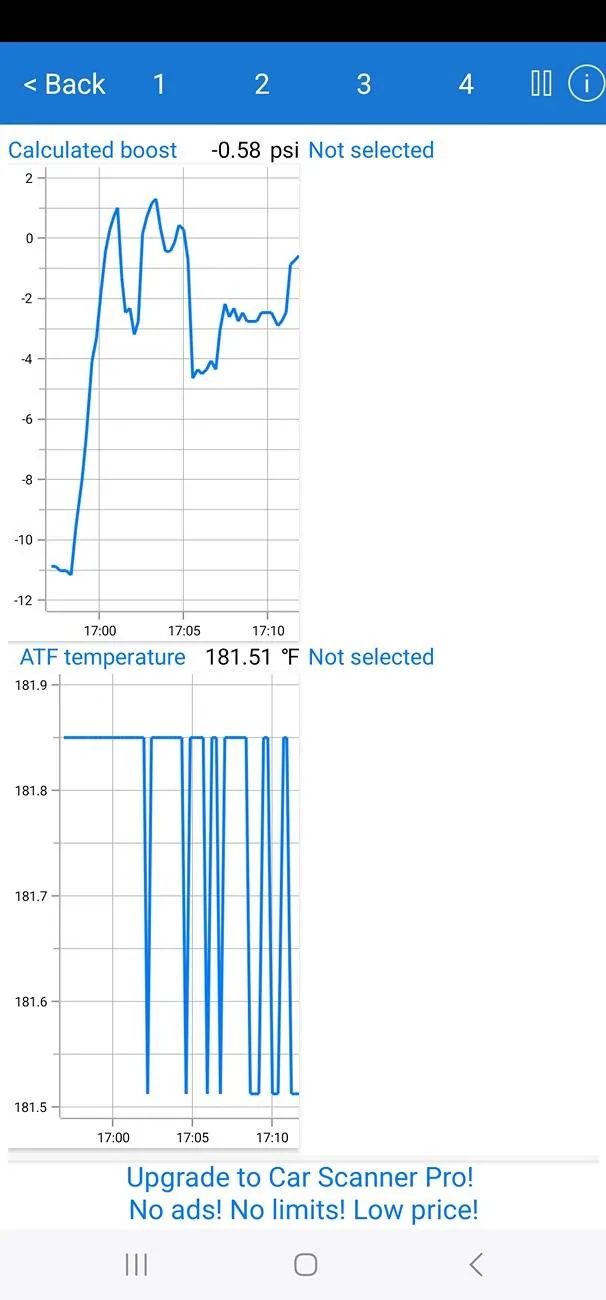

If anyone wants a super cheap way to monitor temps I just got a cheap ob2 dongle and use a free ap.
I bought a $30 Veepeak OBD 2 Bluetooth and the free ap from carscanner.info.
Can see my transmission temperature live and even chart it. I think most would be surprised how long it takes to warm it up. It seems to run around 170-180 mostly here in New England in where it's been cold. Will have to see what temps it runs as it warms up. It also displays a ton of other data.
Boy, that PCM odometer is HOT!
