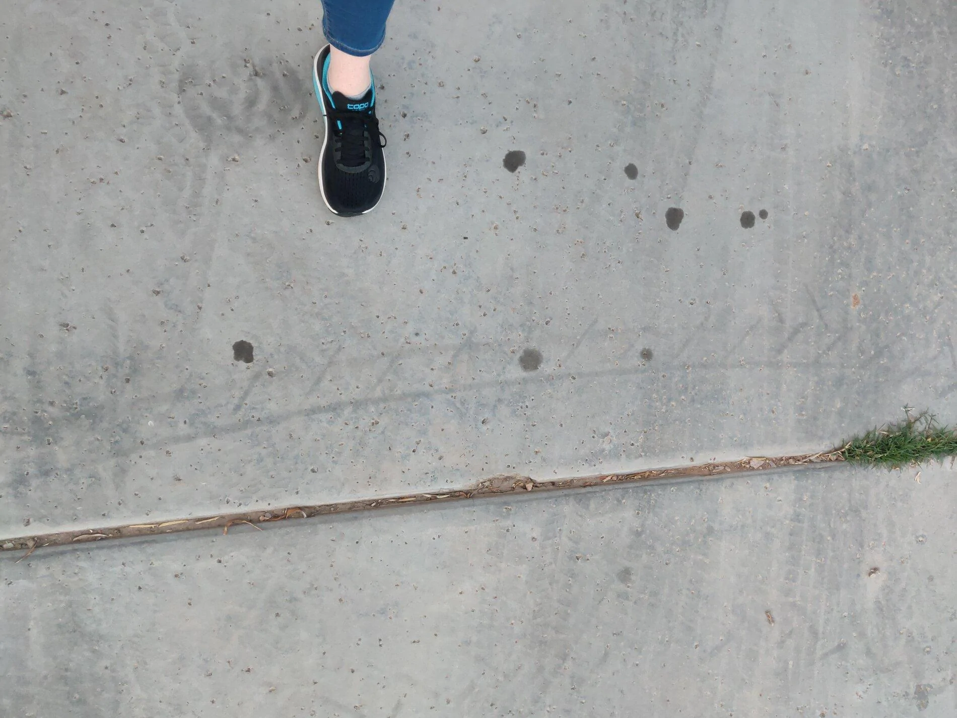

900 miles in and Jolene ('21 Tremor) is at the dealership for a transmission fluid leak. It was not a small amount of fluid either. I crawled under the truck and was sick to my stomach at the amount of fluid on the undercarriage. The pic shows the fluid after sitting for around an hour. I hope my local dealer can get her fixed up. I'll keep you posted.

thats probably just a little excess vented out
That's what I'm hoping. I cleaned up more in the garage and used a towel to clean up a ton on the undercarriage.

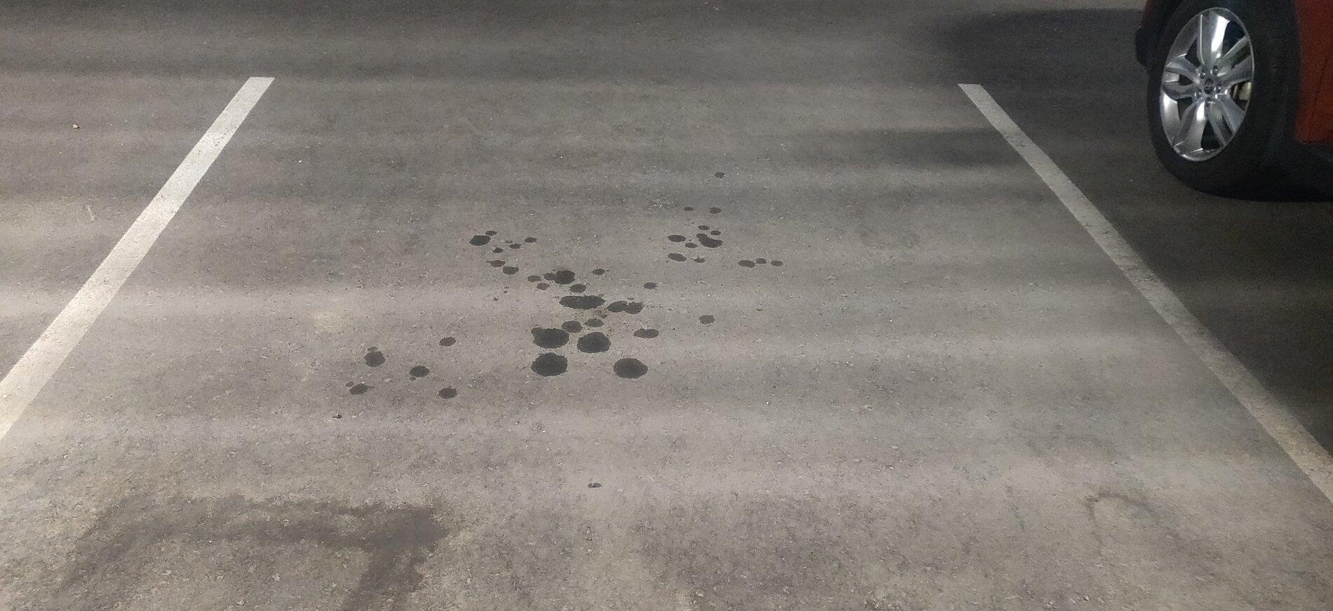

I looked at the spot that I was parking in at work. That's quite a bit of tranny fluid. The truck is still at the dealership. Hopefully they can look at it tomorrow. Until then, I'm in a 2wd Ranger XLT. I want my Tremor back!
