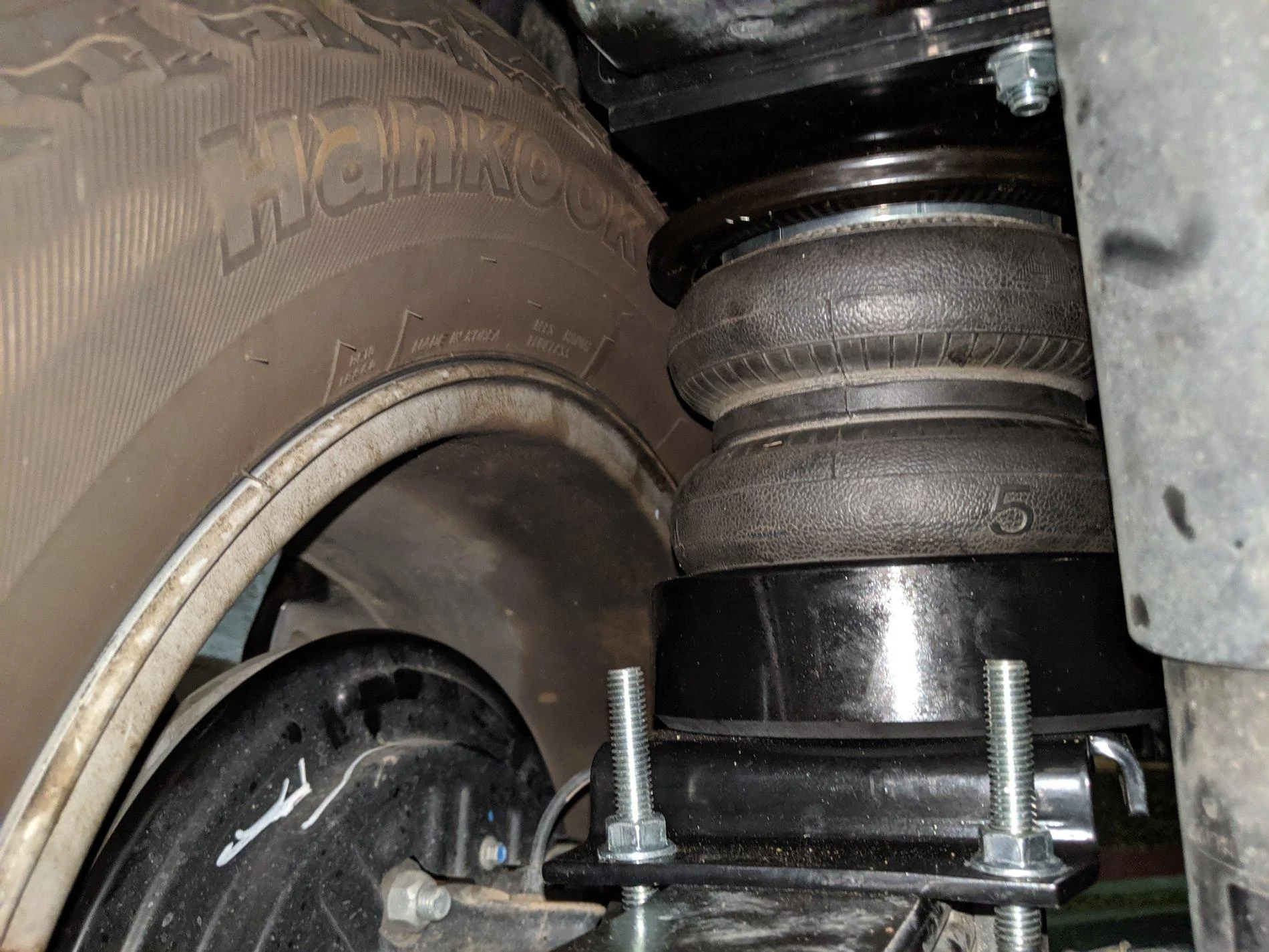

Alright so I got them installed. It was very hot and took about 4 hours so don't have alot of pics. Overall pleased with the result. With no load I can raise it about 3.5 inches. The bags can go from 0-100 psi.
Near stock suspension feel, since the ultimate edition has an internal Jounce bumper, the bags can be ran at zero psi. Only noticeable on speed bumps. On the road it feels the relatively the same. I would say if it was a 9 for me on ride quality it is now an 8. However when talking about sway or side to side rocking motion, it is much improved ex.- going in and out of a driveway or a right turn.

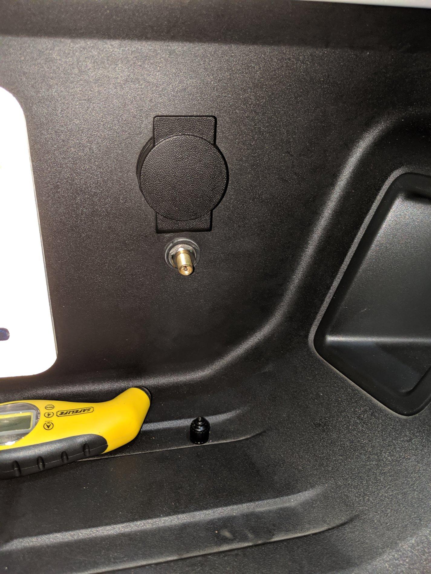

I am happy I purchased the "tee," in the below pic you can see the spot I chose to mount the single fill location.
The other pic shows the completed assembly with the cradle allowing the bag to separate from the leaf spring so no articulation is lost. This required some adjusting by compressing and decompressing the suspension a couple of times to get the bag to seat right in the cradle (the air lift brackets allow for adjustability).

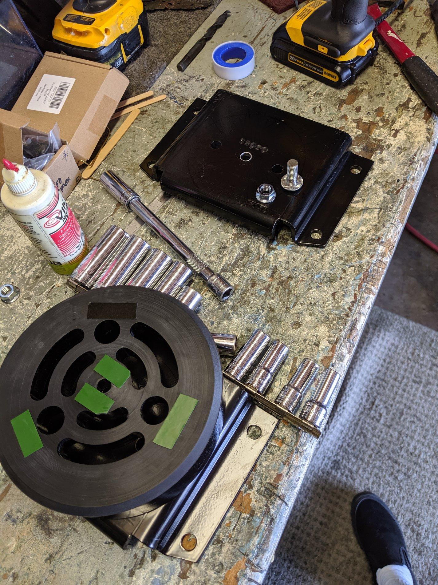

The final pic shows how the air lift bracket had to be modified by drilling a hole. I also had to purchase slimmer hardware from home Depot to get the setup to work. I also added some double sided rubber automotive tape on the backside of the cradle to keep it from rubbing or spinning on the bracket.

One thing I did the last time was run both fill valves in the drivers side wheel well. It worked very well and was convient for last minute fills in a gas station.

Yup its a universal cradle by Daystar so you will need to modify the Air-Lift bracket by drilling a hole, and I had to use different hardware than was supplied with the cradle (slimmer hardware) to secure it
