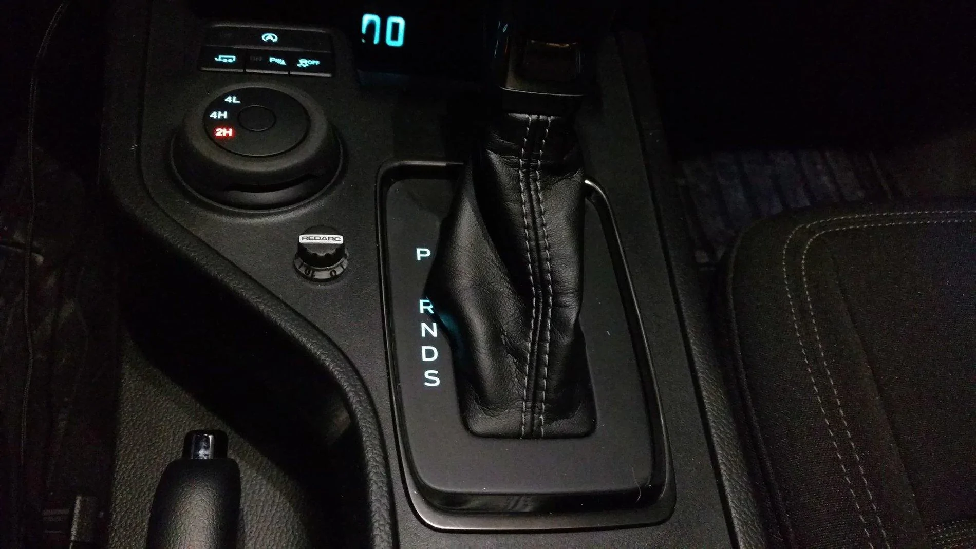

I tested the REDARC over the weekend and it worked extremely well. It was the best performance I have seen out of an after market brake controller.

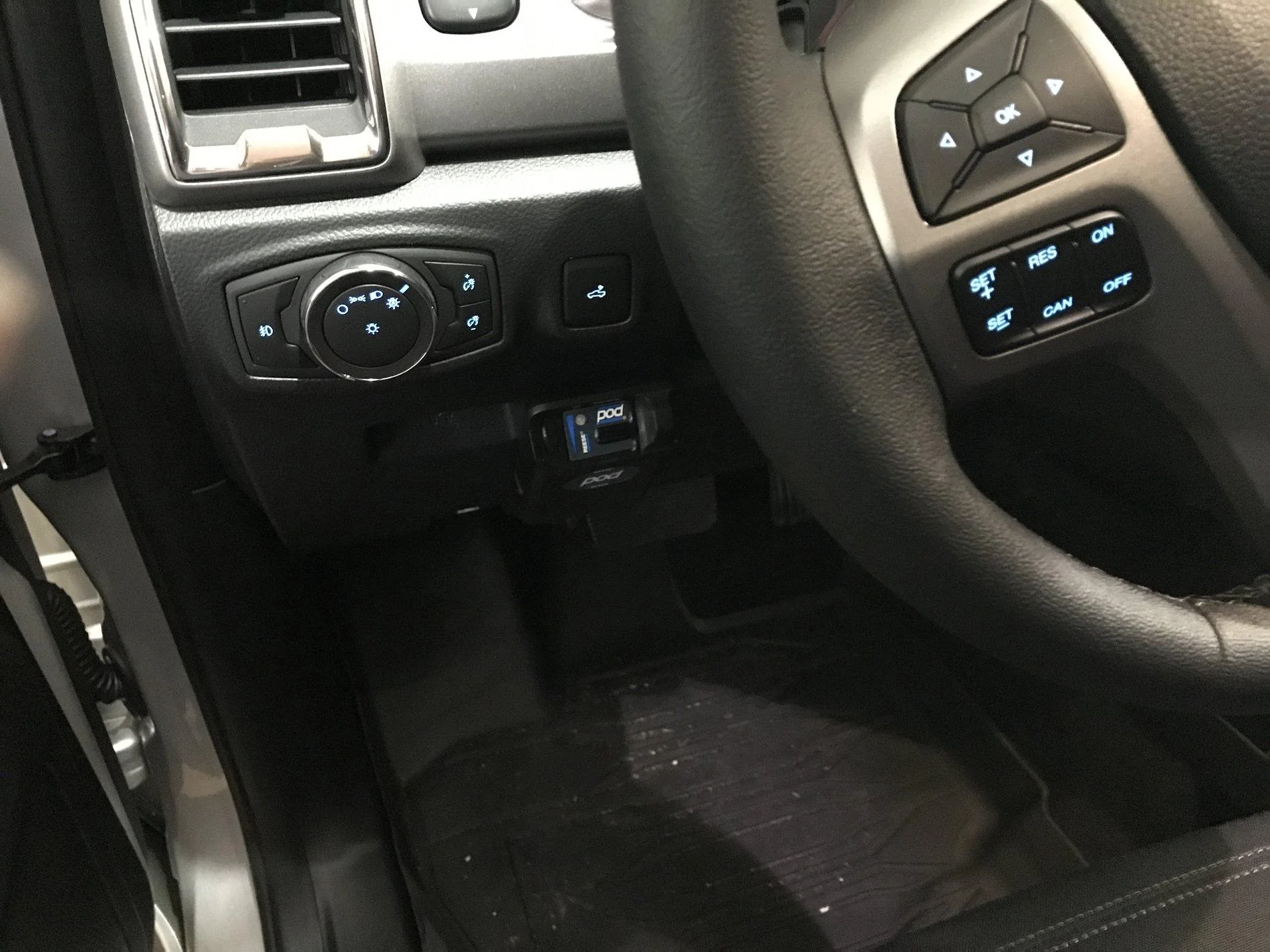

2019 Ford Ranger, 2018 F-150

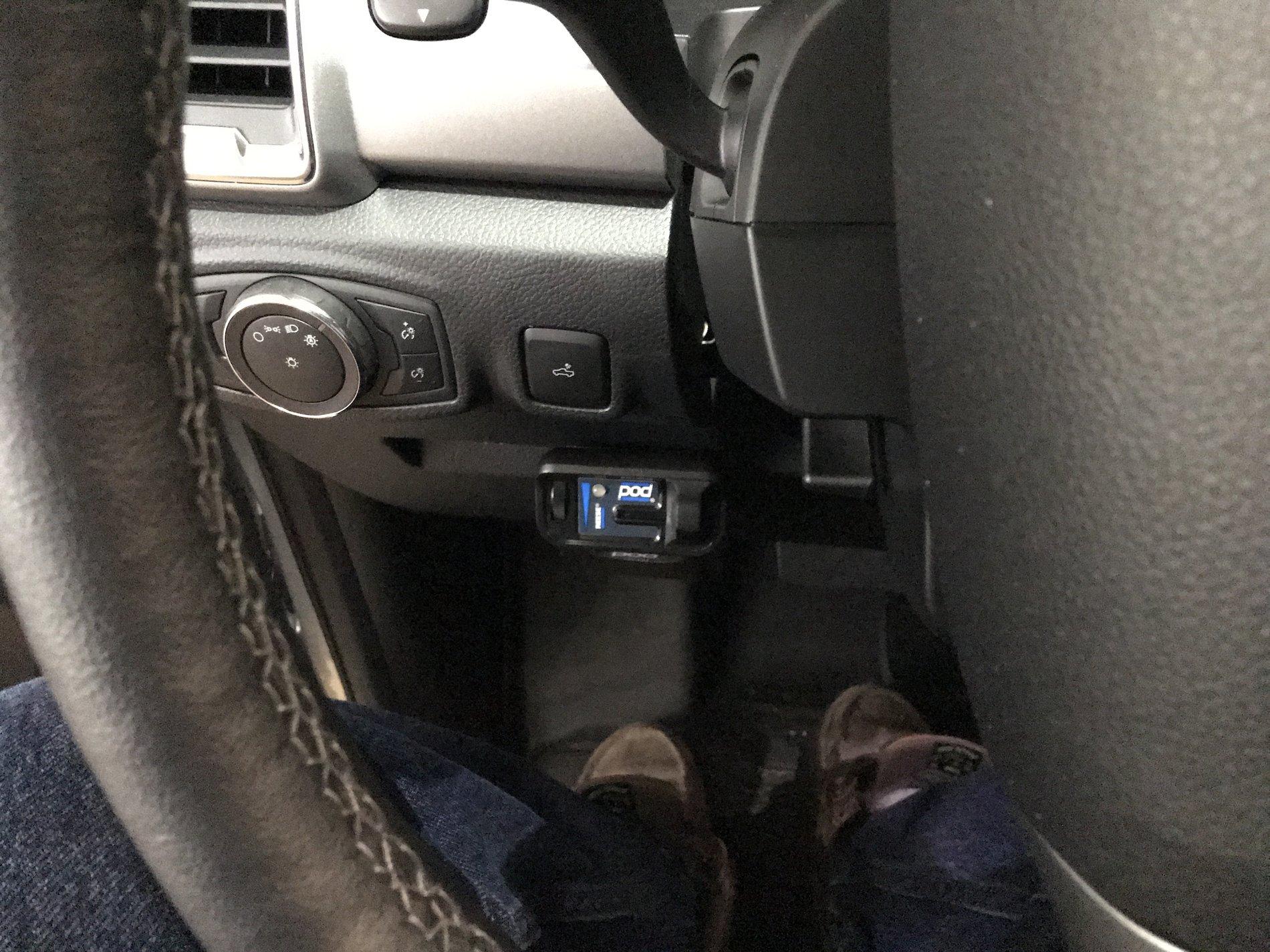

Tested two different Tekonsha controllers. From the pricier Tekonsha P3 all the way down to the $35 Pod time delay model. They work flawlessly. This confirms what Tekonsha tech support stated, basically quoting, "There's nothing unique about the new Ranger. It is an industry standard 4 wire system. Any and all of our brake controllers will work." Tekonsha is now part of a larger corporate group, Horizon Global, that contains Reese brand, Hidden Hitch, Draw Time, Pro Series, etc. Any and all will also work. There are literally dozens of brake controllers sold under these brands and all will work.
https://www.horizonglobal.com
ausable
Fred
Nov 19, 2019
64
104
Good location. Out of the way, yet easy access. 3M Command mounts. No bracket, no drilling.

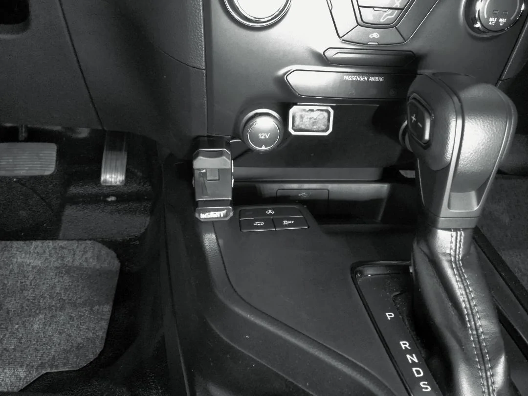

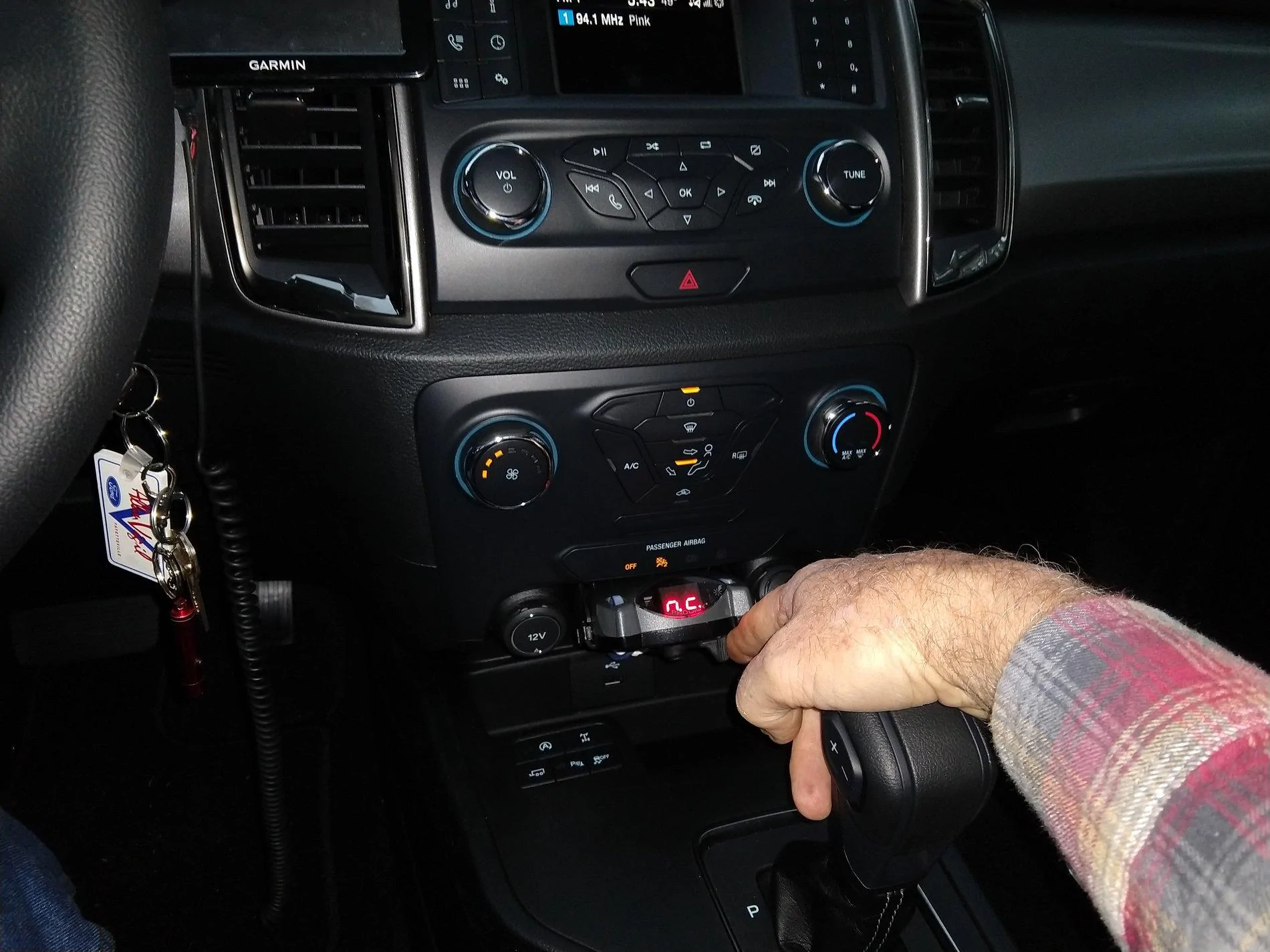

Installed Hopkins Insight Brake controller... confirmed excellent.
Hi Floyd,
Do you have a photo of where you put the readout and the activator in your Ranger?

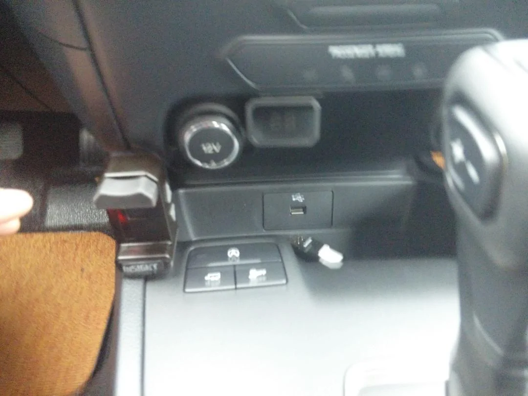

Hi Floyd,
Yes, Great look and excellent locations, but lousy photography...
The readout screen is just to the right of the 12V powerpoint and the control is down and to the left.
It looks straight and almost built in in person, also it is completely accessible without being in the way.
The main unit is mounted just under the dash against the console above and aft of the loud pedal.

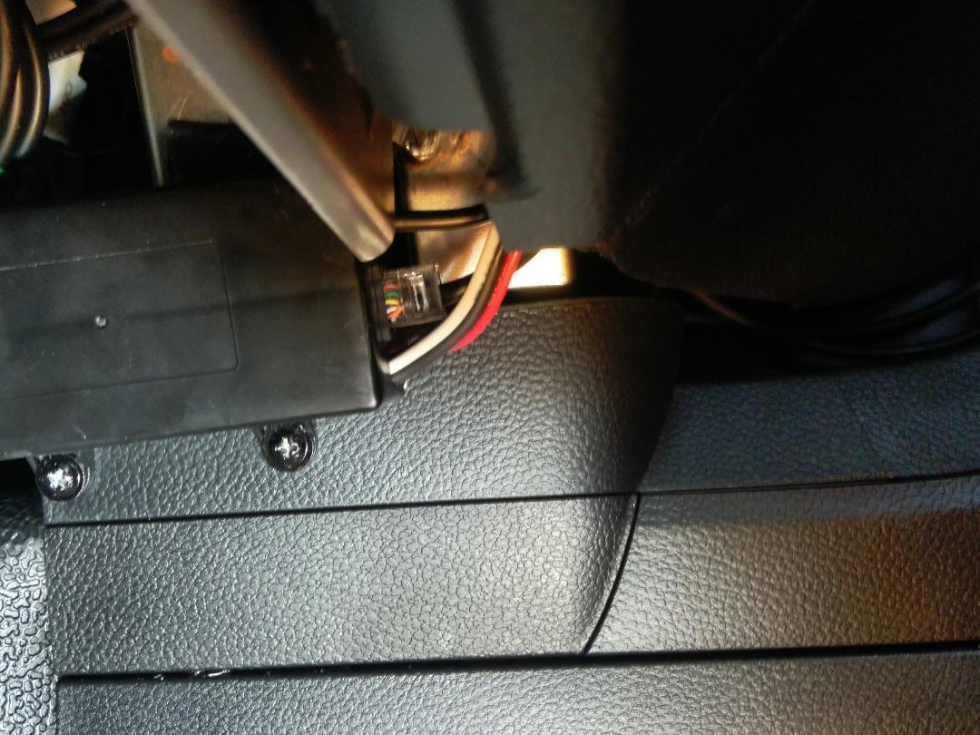

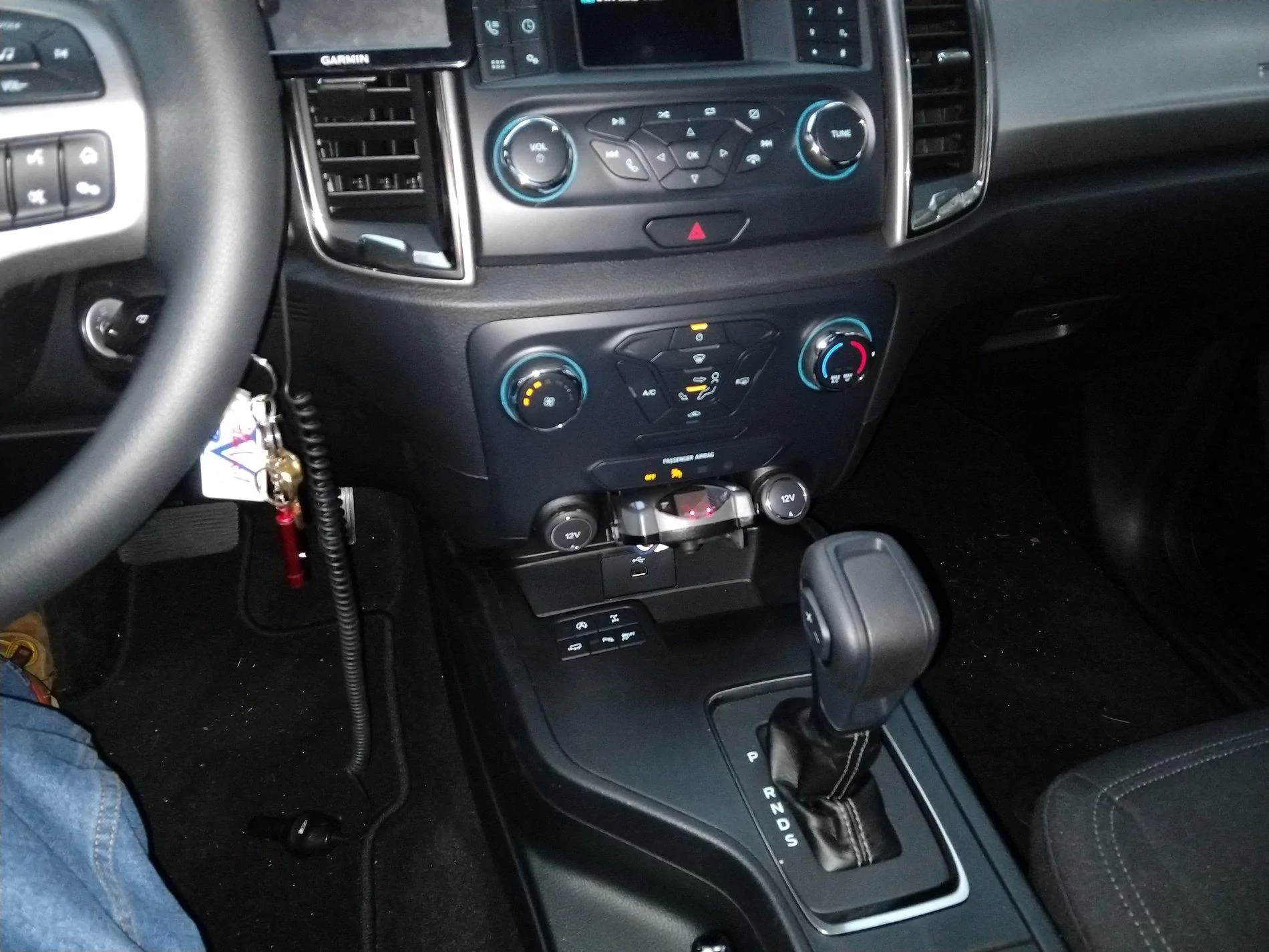

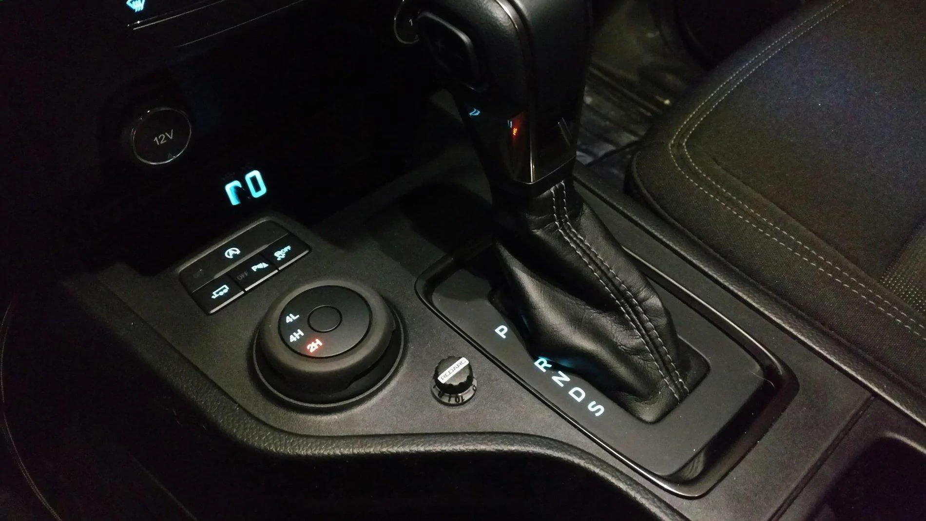

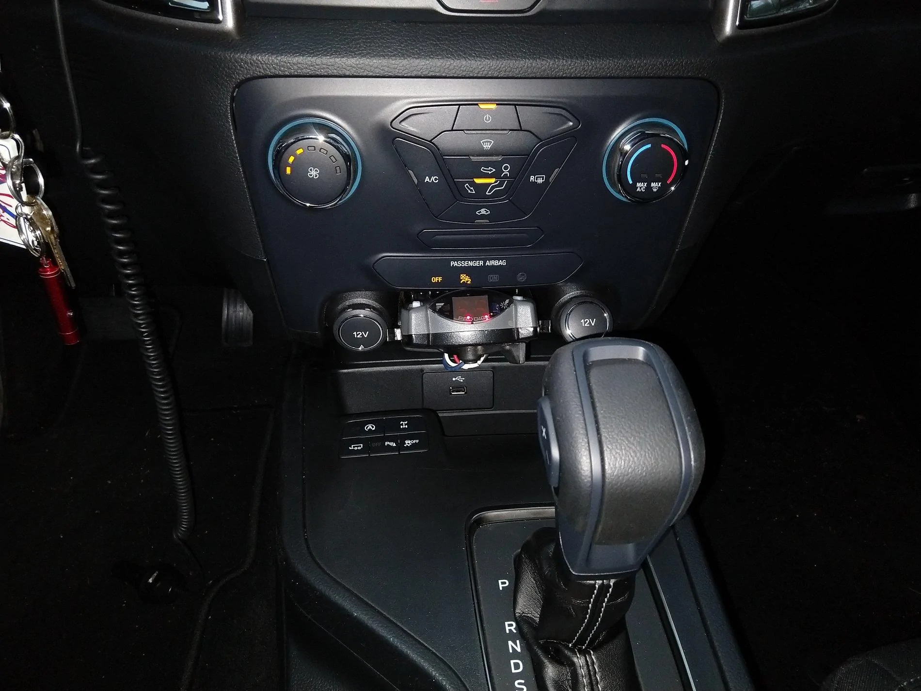

I installed my already owned Tekonsha Prodigy P2 today. I obtained another mounting pocket just like the ones in my other two tow vehicles so I can easily switch the P2 to whichever vehicle I'm currently using.
Hardest part was trying to attach connectors to the Ranger XLT brake control wiring up behind the dashboard, either my old body isn't as flexible as it used to be or vehicles are getting tighter!
I decided the best location for my controller was the space between the two 12 volt outlets. Seems easy to reach and easy to read, and doesn't look too bad either. Mounted the pocket with a stainless steel nut/screw into that panel (I removed the panel to do that and cut off any excess screw to prevent any interference with stuff above the trim panel). Drilled a hole in the panel behind the pocket for the wires, keeping enough slack so I can disconnect the connector when removing the brake controller.
Haven't towed with it yet (still under 1,000 miles) but my Tekonsha 7 pin tester says everything is A-OK.
I really like the looks of the Redarc, and was tempted by the current low price of the Insight ($55 on Amazon), but I already had the P2 so that was an easy choice.

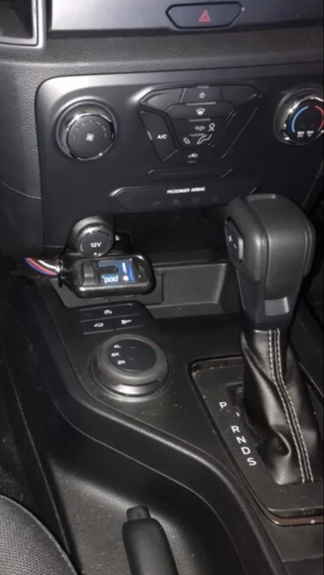

Reese Pod, cheap works great and fitted where I wanted it. Some of your guys installs give me anxiety. Tidy those things up a bit lol

Take a look at the Dorman link it doesn't have the "ears" and is apparently made for aftermarket application.
Having built a bunch of streetrods I don't think it would be a problem, providing the Forscan would work. (probably not)
Actually I could do an escutcheon for the N-Sight and it would look more "built-in" and very much like the F-150 controller.

Really need to have a separate option in the survey for the Ford/Redac system. Many of us put in the Redarc before Ford came out with its "approved" setup because we needed a brake controller.
