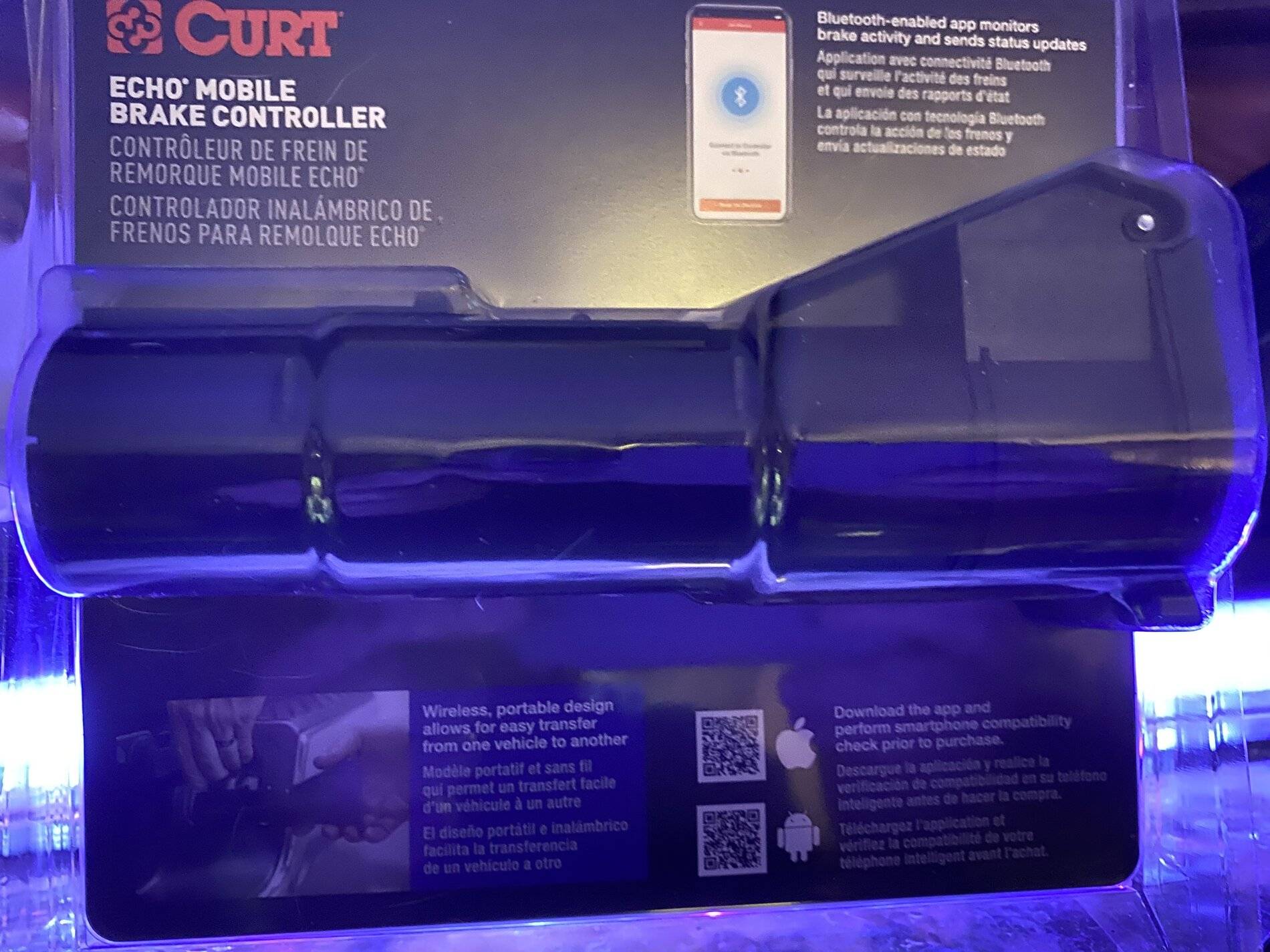

2020FRL
Alan
Jan 23, 2021
410
993
Grand Junction, Colorado
2020 Ford Ranger Lariat, 2014 Harley Tri Glide
I just used the Bluetooth version ... had it on two vehicles (three if you count letting my neighbor borrow it while his was on order), no issues, works well
