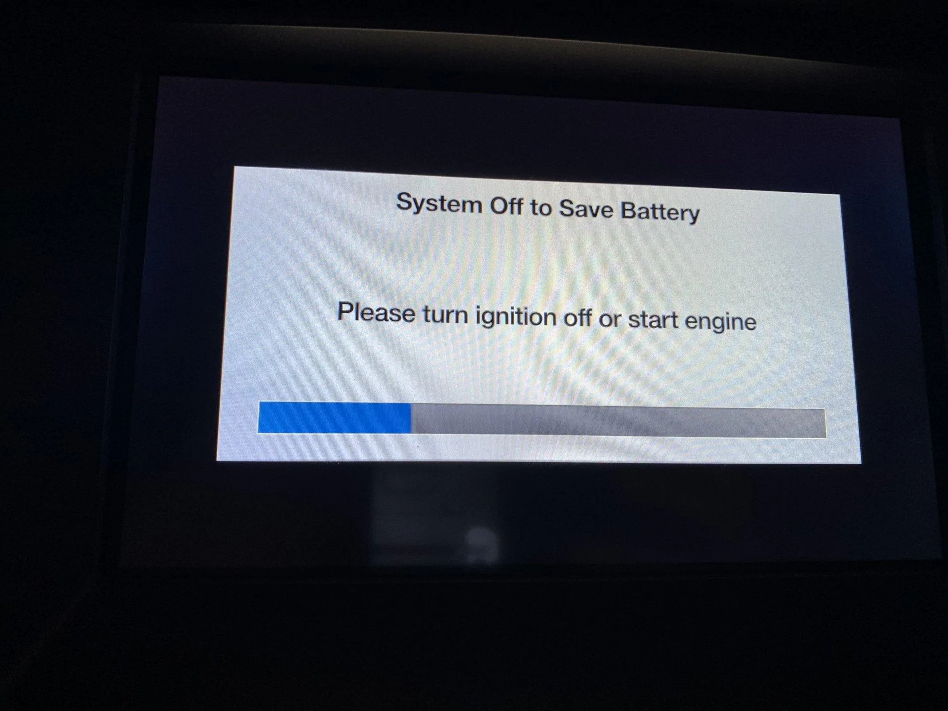

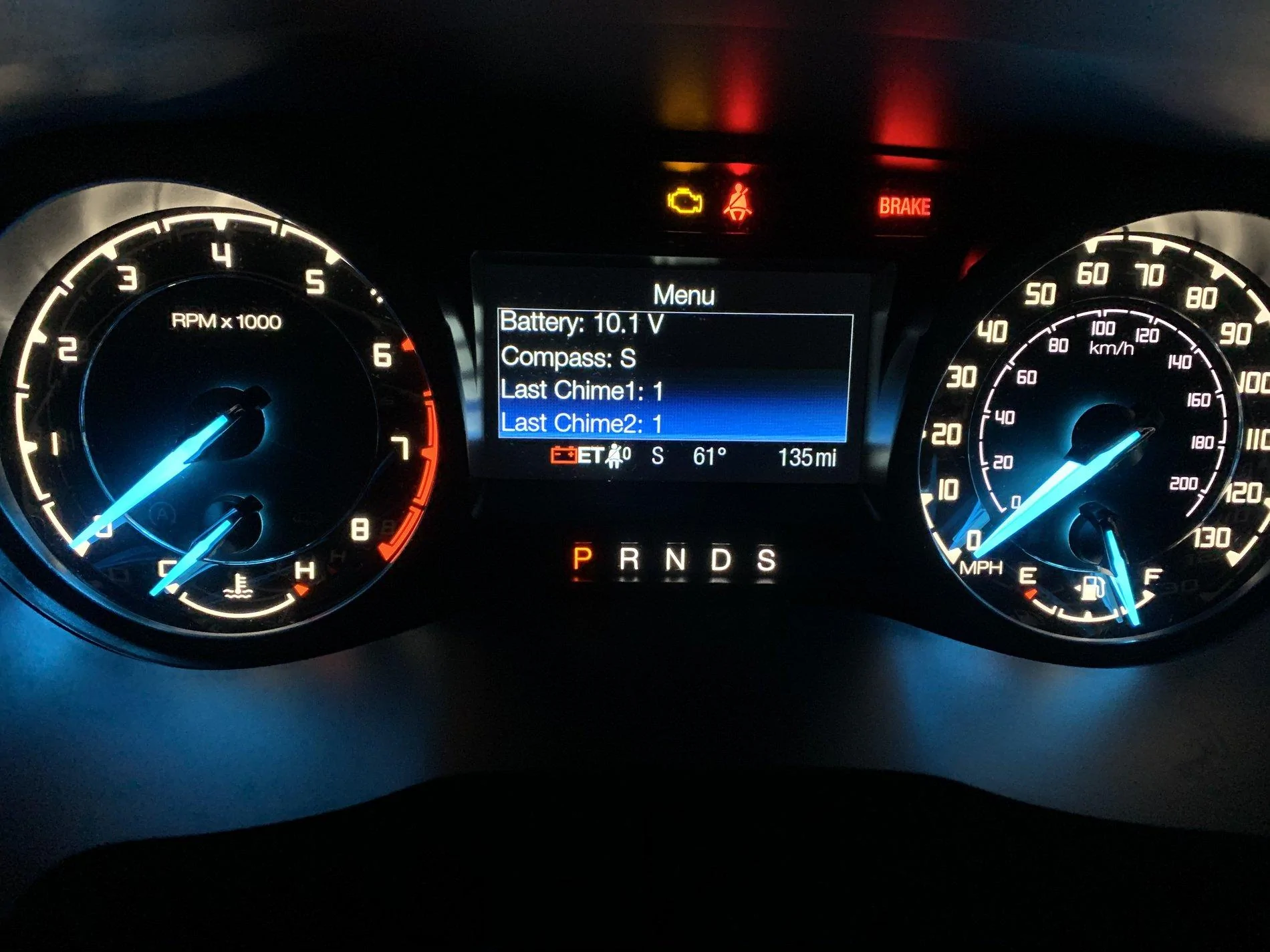

Agh Dead battery after just 3 days
HenryMac
Sep 14, 2019
2,783
5,359
Mech. Engineer - Retired
And how do you know that the battery is bad?
For future reference, if you take the old battery to a reputable parts place, like NAPA, they have diagnostics and can tell you if the battery itself is bad, or it just needs charged.
My perspective is a bit different since we live an hour away from any local dealerships. Napa is a 5 minute drive. For something as simple as a battery, I'll fix it myself to get the truck back on the road.
For us the truck is our primary means of transportation, waiting for the dealership is never the ideal approach, due to being so far away.

Well, i got the truck back. Turns out the battery was bad. They jump started it and checked the charging system and it was fine putting out 14.9 volts. Load tested battery and it failed. They installed their Rotunda charger to test battery, the charger failed the battery. They checked for a parasitic drwa and found none. I'm still a little leary of this due to all the wonderful electronics that the truck has. I'm going to keep an eye on it. One thing I did notice before the battery died was I could not start the truck with Fordpass. At first I was getting messages on Fordpass that they were updating the system. Then I would get vehicle failed to start. I just tested Fordpass now and the truck started. We will see what happens tomorrow when I go to start it before going to work.
