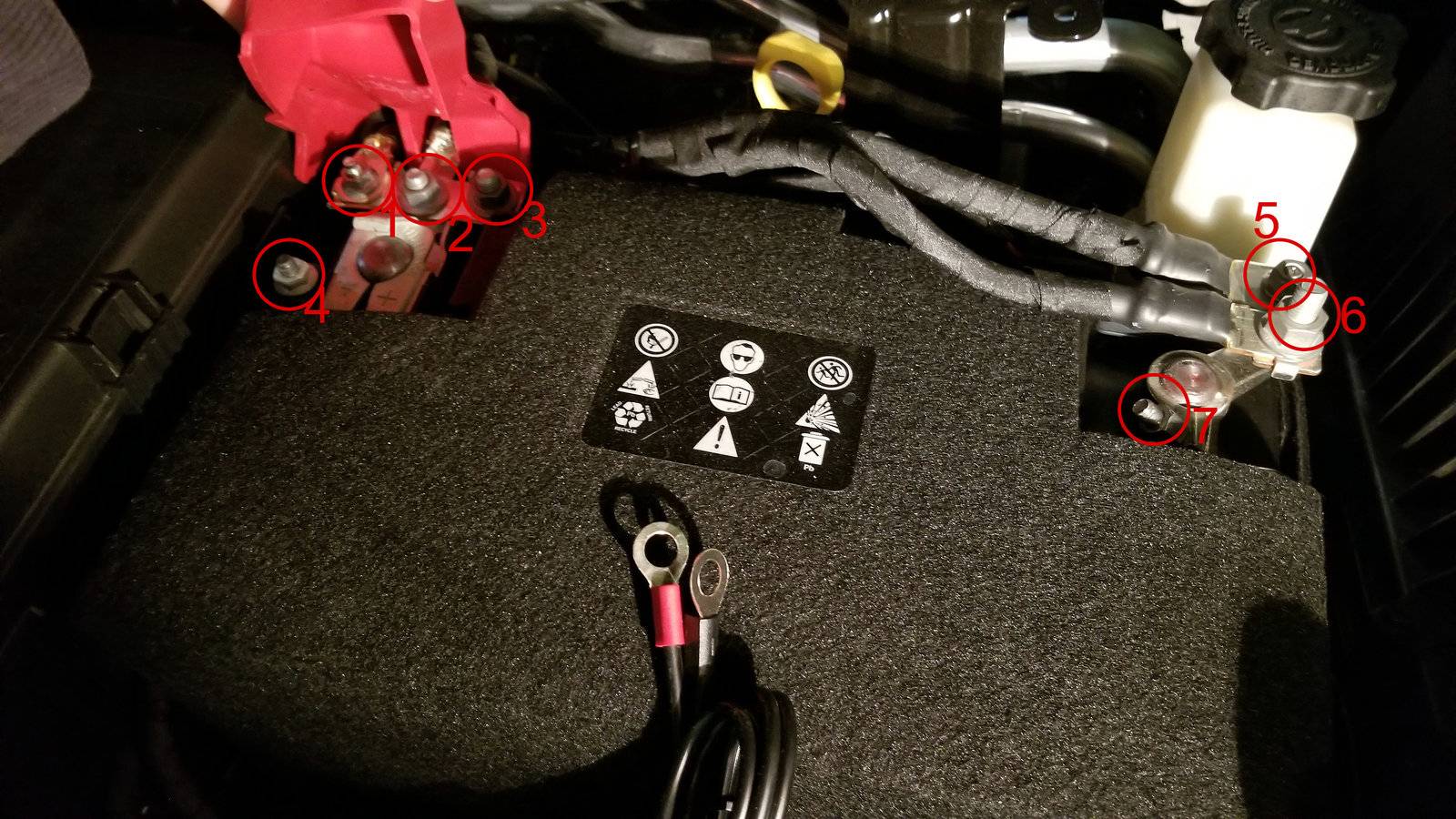

Jeeps have dual batteries?
There's a small auxiliary battery mounted underneath the main battery. It's for the A/S/S and from all my reading it usually fails and takes out the main battery with it. It has to be the dumbest set up I've seen! :facepalm:
Looks like some have just disconnected it and ran a jumper wire off the main battery (it'll throw a dash code if you don't) and then there's some Genesis dual battery kit you can buy for like $600. I have to read up more on it but for now I leave another maintainer on it and will most likely just disconnect it.
Here's what the main battery looks like. :shock:

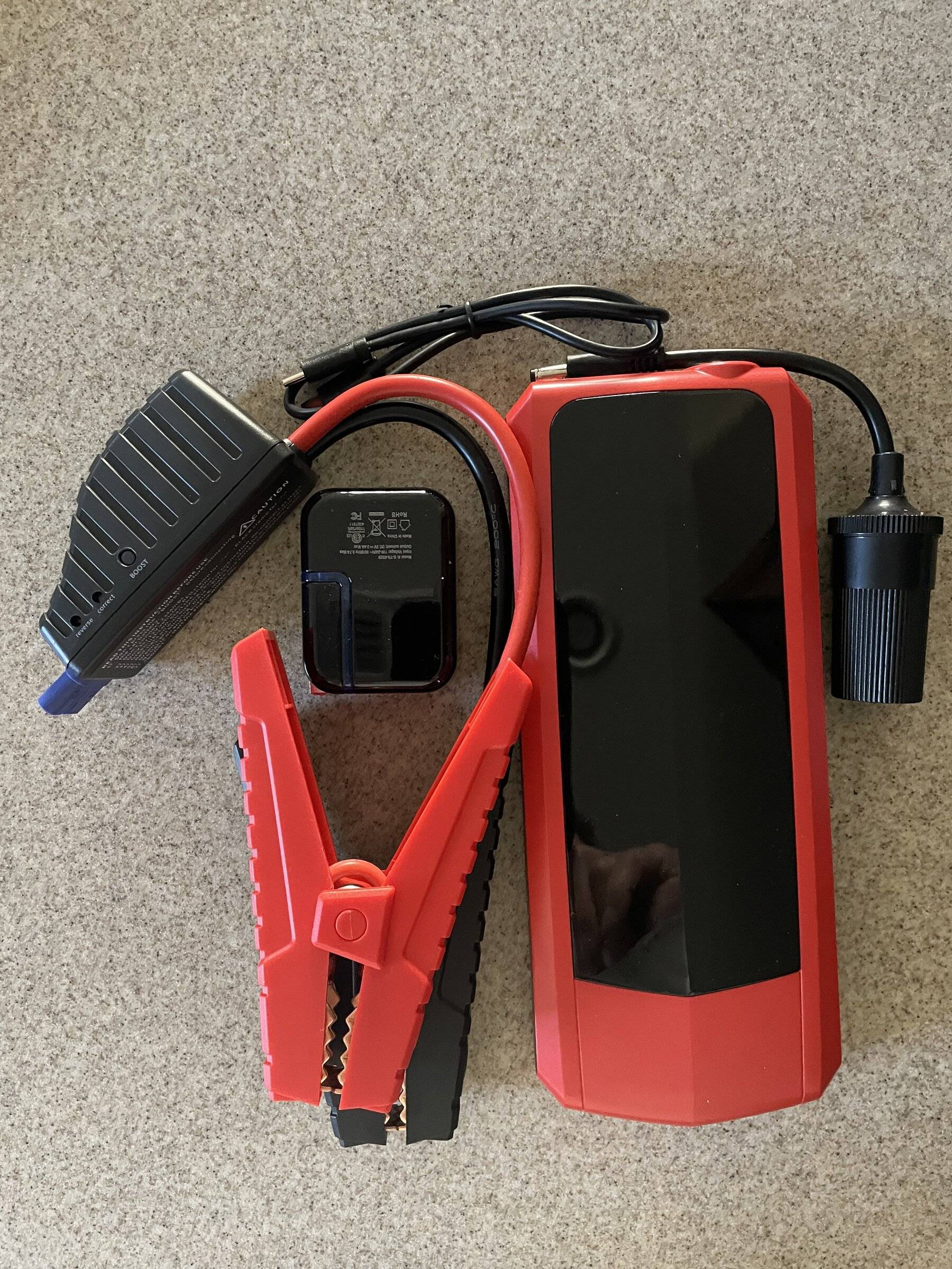

NWO Robot Polisher
Small peace of mind under my seat...haven't needed it but helped out few people so far and it works great...
I just got mine last week. Figured it's best to have it as we're going on a road trip this summer and don't want to take a chance of being out in the middle of nowhere and having the battery crap out. Plus I liked the look of it. lol

NWO Robot Polisher
I got mind for the same reason...especially when I'm lost in the middle of a grassy field somewhere... ?

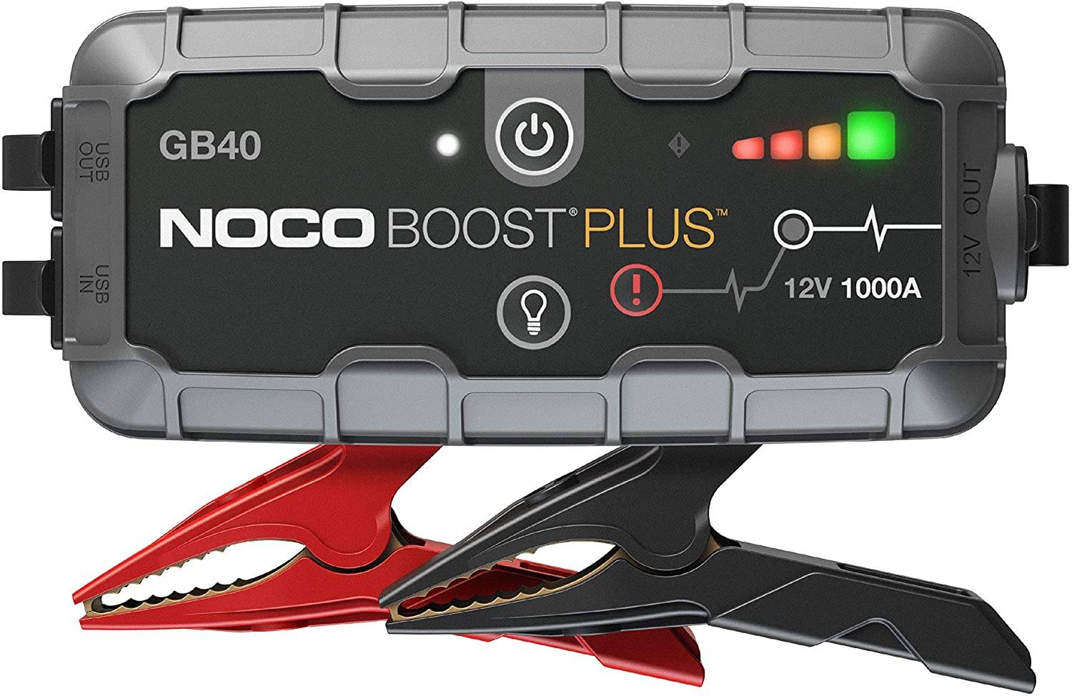

NWO Robot Polisher
this is what i got after my first battery issue.
it's what the tow truck guy used when he showed up to boost me LOL
Bet he charged you what he paid for the NoCo lol...
