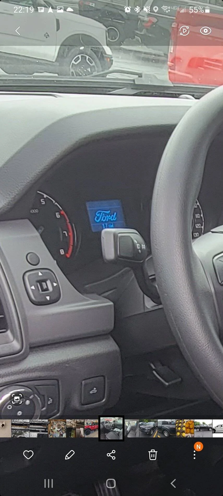

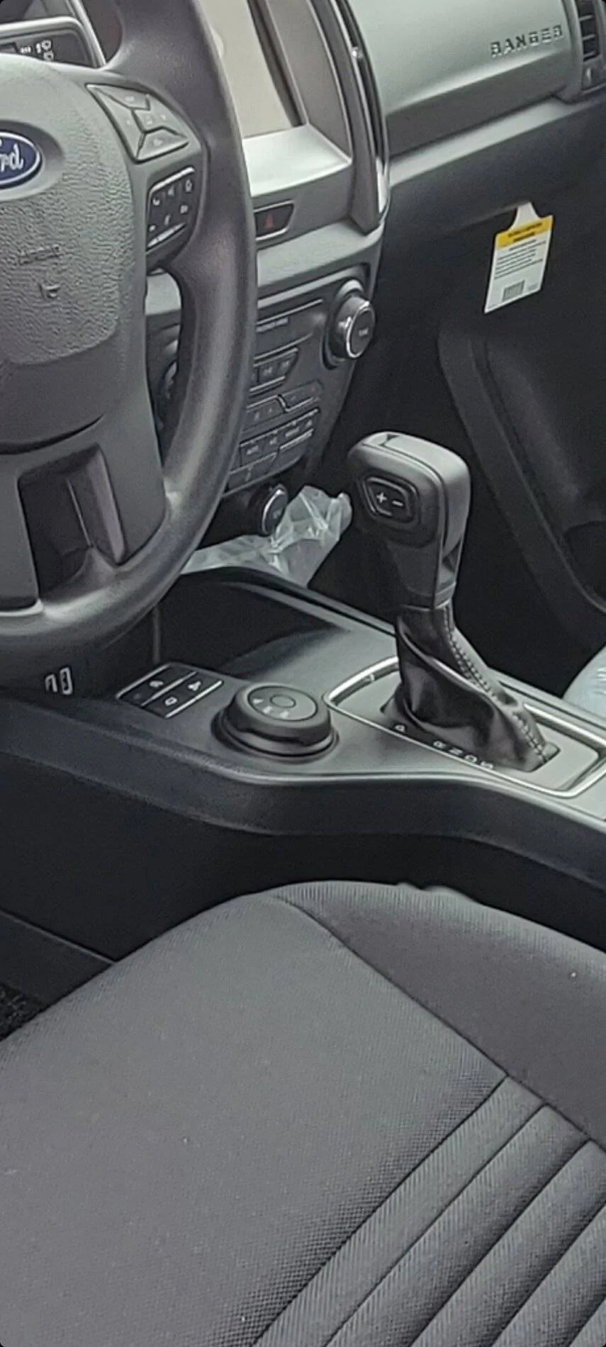

Is it possible to add the terrain management selector on the low model dash?

It's the basic black and blue screen in the instrument cluster
Your tcase selector looks identical to mine. I installed the TM button version and made it all work through forscan.
Do you have the black and blue instrument cluster?
