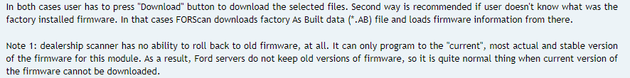

My Theory: Trail Control uses the ABS PUMP which is the exact same part number as a standard ranger but I believe has different firmware loaded on it for this function. For those of us without the factory FX4 option when we enable it in Forscan we get Advance Trac errors (ABS MODULE).
I just renewed my Forscan and I have purchased a ABS Pump from a FX4 Equipped Ranger. I'm not going to replace my pump, but simply connect it electronically to see if I can successfully enable trail control. And IF that is true I will then see if I can extract the firmware from it.

Well it looks like Forscan will not backup firmware, only load firmware. So if the above it true it would require a swap for a FX4 unit.
So maybe in the future... and it can update, but only based on the AS Built which of course is tied to the VIN.
