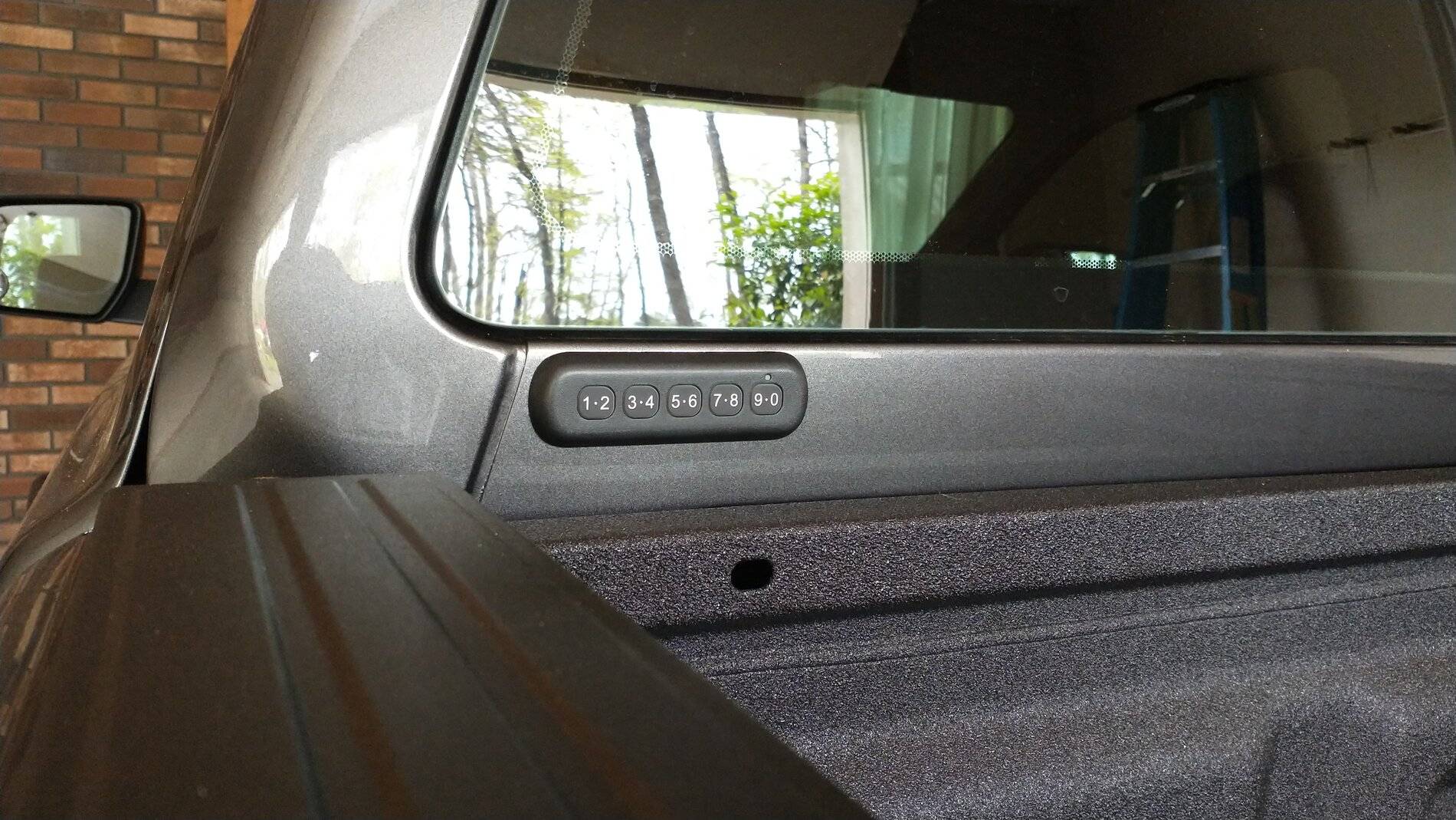

Yes, as Phil states dealer to activate it. I bought one went into FORScan set it up and it didn't work. It has an encrypted 128 bit code. When I had a service done earlier this year, they activated it no charge, I installed mine in the fuel door but had to remove the outside bezel on the keypad so it would fit better.

I had mine programmed today during an oil change. $100 which seems a bit steep to program, but nothing's free these days.
Told them to just put the keypad in the cab, and I'll decide where to mount it - hopefully inside the fuel door -- thanks to fob63 for the post above about removing the bezel for a better fit.
