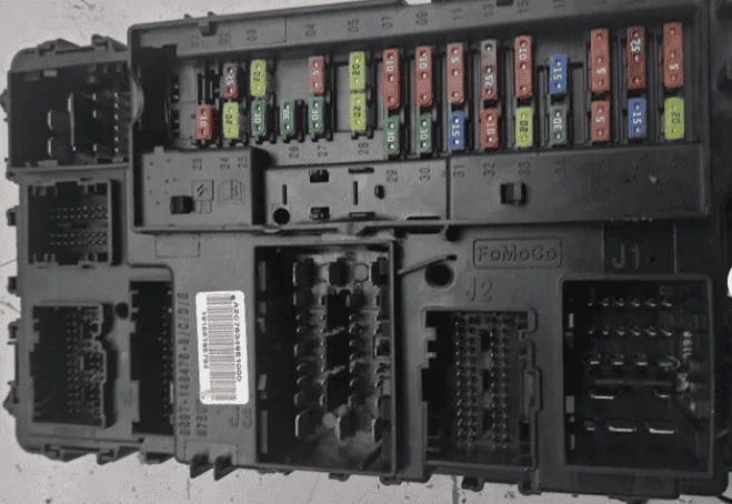

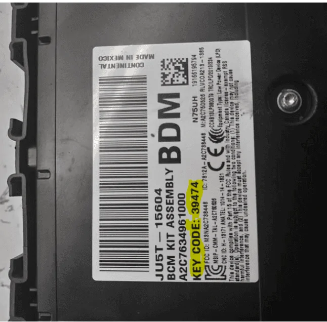

I may have found it. It looks like it is indeed on the BACK SIDE of the BCM
The BCM is the FUSE BOX:
This isn't mine... But I have a real nice endoscope that should find that sticker tomorrow.

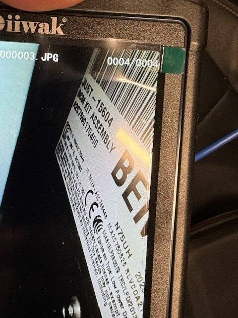

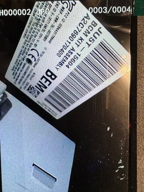

Well no suck luck... The above is from a 2019 Ranger "BCM" listed on ebay.
Mine is a 2020 and it has no KEY CODE writing on the BCM
