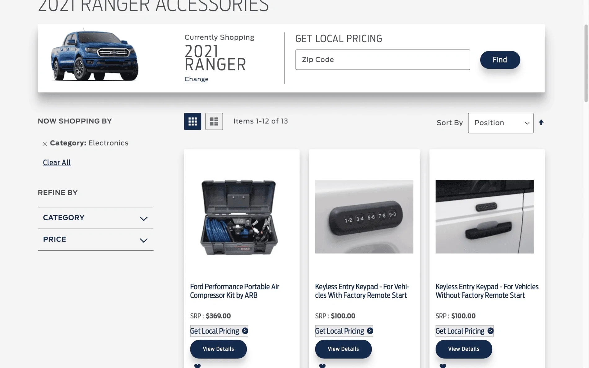

Has anyone successfully paired a remote keypad with a 2021 Ranger Lariat? I have pushbutton start, and have found a few procedures to pair the keypad, none of which work. Remote start works fine with the keyfob, I just have been unsuccessful getting the keypad to pair.
I called the dealer, they quoted me $400 - $500 to pair it. I laughed at them! That's a ridiculous price.

I could be wrong but I think there are 2 different keypads. One is required for the Intelligent Access/push button vehicles, and the other for those not equipped as such.
There is one for remote start, and one for non remote start. I purchased the one with remote start, but have been unable to pair it. I'm thinking that the 2021 version has a change that requires FDRS programming to add this. I may just have a $80 swizzle stick...
Gotcha, I knew there was something like that differentiating the two.
I'd bet you'd have better luck at another dealership. I seem to recall others getting them paired for much cheaper.

I have a 2021 Lariat with push button start. I had the dealer program the keypad. I was quoted $75 but when I went to pick it up they told me no charge because it was easier then they though. I was very surprised but I like that dealer a whole lot more now.

I really do not know if it is just push button start or any vehicle with remote start. You sent me the pad for vehicles with remote start, which I have remote start on my Ranger... It is claimed that the customer of such vehicles does not need the dealer to program the keypad but I can find no instructions for how to accomplish this..... It sits in my shop colleccting dust currently.....
10-4... I think it depends on whether it has or hasn't got remote start, which I.A. has, but it is available separately

i bought it on the app for about 100 and paid $24 for programming. There was some holiday promotion so I got 20% off. The local dealer did it for what I paid on the app. The just need the email I got when I ordered. it.
