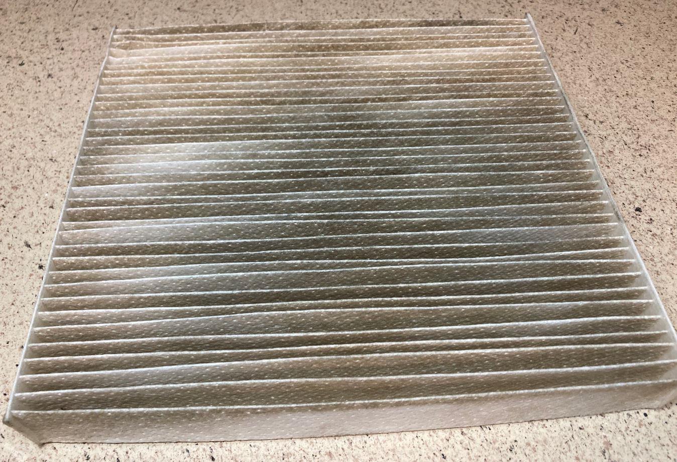

I too have the BO smell with the AC on at 18k miles. I thought it was from the previous owner being a smoker but now I'm not so sure. I smelled the old cabin filter after removing it, and discovered it stank just like my AC vents. Replacing the cabin air filter did seem to fix it at first, but now it's definitely back.
I've tried ozone too, which helped a ton but not enough. This totally sucks.
My wife's car had a real bad problem with pulling in exhaust odors form other cars while driving. So much so that she hated driving it. The fumes would regularly give me a headache as well. I found that the Spearhead Premium Cabin Filters did an amazing job at odor control.
Since mine would sometimes have this mildew scent when first starting I decided to look to see if one fit the Ranger. I did some cross reference checking and found
this one that fits the Ranger perfectly. It doesn't say it does but it does cross over to the PUROLATOR C35519 filter and that one is a perfect fit. Since installing it I have had no issues with the mildew smell or any other odors. It even managed to filter out my 14 year old dog's fart on a recent road trip And let me tell you that poor old girl can peel paint from across the room... Needless to say, I'm sold on these filters since that day.
