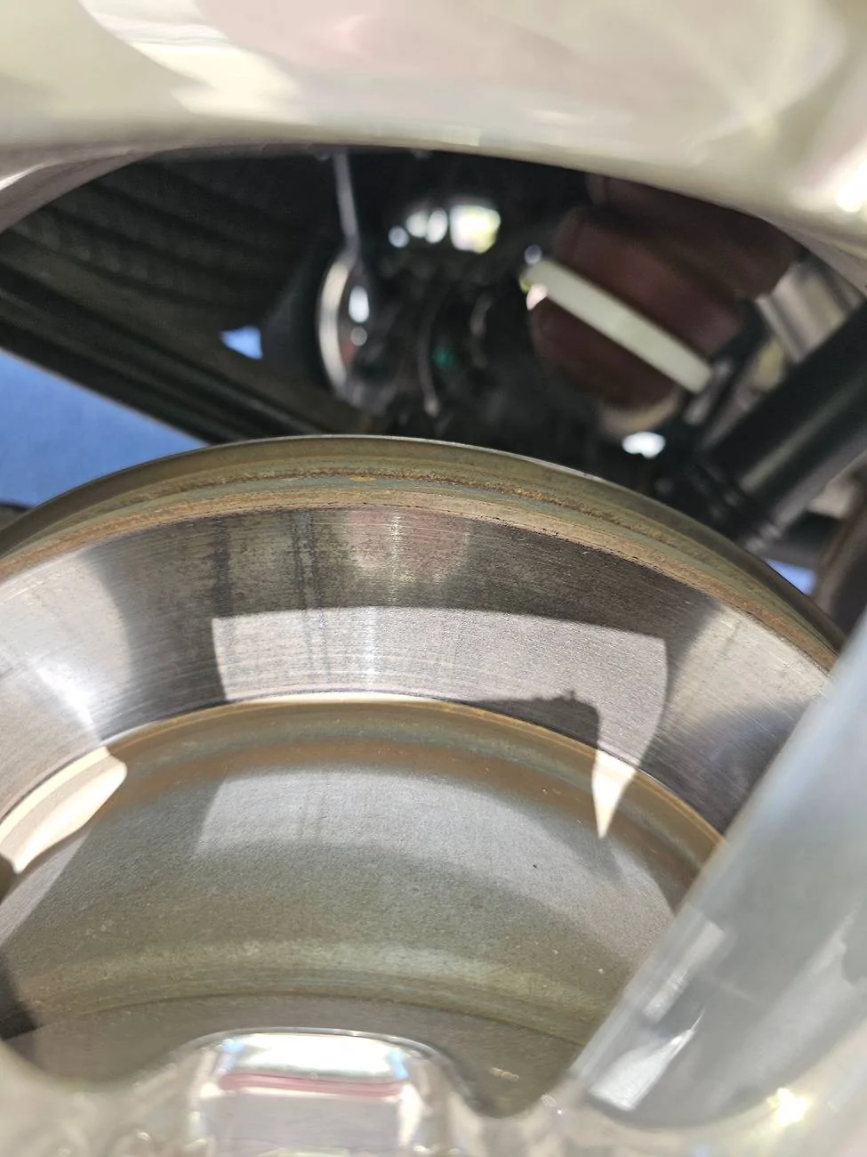

Like @Grumpaw said drive the truck without the trailer and see if your getting a pulsation through the brake peddle when you come to a stop which could indicate a warped rotor. If you did over heat them you'll probably just have to replace your pads and rotors sooner than normal.
To take this one step further....if the truck stops/acts/feels normal by itself, then it's possible the trailer brakes were overheating which causes a burning smell. As trailer brakes are drum, its impossible to see their condition without removing the drum. Drum itself can be recut but if shoes are burned/glazed then replacement is called for.
Without knowing the history of the truck/trailer, very hard to give correct advise. Was trailer a new or used rig ? What condition if used ? When/if brakes were ever done, bearings repacked, ect ect ect ??? I have seen bearings that were going dry overheat and literally melt and burn the spindle. All these items must be looked after/kept up maintaince wise.

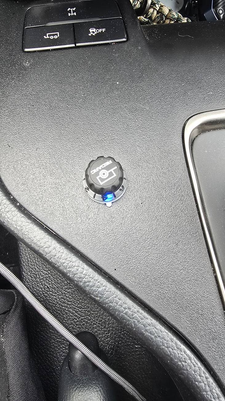

I have my tbc set a little over 4 for a 6500 lb travel trailer.
Grumpaw said it best. Find a parking lot or an area where you can do about 25, then manually push the tbc. It should stop you. Not slam you to a stop, and not take 100yards either. But smoothly and quickly. It's a feel. To much gain and you can feel the tug of the trailer. Not enough gain and you feel the push of the trailer.
I have overheated my brakes. Nothing wrong with them, but my rotors are warped, and it is not dangerous just annoying. My ranger shakes to a stop as pads do not evenly apply pressure to the rotors . Left like this my brakes will wear out quickly and not play well with alignment and front end components. Just makes everything wear out quicker than should.
Play with the gain if you can before you tow again with trailer attached. If in a hilly area you may need to increase it. Increase or lower by small increments, do not jump from 4 to 6. I guess you could, and you will see the difference.

Hello, thank you so much everyone for your replies. It's dark now here in Pennslyvania but I will check the Trailer's brake drums in the morning. The trailer is a rental. I'm testing out towing to see if it's "for me" before buying a trailer. I can't say if the guy kept up with maintenance. It's just some random dude who rents out his trailer. I kept the gain at 4.5 and the trailer is 3500lbs. Based on another members experience, it seems like that is too high. I am going to test it out in the morning and likely keep it on a lower setting.
I tested my Ranger while unhitched and the brakes seem to work fine. I noticed a little bit of sputtering while coming to a stop between 10 and 0 mph but honestly it's so faint I can't attribute it to the rotors, it felt more like transmission downshifting to me. It could be rotors though. If I did damage, it seems like a small amount, fortunately.

Just quick taps of the brakes down hill to adjust speed. Never ride them, they can burn out in glaze in one steep grade. Only used for emergencies. Start 10 below, by the time you are at the bottom you might be 10 over and thats ok. Watch how semis drive in the mountains, you basically want to mimic that.

@seasprite thank you for your expertise. What does it mean from here? Do I need new rotors or just to take it easy? God I feel like an idiot. I just bought this truck.
