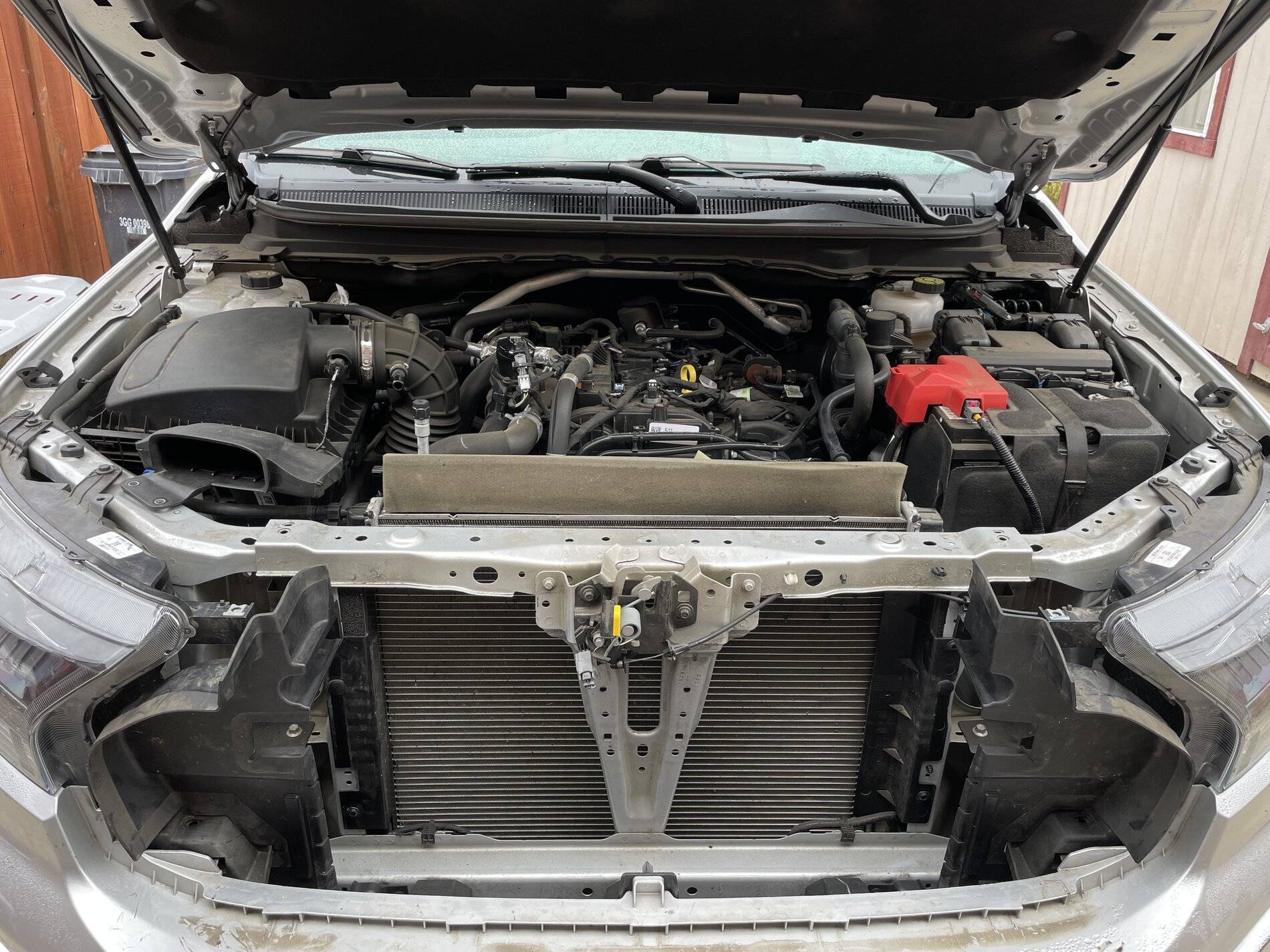

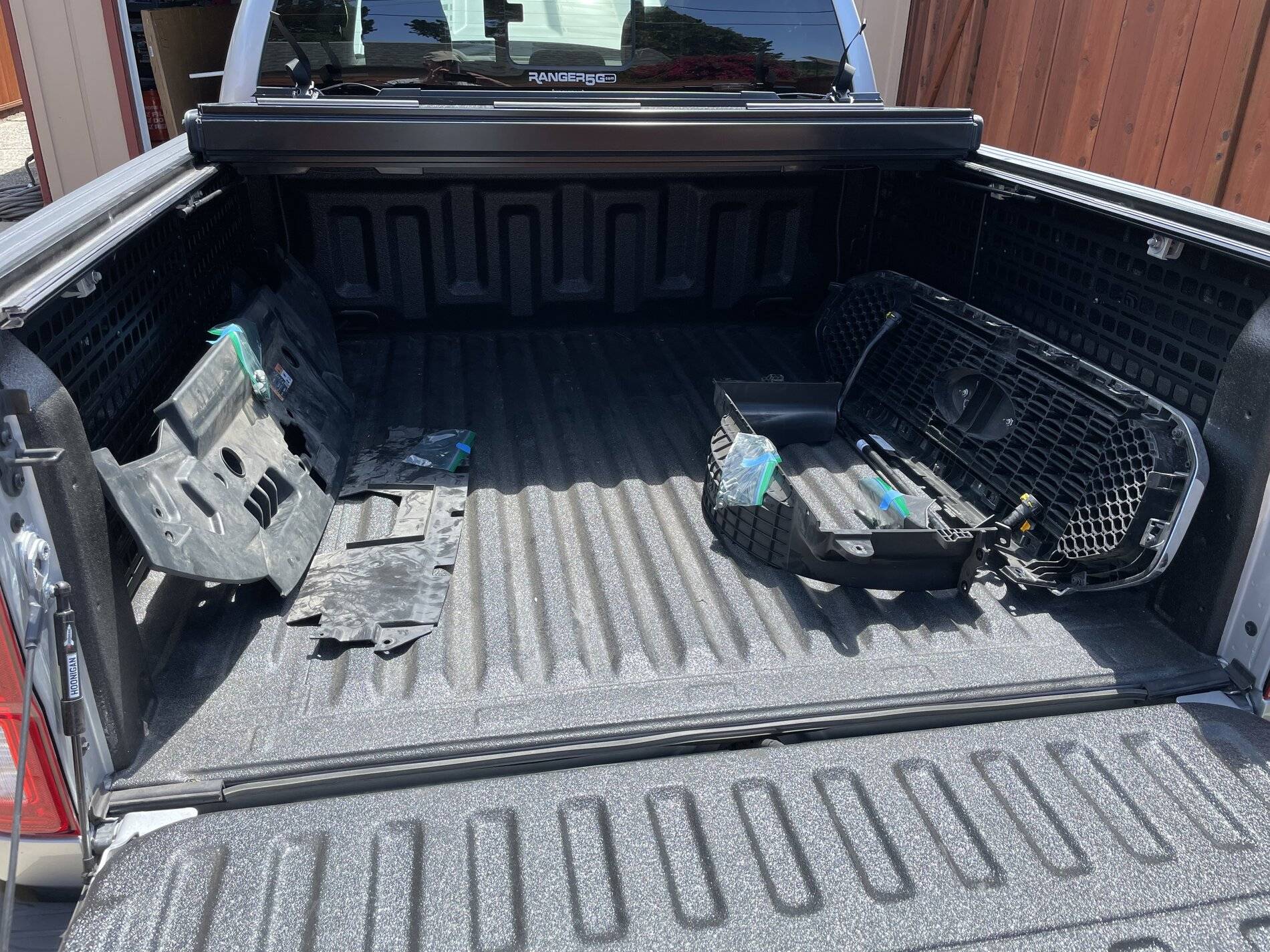

Just finished getting the "top" pieces out and away, no broken tabs, no lost screws/bolts...so far.
I'll remove intercooler after lunch and drain radiator as I move to undo radiator and condenser.
I had forgotten about the two side clips on the grill and couldn't (for the life of me) see what was holding it back. Decided I would take a look at manual just to double check, sure enough...duuuhhh!

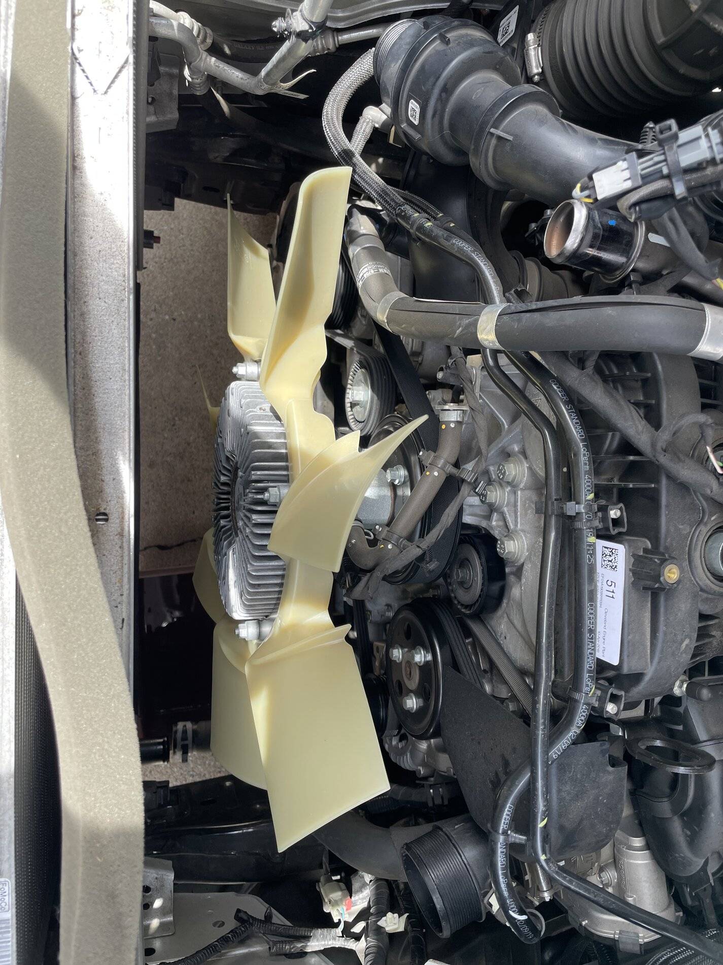

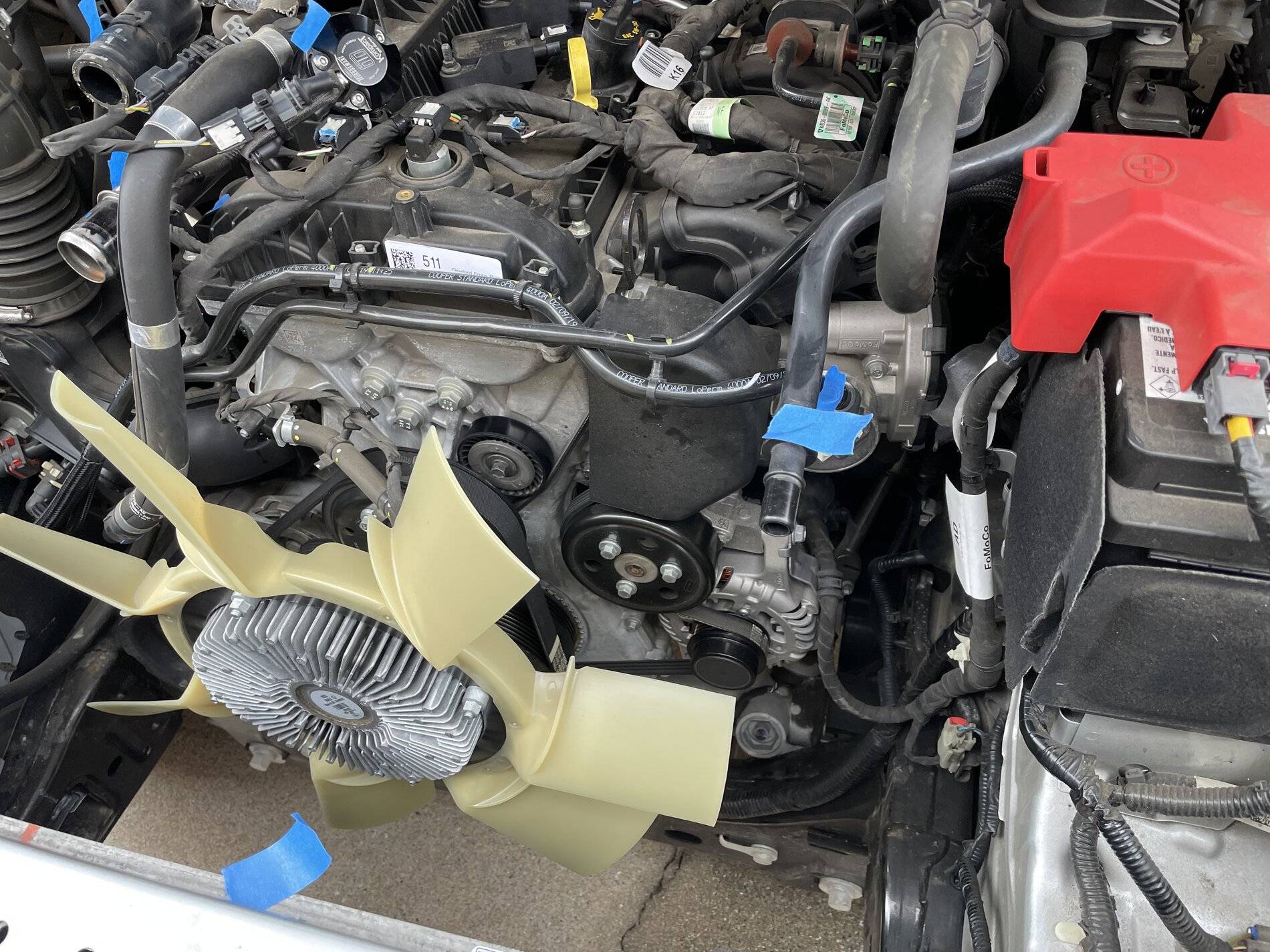

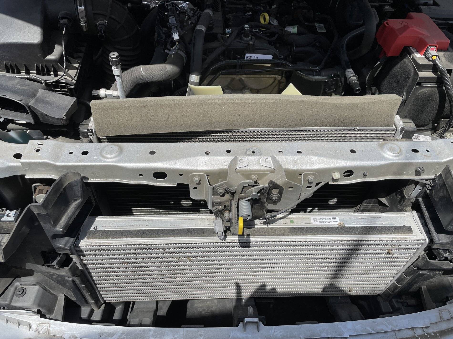

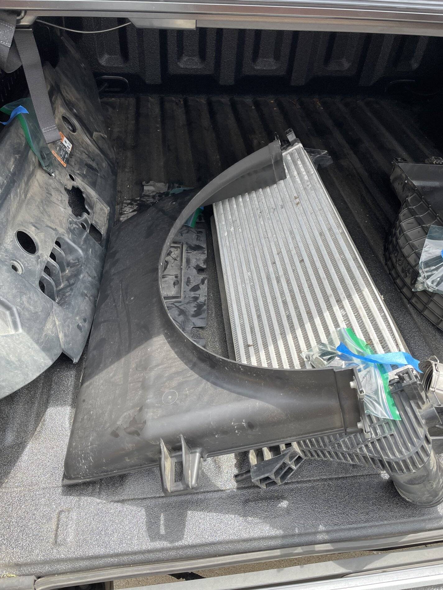

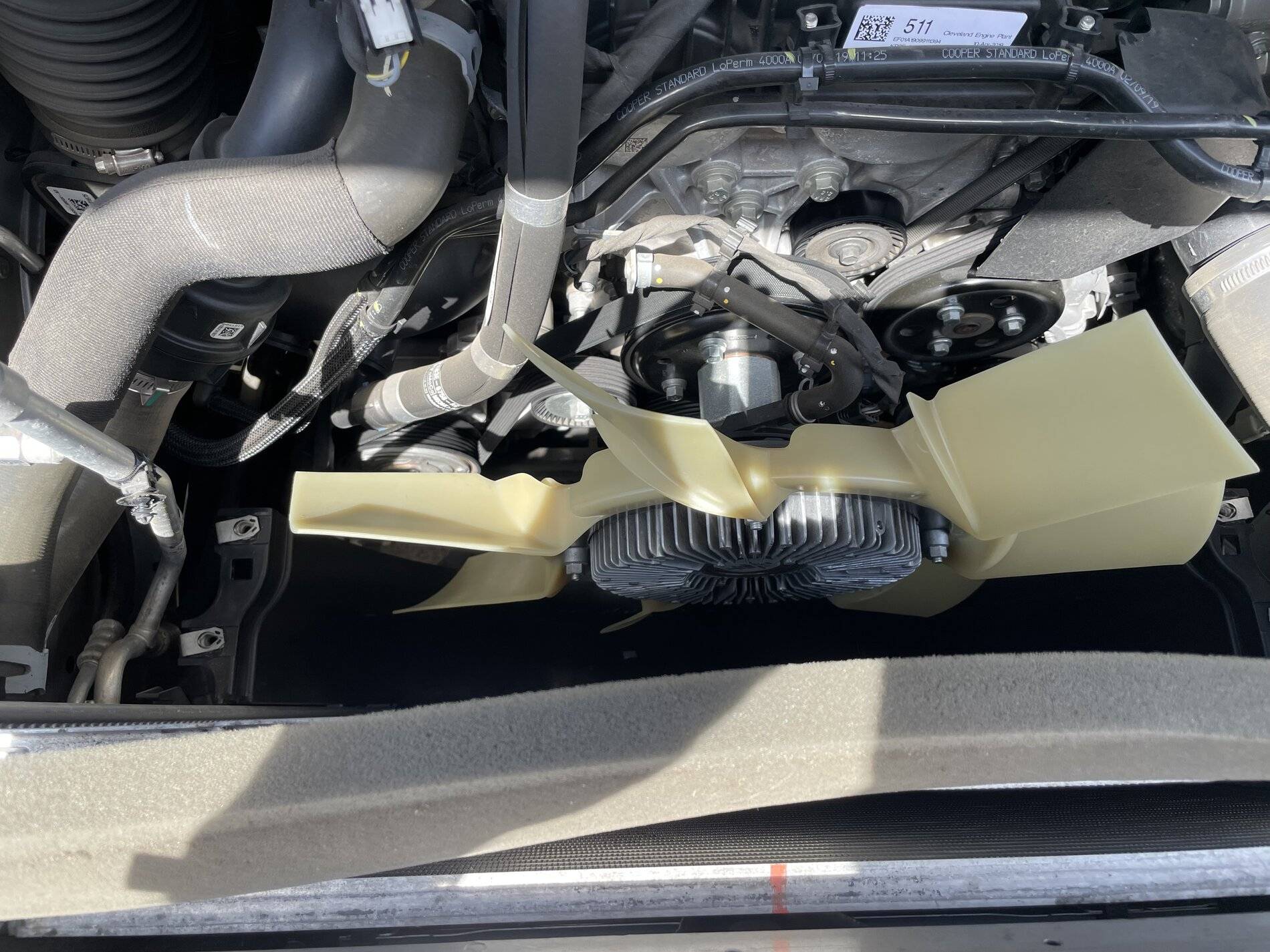

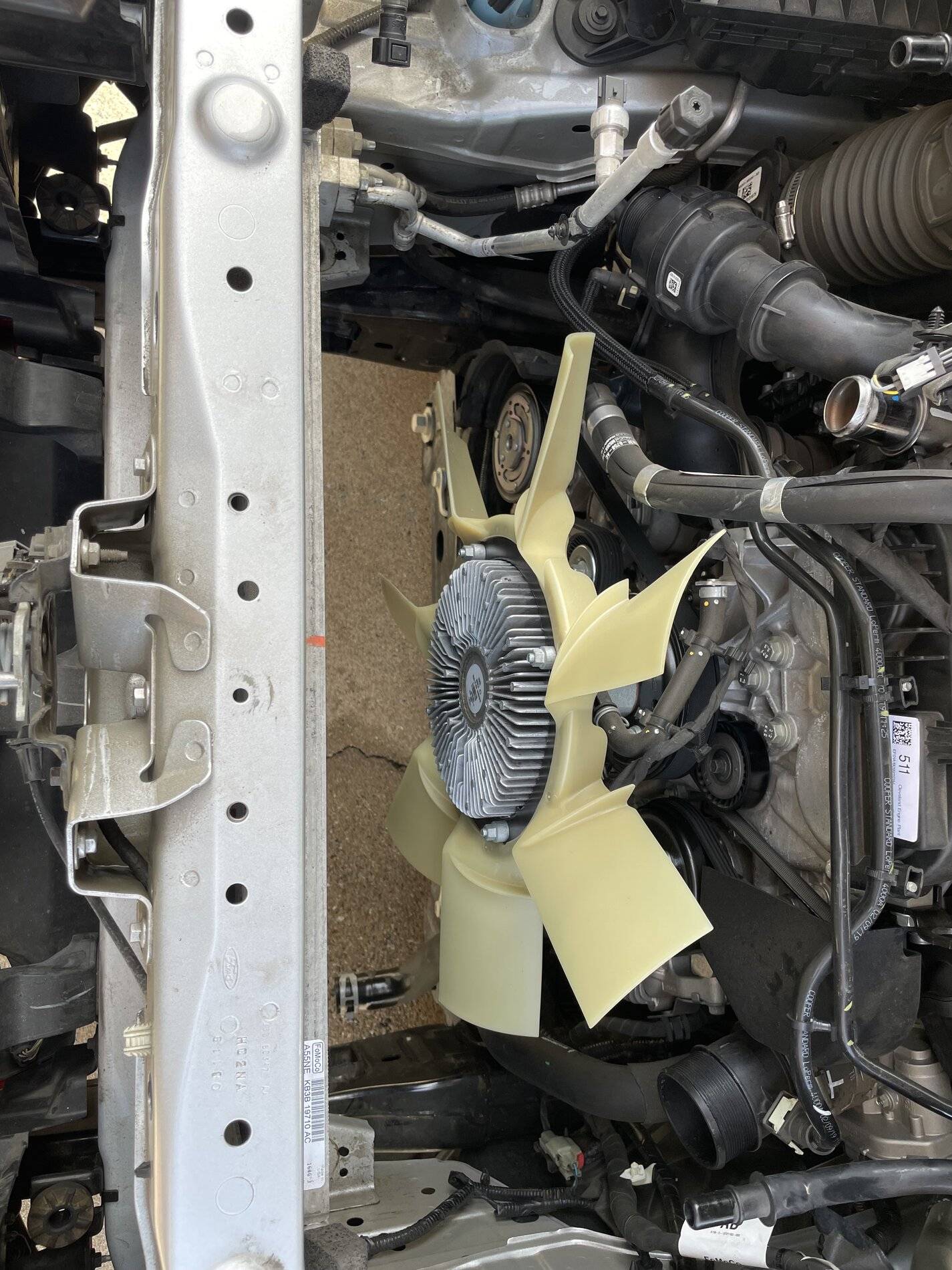

So, today got the intercooler out, radiator fluid drained, hoses disconnected, radiator unhooked and best of all, condenser unhooked but still fully connected. Removing the fan shroud gave plenty of room to tilt back the radiator and with the intercooler out, condenser was right there...release the tabs and slide up until loose and then sit down in well. Rubber connection lines allowed the "slack" necessary (tilt radiator/condenser assembly into fan area maybe 4-5").
Only "HUGE" issue was trying to find the lower shroud bolts/nuts that the manual, directions and Ford parts said was there. Turns out it is not a threaded clip nut, nor a bumper bolt, but just a plastic snap in that depresses for release. After a couple of hours screwing around trying to feel the bolt head, I finally got my wife's mirror to see what I was not...took two minutes after that to release the shroud and pull out from the bottom.
Intercooler out
parts pile with top shroud out now
Shroud's out, hoses gone, radiator unhooked and condenser unhooked from radiator.
stay turned for further adventures of "What the Hell?!"

Radiator's out now, had to take air inlet off air box, don't remember seeing that anywhere either, but certainly gives room to lift out radiator and move condenser slightly left to do so.

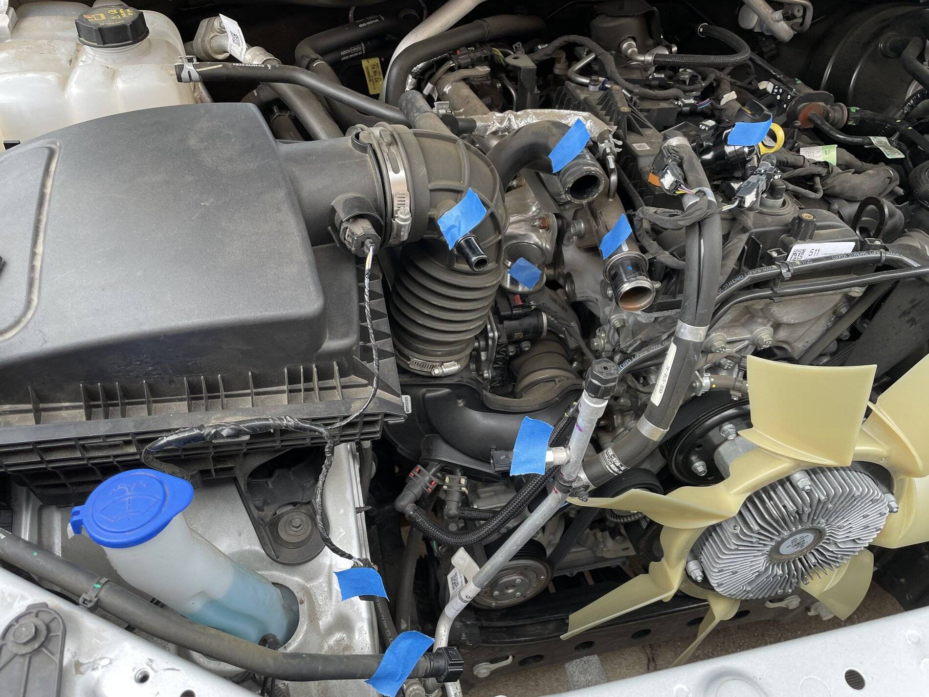

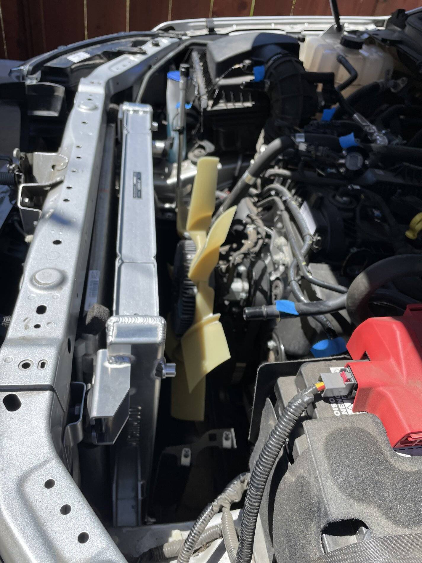

Today's adventure so far:
Tagged everywhere that something was unhooked/removed.
Installed bottom radiator hose and connected to engine under throttle body.
Installed new intercooler (right side) elbow.
Installed radiator.
Connected condenser.
Thread chased a radiator bung for bottom shroud mount.
Have to wait for sun to move now...
Another view
Radiator/condenser installed/mounted.
Todays exciting issues:
Set screw for condenser top mount wings: passenger side is a "finagle" as the AC lines hinder direct screw in.
Check radiator bung threads beforehand - (4): had issue with one of bottom shroud ones and it was a staller.
Overall, Mishimoto's quality is excellent; shipping & packaging are excellent!
More adventures to follow. :like:
