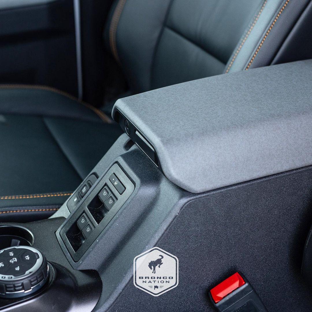

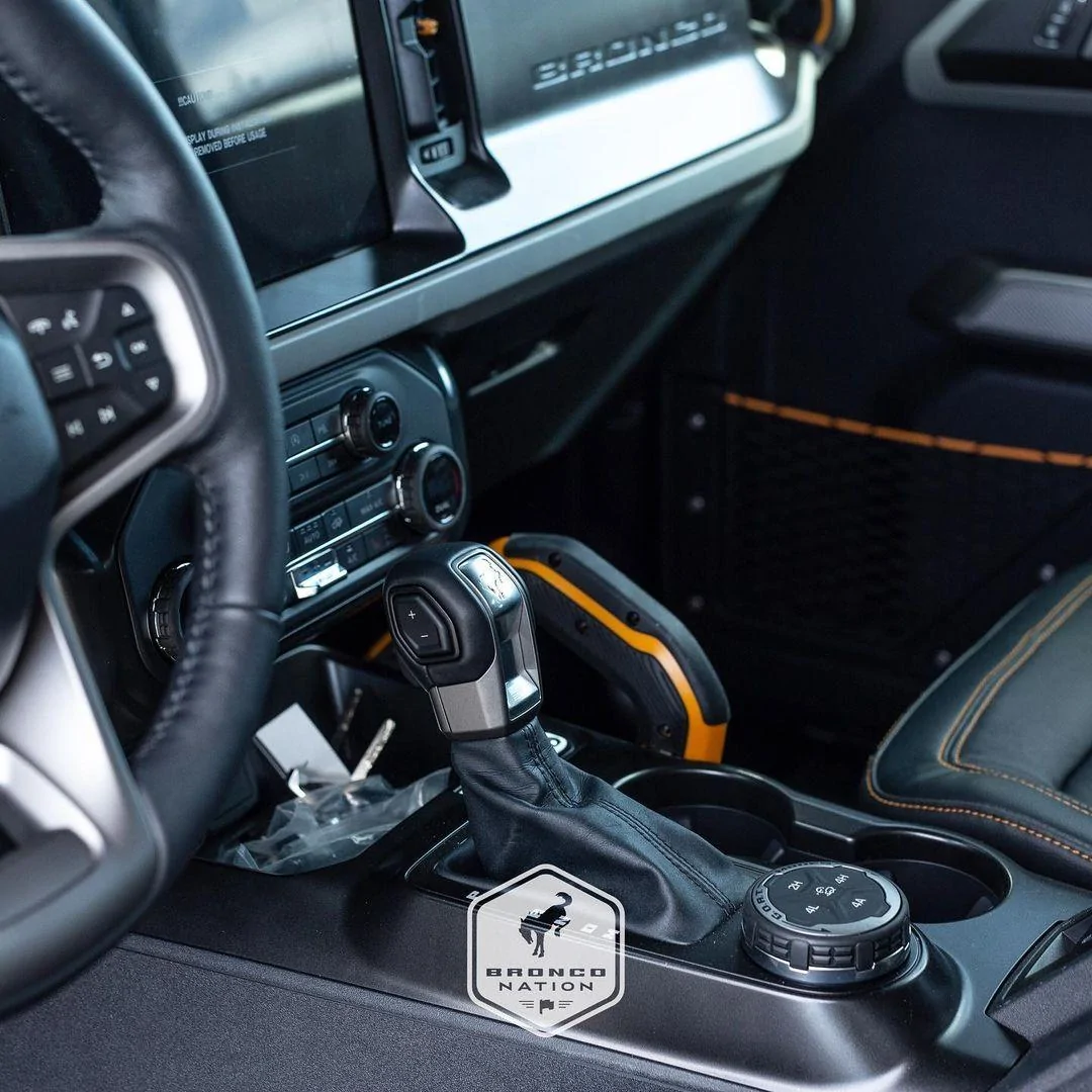

Lol I'm guessing they learned from the Ranger complaints. What's nice is they're interchangeable for colors too. There's one on the passengers side and also on the passengers center console.

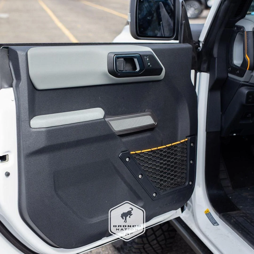

Another thing I love is they put all the window controls on the face of the center console. Makes it much easier to use and a cleaner door look.
