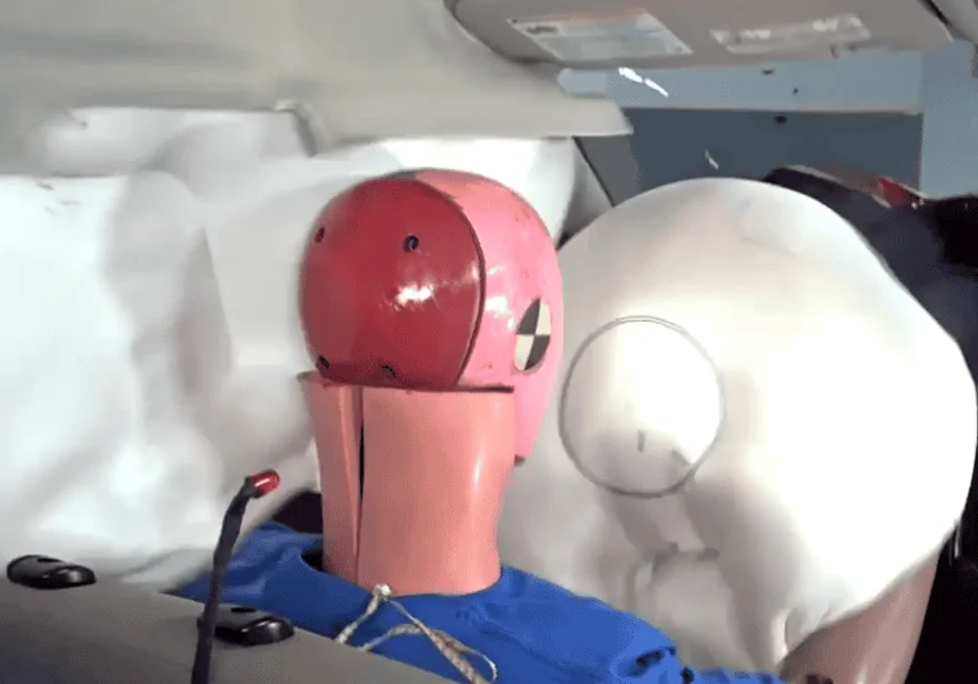

Are you saying you saw an airbag deploy from the drivers side A-Pillar in those videos? Because if you did, I must be blind - I did not. The only airbags I saw deploy on the drivers side was from the steering wheel and the curtain bags from above. Even the passenger side I saw nothing come out from the A-Pillar.
What am I missing?

I played the two that deployed the side curtains back in slow motion and it appears as though it all pops out from above. In the first one you can see the plastic trim pop out when the curtain deploys. It looks like it does the same on both sides:
It is crazy how fast those airbags deploy! And they are smart enough to only deploy the side curtains if it is some impact on the side. The full frontal crash didn't deploy the side airbags, just the front.
It is pretty amazing technology......

I think you hit on it: packed partially in the A-Pillar, deploys from the header is my guess.
