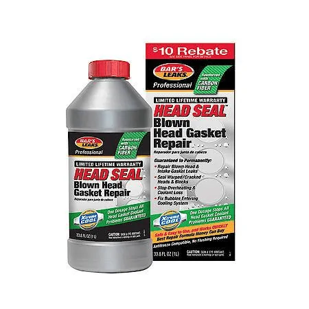

time to belly up to the Barr . I remember using barr's stop leak on a radiator many years back and it was awesome. and as you can see you currently may qualify a $10 rebate !
Just want to remind people NOT to use stop leak. It's absolutely terrible. Especially ones for coolant. It clogs passages and CAN cause more issues than the leak would. If you are really hurting for cash, sure. But really try to avoid using it if you can.
