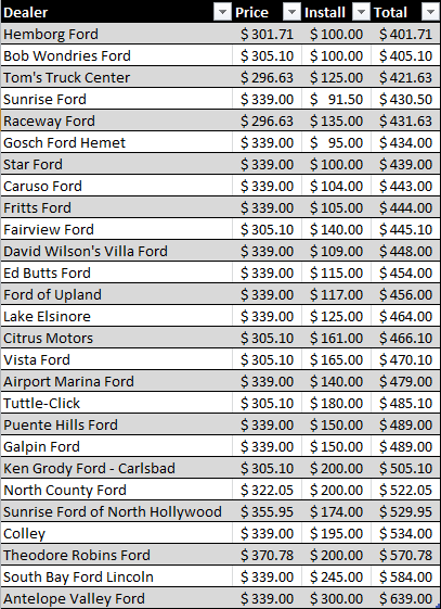

We're looking at potentially borrowing a family member's camper at some point in the future, I don't otherwise do much towing, but this has been on my list for a while. So I went through the Ford Accessories website for the Los Angeles area and came up with the pricing for the controller and install.
For your perusal (prices as of 9/11/2020):
I can't remember what I paid for the kit (I did mail order), but if I could have had it installed for $100 I would have done it--it was a colossal PITA. That said, in retrospect it was quite character building and I learned a lot about the whole system. Also, my control button is mounted in the center console, near the TM knob, and a dealer might not offer that option.
Other guys here have gotten their dealer to comp the install, you might try that.
