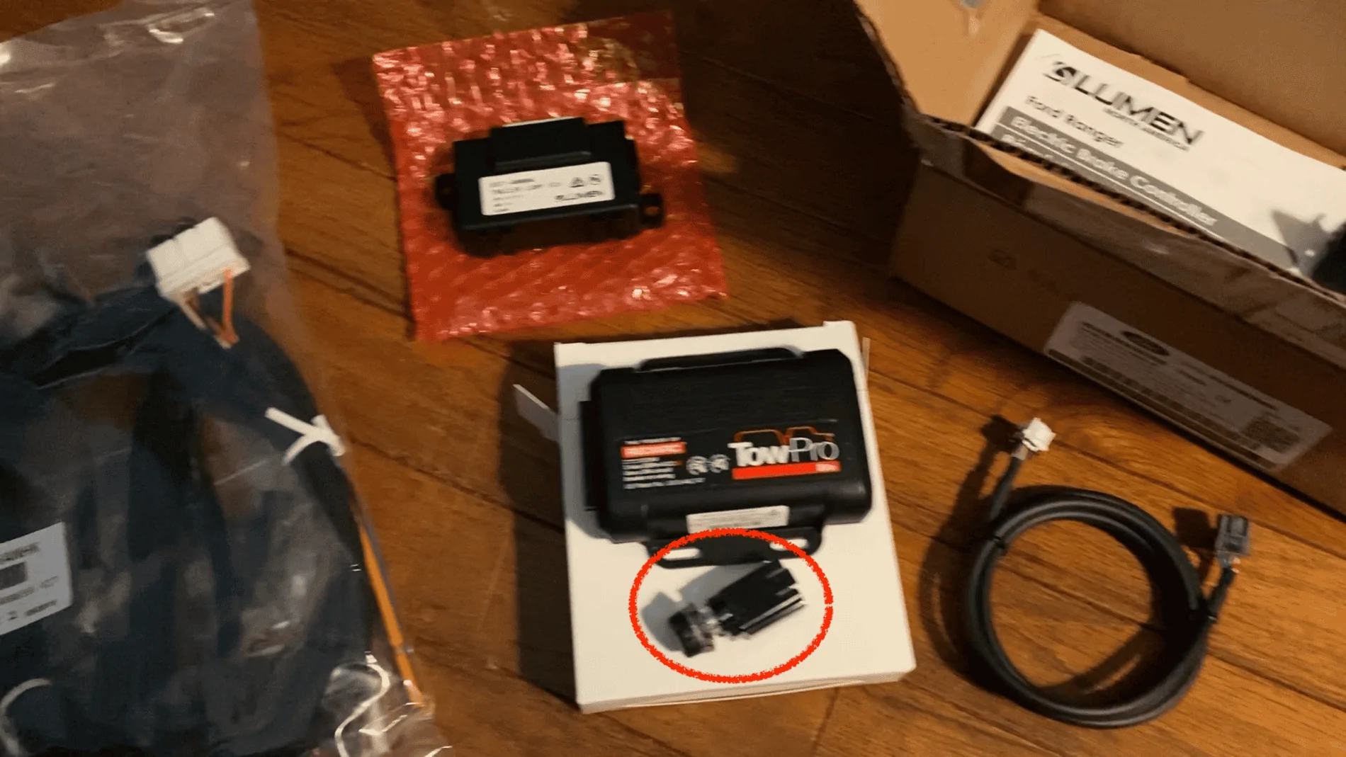

This is what i got from Ford. Sort for the fuzzy, it's a frame shot from a video I am making.
Part #? My dealership looked at me like a crazy person when I asked about it
VKB3Z-2C006-A
Be prepared for dealers being clueless about this--not their fault, the whole thing is a kludge by Ford, but in the end it gives you the OEM look and functionality.

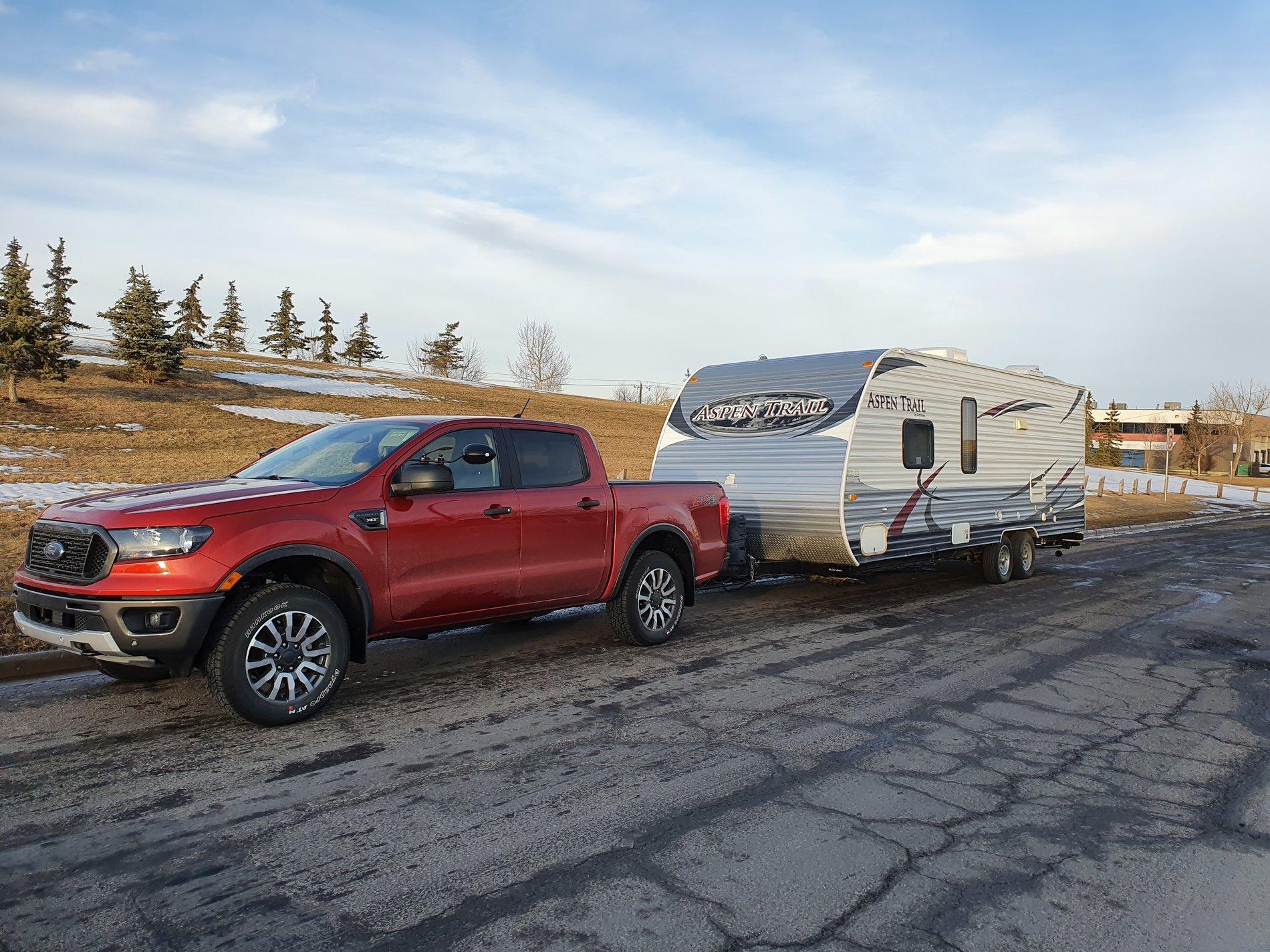

Towed this 4700 lb beast over over a mountain range - Calgary to Golden (260 kms / 160 miles) over the weekend with the new controller. It took a little bit of fiddling to get it dialed in correctly but it worked good!
Truck was working pretty hard over the passes but I kept it slow and steady.
For the record, I got 20L/100 KM's (11 mpg) out there.
