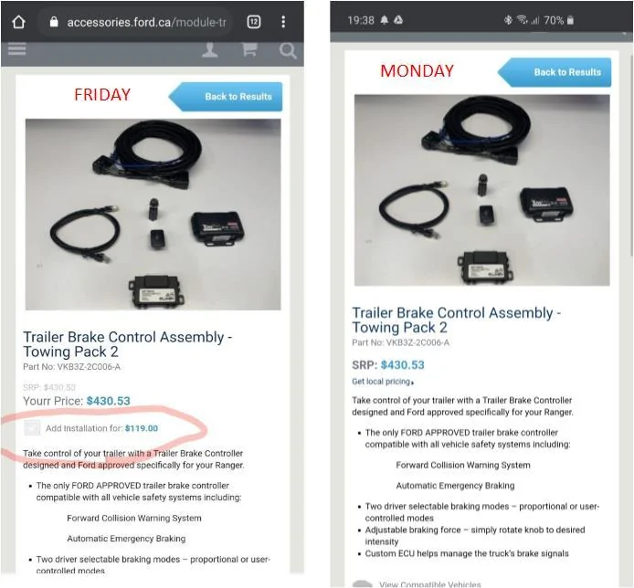

I think my original dealer has agreed to cover the install as I am the first in my city of a million people to do this!
Ford Canada had 38x of these on Friday and 18x today, and since then the "Add installation for $120" has disappeared.
I guess I'm going to be the guinea pig. The parts guy admitted that Ford has really screwed up on this one.
Stay tuned.

UPDATE:
On the Phone with Ford Canada and a THIRD dealer with new information.
Ford Canada states that the TOW PACKAGE that I have installed on my XLT FX4 has built-in part # FL3Z-19H332-B which controls all the Autonomous Emergency Braking (AEB) like normal operation.
IF...if you did not have the TOW PACKAGE installed, then you would buy part # VKB3Z-2C006-A. Ford Canada said these two parts operate the same and that I don't need the RedArc one because I already have the appropriate trailer brake controller installed.
Apparently, all gain is done on the dash controls and gain is controlled by the buttons on the steering wheel.
I definitely have conflicting information here, but Ford Canada has some weight in this...
BUT....I just went down to the shop downstairs and hooked up a trailer...no trailer controls at all on the drivers console or controllable from the buttons.

I just updated my post...Ford Canada is ALL WRONG. That module that is already installed is the one that talks to the 4-wire/7-wire harness.. nothing to do with trailer brakes.
