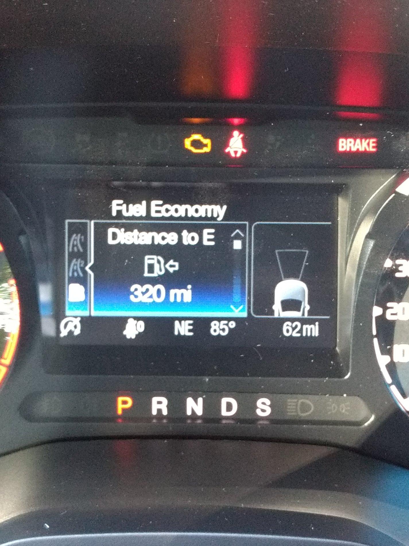

I've got you all beat. Bought the truck yesterday, got this today...

Welcome to our exclusive club.
Just curious what your blend dates are? Wondering if there was a bad batch of injectors somewhere in there - seems like there must be - just wondering if you can narrow it down to certain weeks or something.
