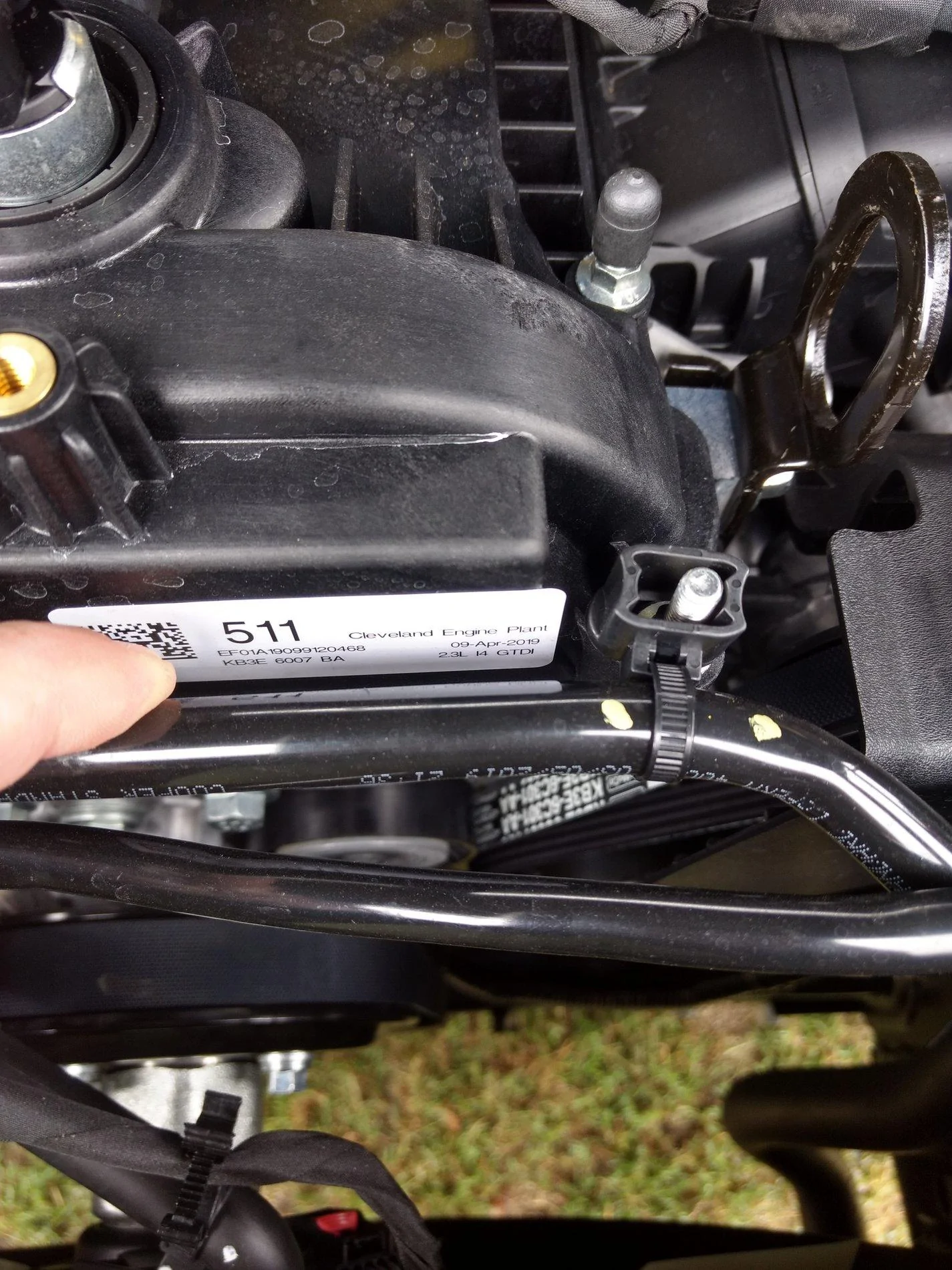

Engine build date of 04-09-19
Wow - they pretty closely correlate with build date - my engine date was 3/11 and my build date was 3/19 - your was only 3 days apart!
Just in time parts inventory, I guess!
