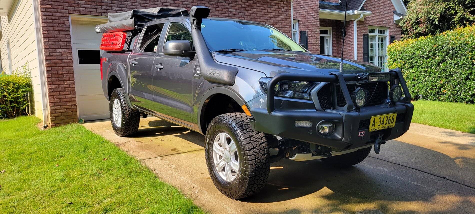

Was going to go with a smaller size but I thought go big or go home. These look absolutely amazing. My tire Boner will not go down.
Yes I completely removed the front crash bars and heavily modified the rear crash bars; so what, my other vehicle is an 87 GMC truck with no airbags and only one working seatbelt so obviously safety is not my top priority.
Yes a tire of this size will also fit in the spare location.
Yes I have faction Fab 1.5 spacers from our good friends at Stage 3 motorsports on as well.
No, at least on my truck, you do not have to do anything with the TPMS system, it resets itself.

Nothing other than what was in my post. 2.5 level up front, 1.5 wheel spacers, mod rear crash bars, remove front ones. No rubbing.

Dang my bad I did forget to mention the 2.5 level. I’m gonna say a tremor could fit them with the spacers (even just 1” ones) and crash bar mod/removal. The 285s are worth it!
