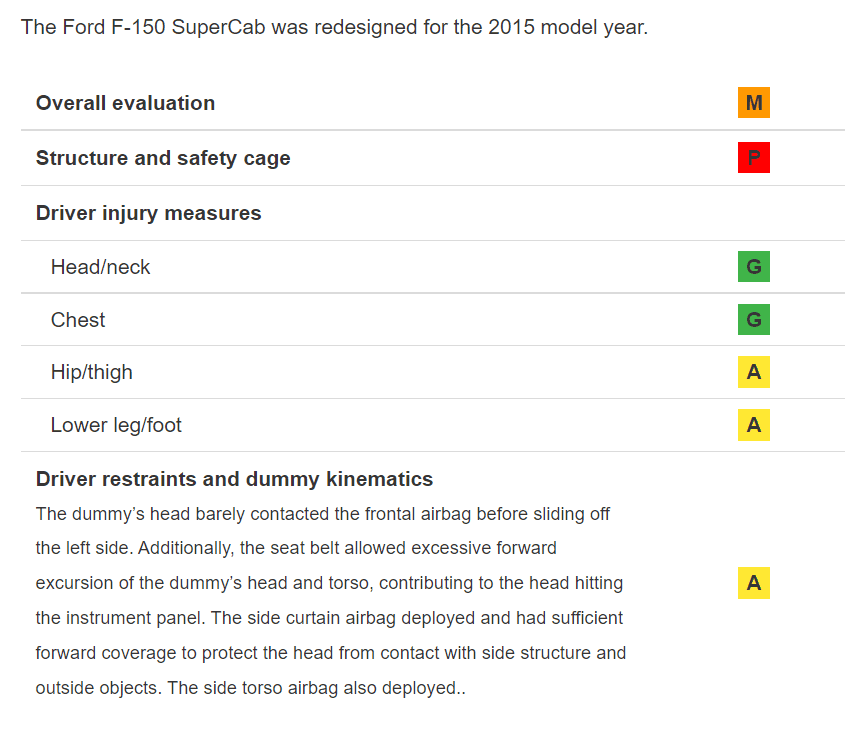

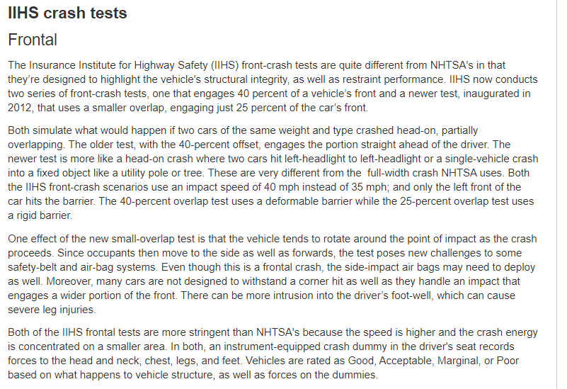

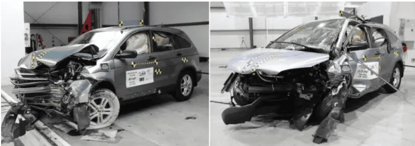

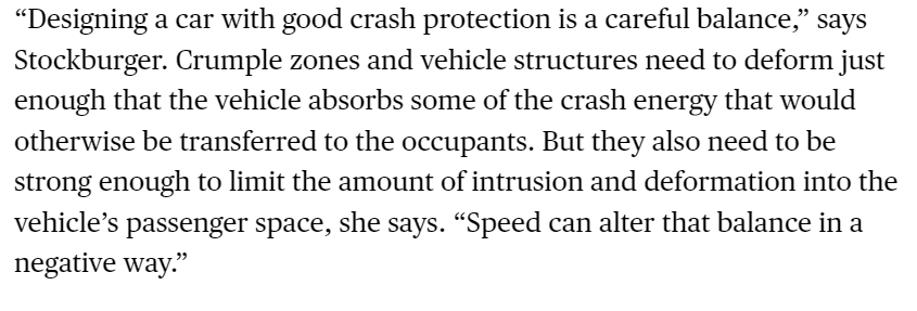

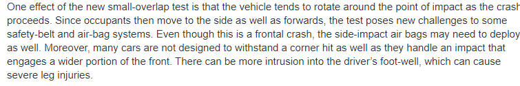

we both know that data is buried into mountains of internet searches.
but i'll do my best to pick out tidbits. let me know when you've had enough.
I could do this for days.
https://www.consumerreports.org/cro/2011/08/crash-test-101/index.htm

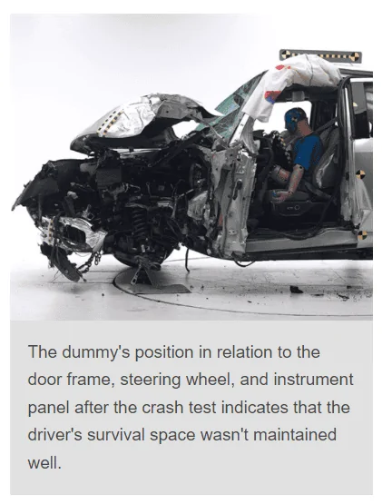

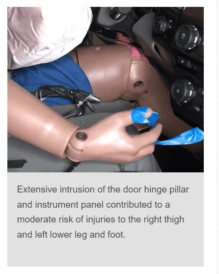

https://www.consumerreports.org/car...ve-drivers-in-high-speed-crashes-a4893325184/
https://www.motortrend.com/news/for...veals-major-safety-gap-between-body-variants/
Different Equipment, Different Results
The reason for the disparity between these two models has to do with protective steel tubular bars which are welded to the frame and positioned in the front wheel wells exclusively on 2015 Ford F-150 SuperCrew models. Those help the SuperCrew model survive the small-overlap test.

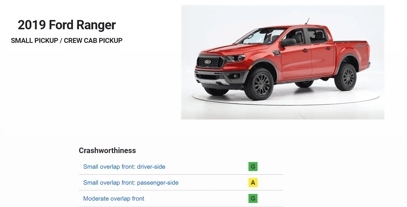

Acceptable rating on Ford Ranger with Crash bar
Marginal Rating of F150 with no crash bar.
You are a sneaky lil Data Queen aren't you. Its obvious but I'll state it anyway; the F-150 is not the Ranger. Yes Ext Cab F-150s were having a problem, thus Ford added more structure that Included crash-bars but that was not ALL they added to the crew cab to give it a good crash rating, they added additional sheet metal cab structure as well.
Show my where Ford EVER had a frontal offset (or head-on) intrusion problem with a 5G Ranger. Keep in mind, apparently, the Euro/African Ranger does NOT have crash-bars and hasn't since its 2012 introduction (This is hearsay on my part, I do not know it for FACT but it has been stated, even on this very thread) and it still gets a very good Euro crash test rating. Even with working on this "all day" you are unable to produce actual Ranger front crash-bar data because its not out there.
I thought honesty and integrity were your stalwarts RP?
