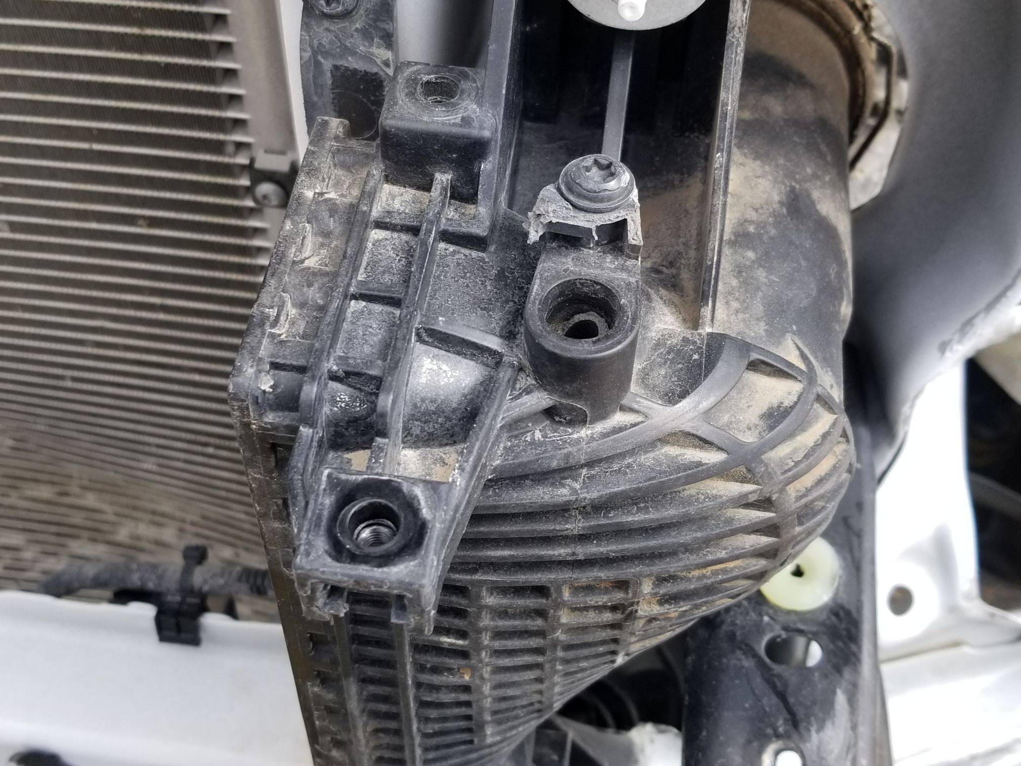

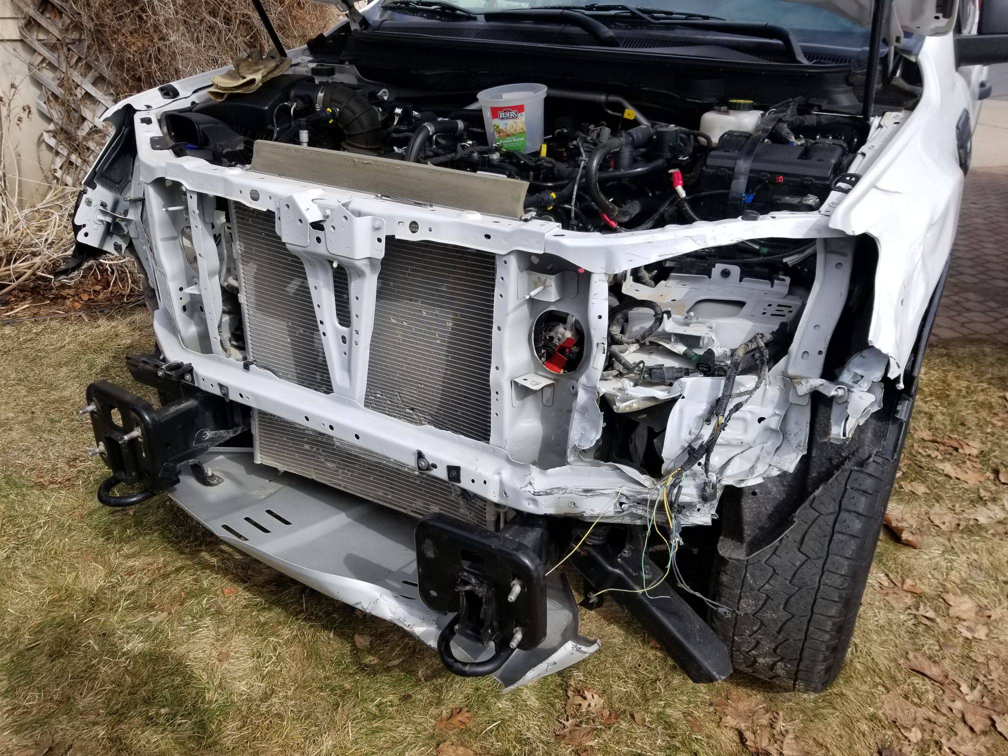

Started removing pieces until rain threatened. My initial comment that the radiator support might look bad but be structurally ok was up in the night. It's toast. Reshaping the body pieces below the battery to level the battery tray and align a new radiator support is going to be a pig. I just hope my neighbors like the sound of hammering and pounding.

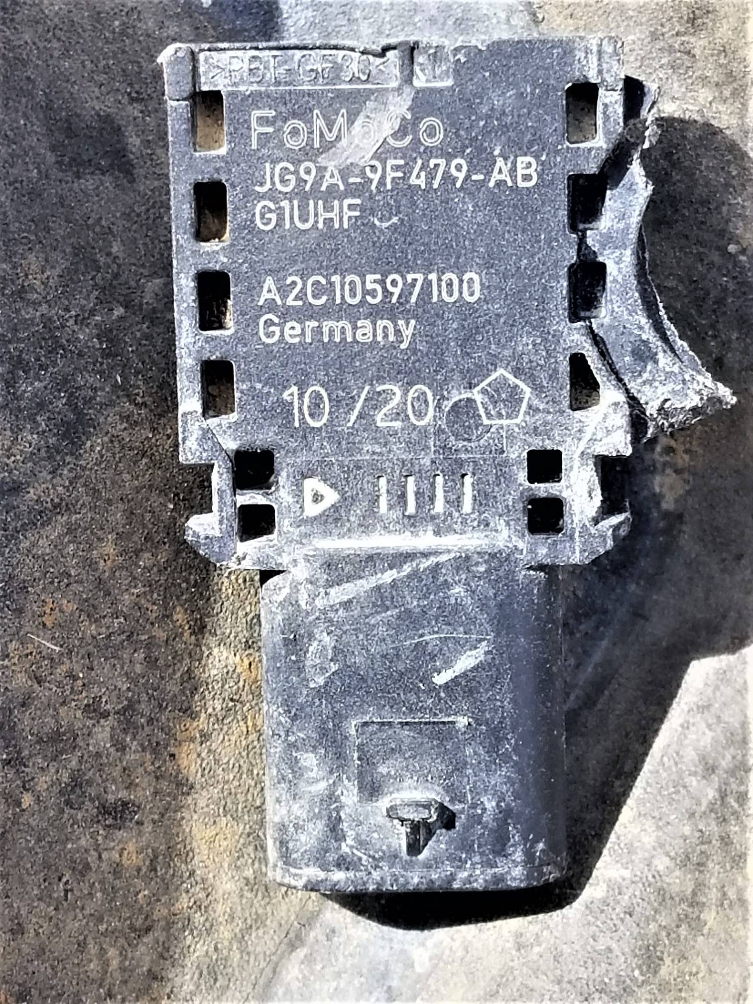

First small mystery is the MAP sensor. It was found in the pile of broken pieces in the bed. Part number comes up as fitting an F150. One parts source indicated this part would NOT fit the Ranger. Obviously it does. The part number for the Ranger is just slightly different but the units look exactly the same.
Also discovered the coolant tank is bone dry and the AC condensor and radiator are a little worse than initially thought. I was expecting to replace them so they'll just be added to the list.

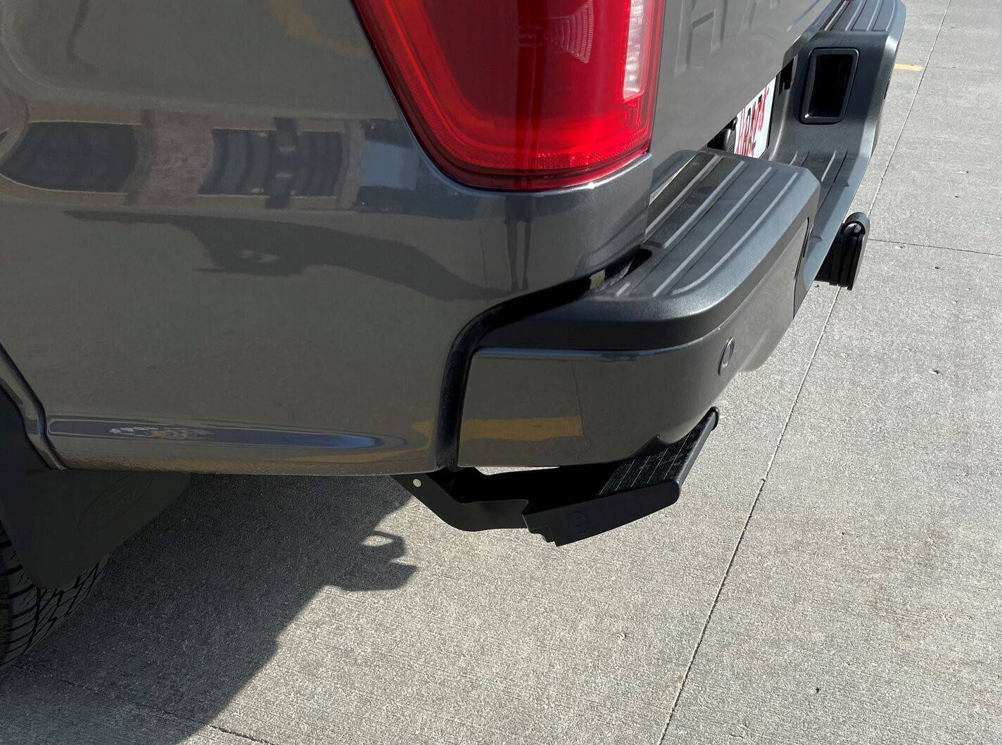

Ha! No. Wouldn't mind a fold out step though to get in the bed. Not much of the end of the bumper is exposed when the tailgate's down.
Ya those would be nice! I have a set of bushwacker fender flares I'm getting ready to list plus my oem wheels an tires.
