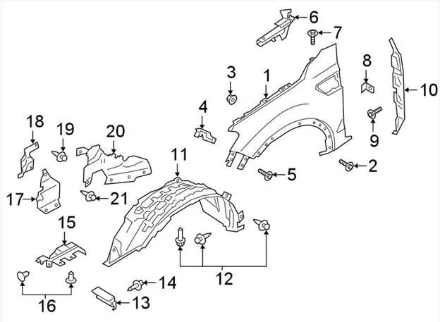

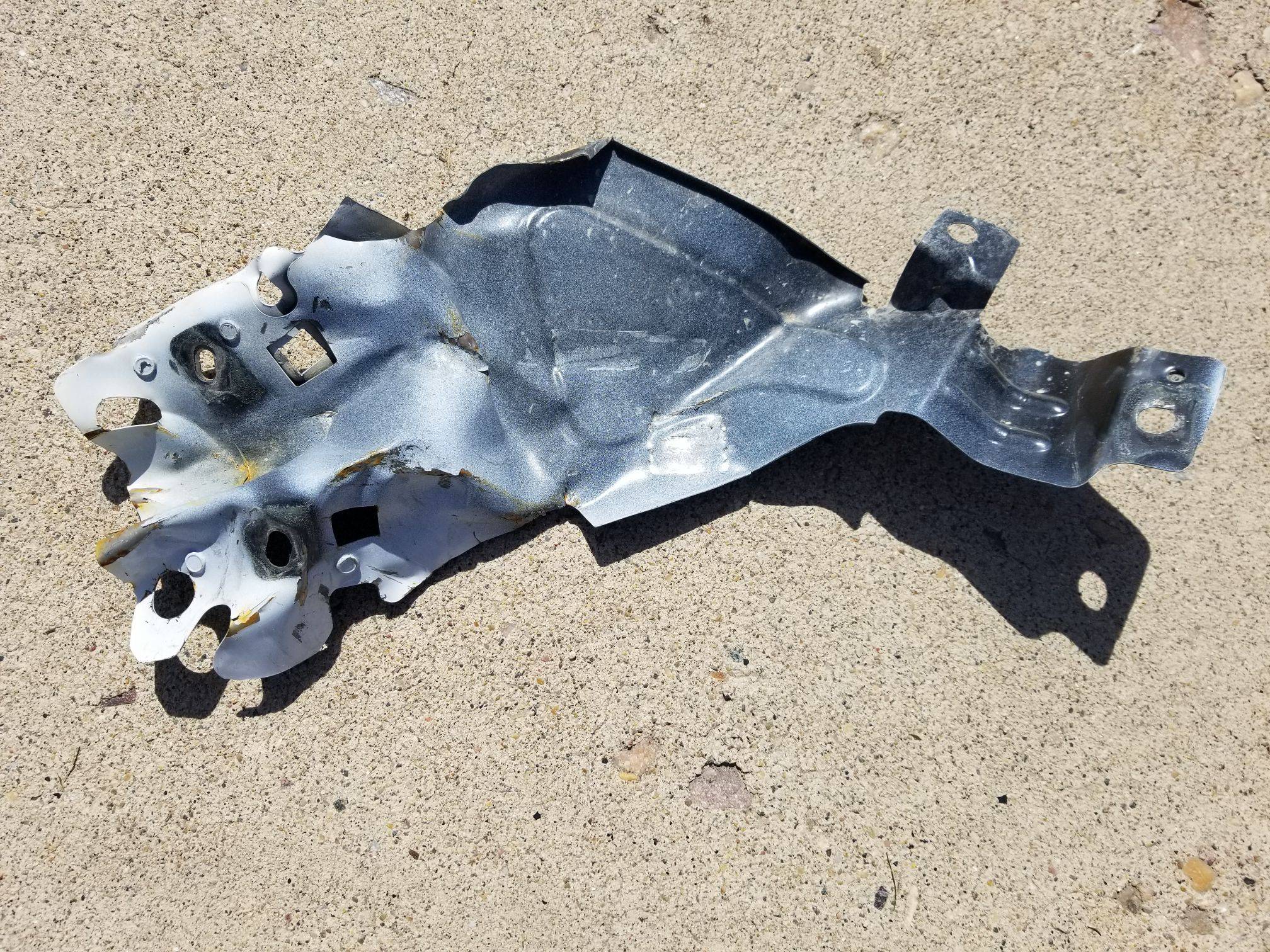

The fenders have a steel mounting piece attached at the front by what looks like a round punch through the steel into the aluminum prongs of the fender. The inner part on the mount is glued to the fender. Pictures I'm finding of the actual fender from sources other than OEM are showing this piece attached. But apparently the OEM Ford part does not have it attached. It's a separate piece. So there’s that issue to figure out.

A Ford parts person told me the OEM fender does not come with the steel mount at the front. Just two prongs sticking out where the metal mount in question is attached. He said the mount at the front was additional and gave me that part number. I looked it up. The number he gave me is for a much smaller mount that's actually spot welded to the radiator support. It was not the piece that's attached to the front of the fender.

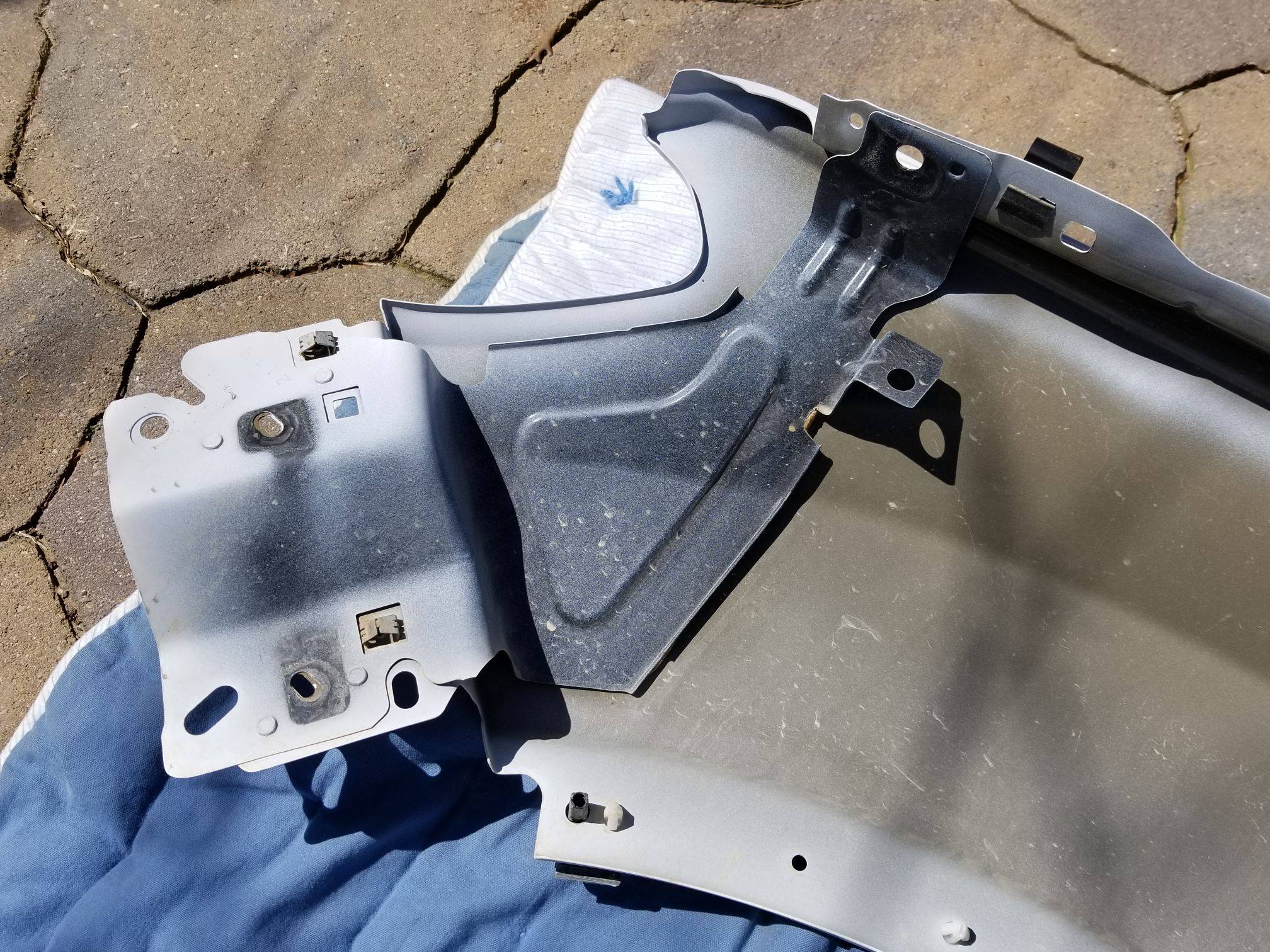

Looked over the part that came off the damaged fender. No part numbers. Sent another email explaining that the part number he gave me was incorrect and that the part in question had no part numbers. I asked if he was absolutely sure the fender didn't come with that mount already attached since it doesn't appear in the parts diagram. No response.
I spoke with the guy I'm working with at the body shop to reschedule and shared the problems I'm having with parts suppliers. He said it was typical. Well, it shouldn't be. Glad this is a one-off automotive project because what should be a fairly straight forward repair has become pretty frustrating thanks to parts suppliers. Live and learn.

Is the part you’re looking for in the radiator support parts list by chance?

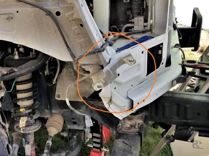

No. The part that mounts to the radiator support, the part the Ford parts guy mistakenly referenced as the part that's attached and glued to the inner front part of the fender, is the part circled in the picture and is spot welded to the radiator support. The mounting part in question that is attached to the front inner part of the fender, is then bolted to the circled part on the radiator support. Then the plastic upper bumper cover mount is attached over these pieces.
As long as the fender I ordered yesterday actually shows up, I should be ok because it shows in the picture of the fender that the part in question is already attached. I think the part is actually attached to the OEM parts fender as well and the parts diagram just doesn't show it. Otherwise there would be a part number on that part and it would be listed separately in the parts diagram, which it isn't.
I think the Ford parts guy told me the fender just has the 2 prongs because all he did was look at the parts diagram, and when I questioned whether that was accurate or not and asked him to verify the actual part, he decided that was too much work and went on a permanent lunch break. My theory, anyway.

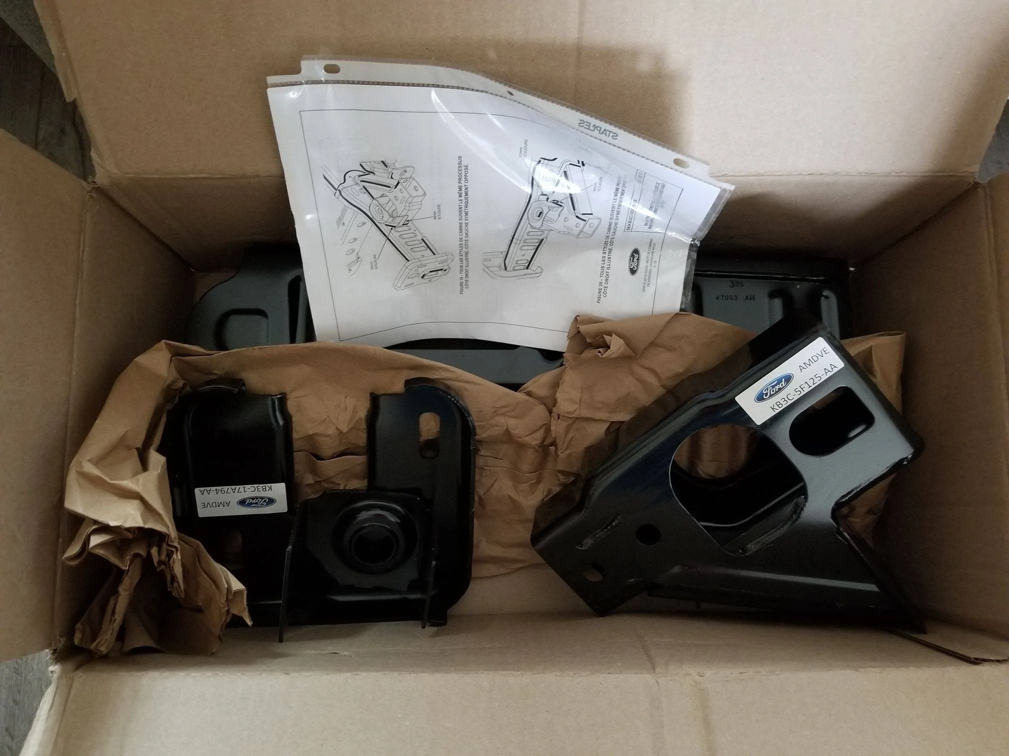

Front frame rail just arrived from Lakeland Ford. At least these parts look excellent. Came with several pages of installation instructions as well.

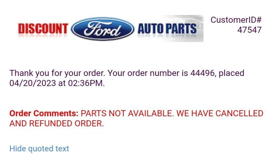

Didn't realize the place I ordered the aftermarket fender and radiator support from would take up to 10 days to ship. That seemed sketchy so I cancelled that order. Drove to a large Ford dealership in a nearby town and asked them about the mount on the OEM fender. That guy was able to pull up a real, live, genuine picture of the OEM fender and it has the steel mount at the front.
So, the Ford parts diagrams showing the two prongs are incorrect. Had I not cancelled the fender from the Mid-Tenn order because they couldn't verify the part, the fender would have been on it's way. However, when I went back into their site to order it again, the fender was mysteriously $50 more and local pickup only. Odd. So I ordered the fender from the local Ford dealer. Their price wasn't unreasonable.
Then just for the heck of it, I asked how much a radiator support would be. That wasn't so reasonable at over $600. But that's ok because I had ordered one from Discount Ford Auto Parts. But of course, later I get an email that those dipsticks CANCELLED MY ORDER. What is with these parts houses?

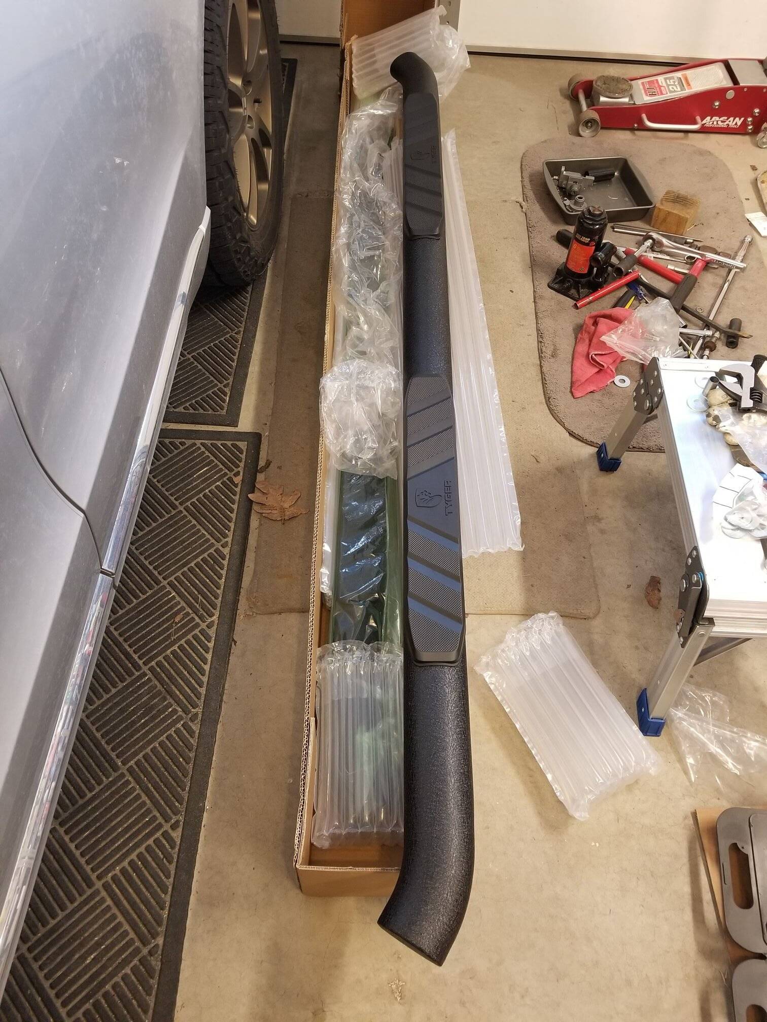

At least something fun showed up today - new pair of step rails.

due to covid 19, the war in Ukraine, Unibrow, pig feet, dingle berries, and climate change your order cannot be delivered. It is now canceled. Thank you for your business!
i say that as a joke but it seems like a common set of excuses since 2019.

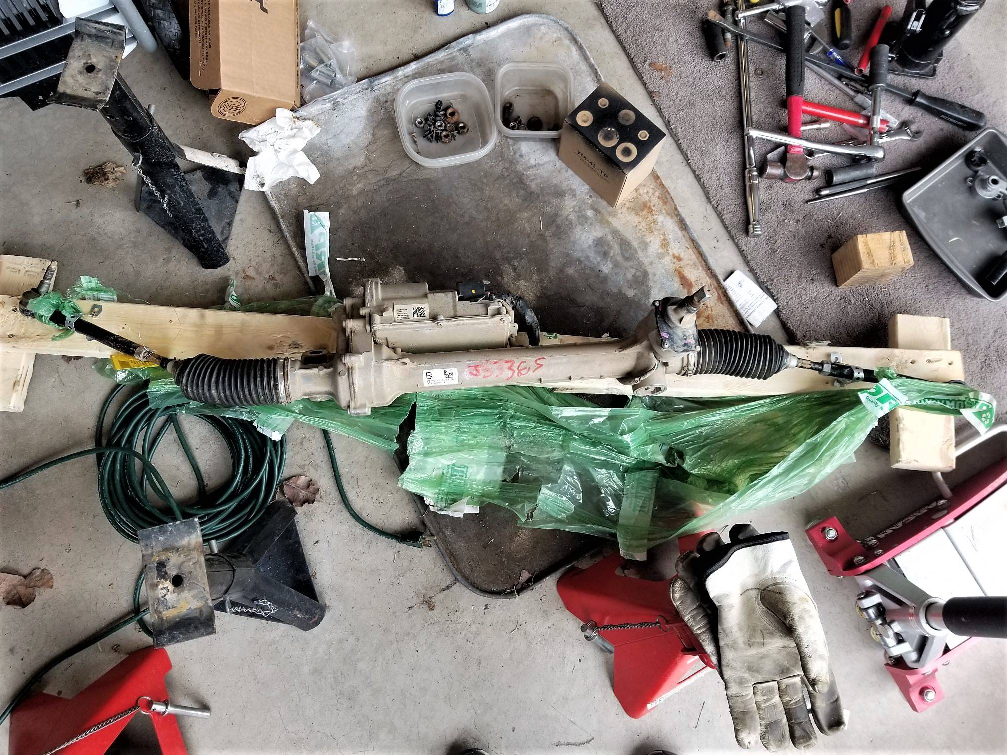

Replacement steering rack arrived today. Not as pretty as mine but at least it isn't cracked in half. It will be all purdied up when installed.

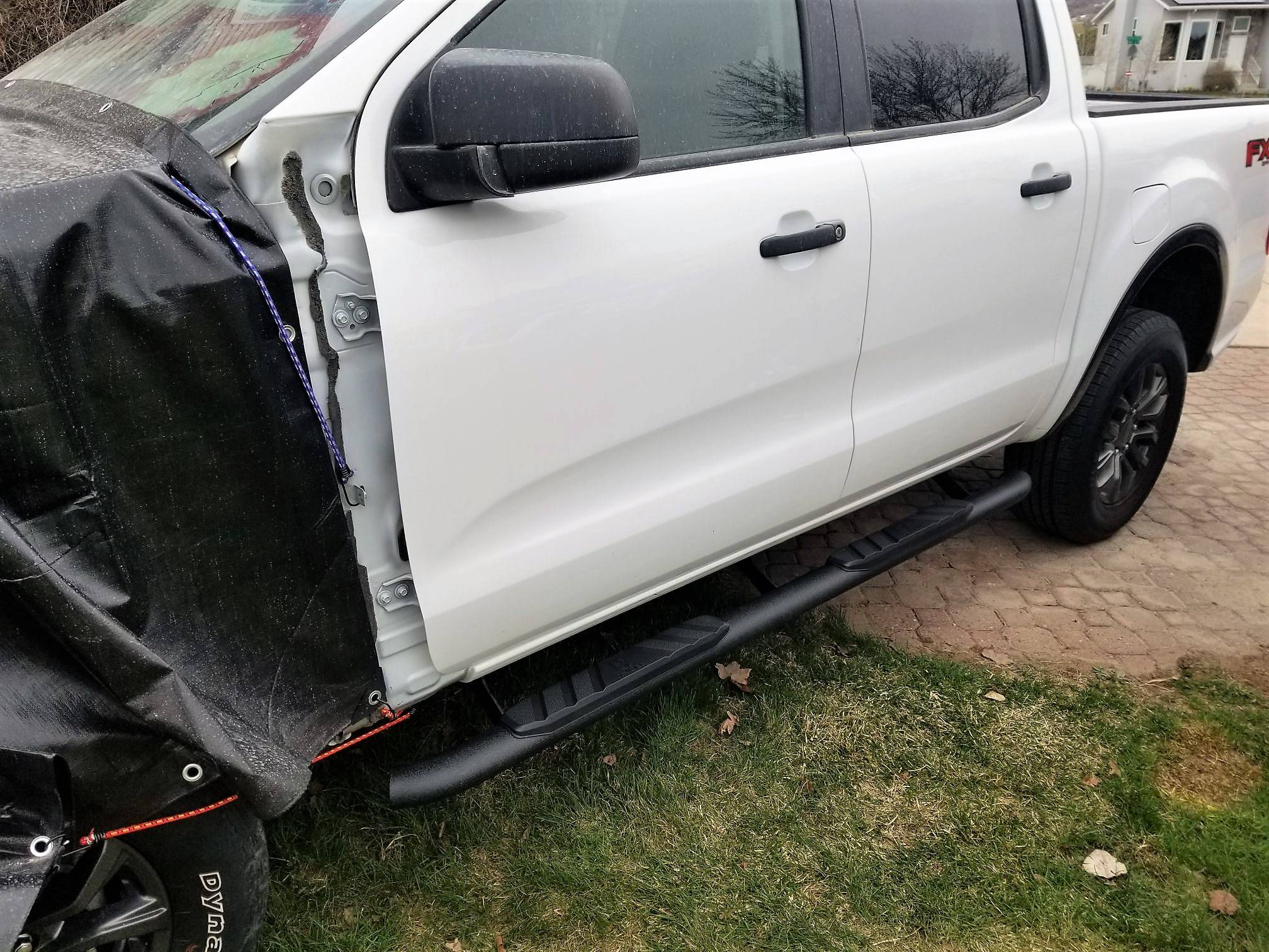

In lieu of finding a place to store the side rails, just installed them. Wanted simple and clean so I like these. They hang about 1 1/2" below the chassis. Don't plan on climbing over boulders but it will still be nice to get a few more inches of clearance after the lift and 285's go on.
