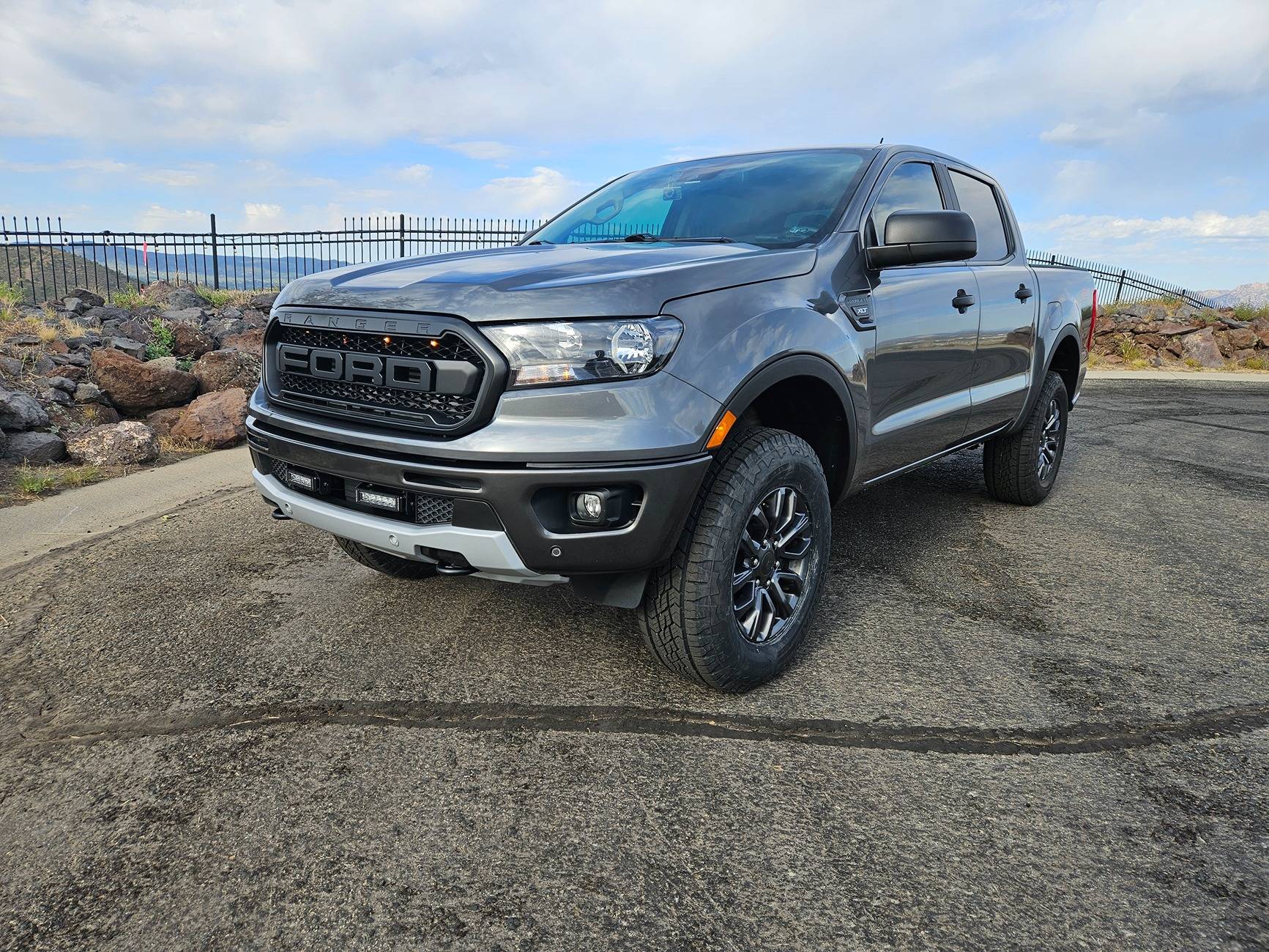

I just wanted to go 3/4" to level it up a bit. The higher you go in the front, the bigger the hit to highway MPG. I measured to the center of the wheel opening front and rear. The guy that installed the front swore it went up 2" but the tape measure said .80". I went with Eibachs and they are better than I expected. Improved handling on the twisty mountain road that I run twice a week and handling over fire roads and pot holes is vastly improved. They are reasonably priced and come with the Eibach Limited Million-Mile Warranty. I would definitely do the rears too. 75% of the ride improvement was with the rear. You may find Bisteins rough on dirt roads. This is a great article that should help guide you. https://www.shocksurplus.com/blogs/news/leveling-strut-comparison-bilstein-vs-eibach-vs-fox
