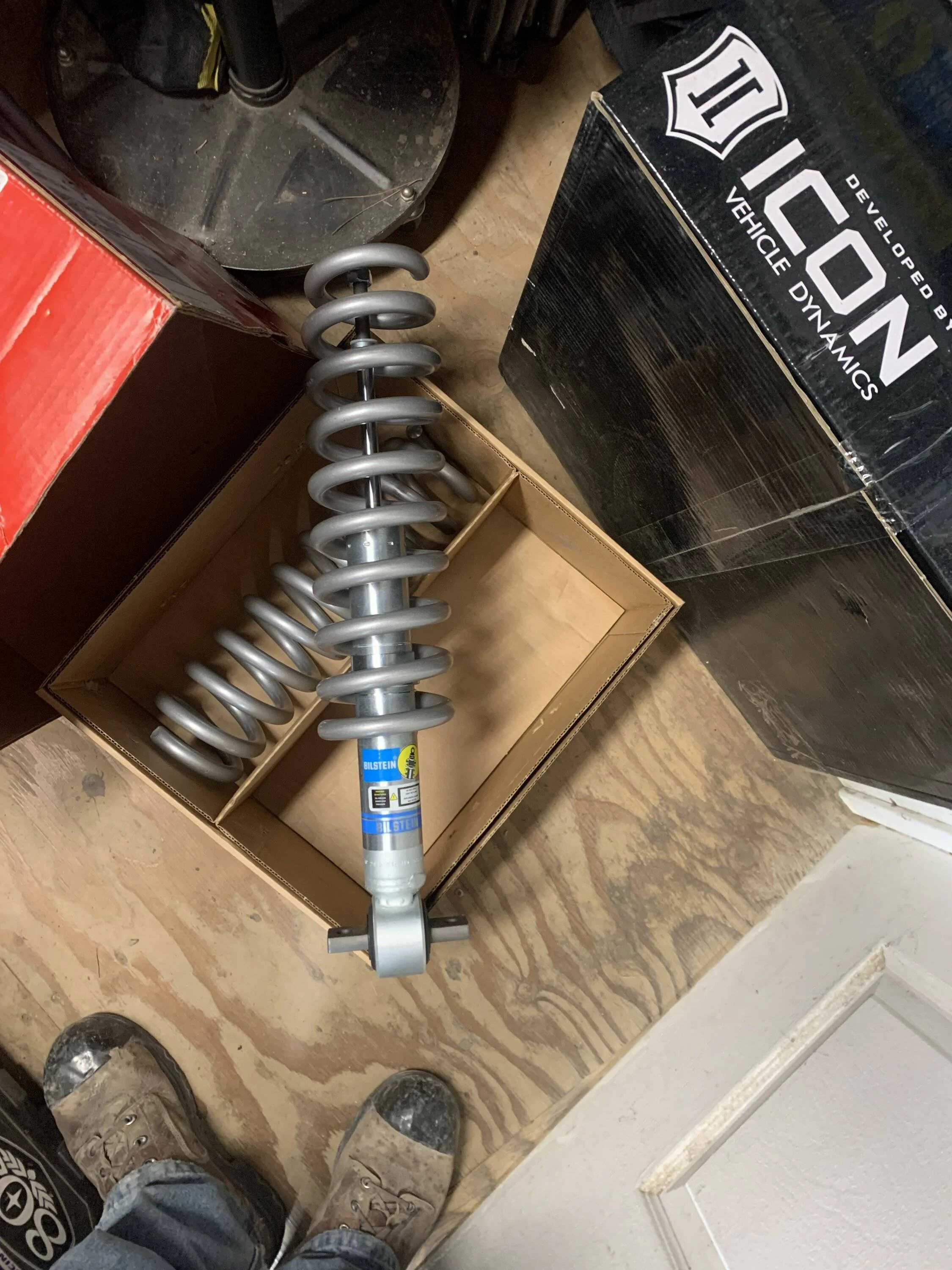

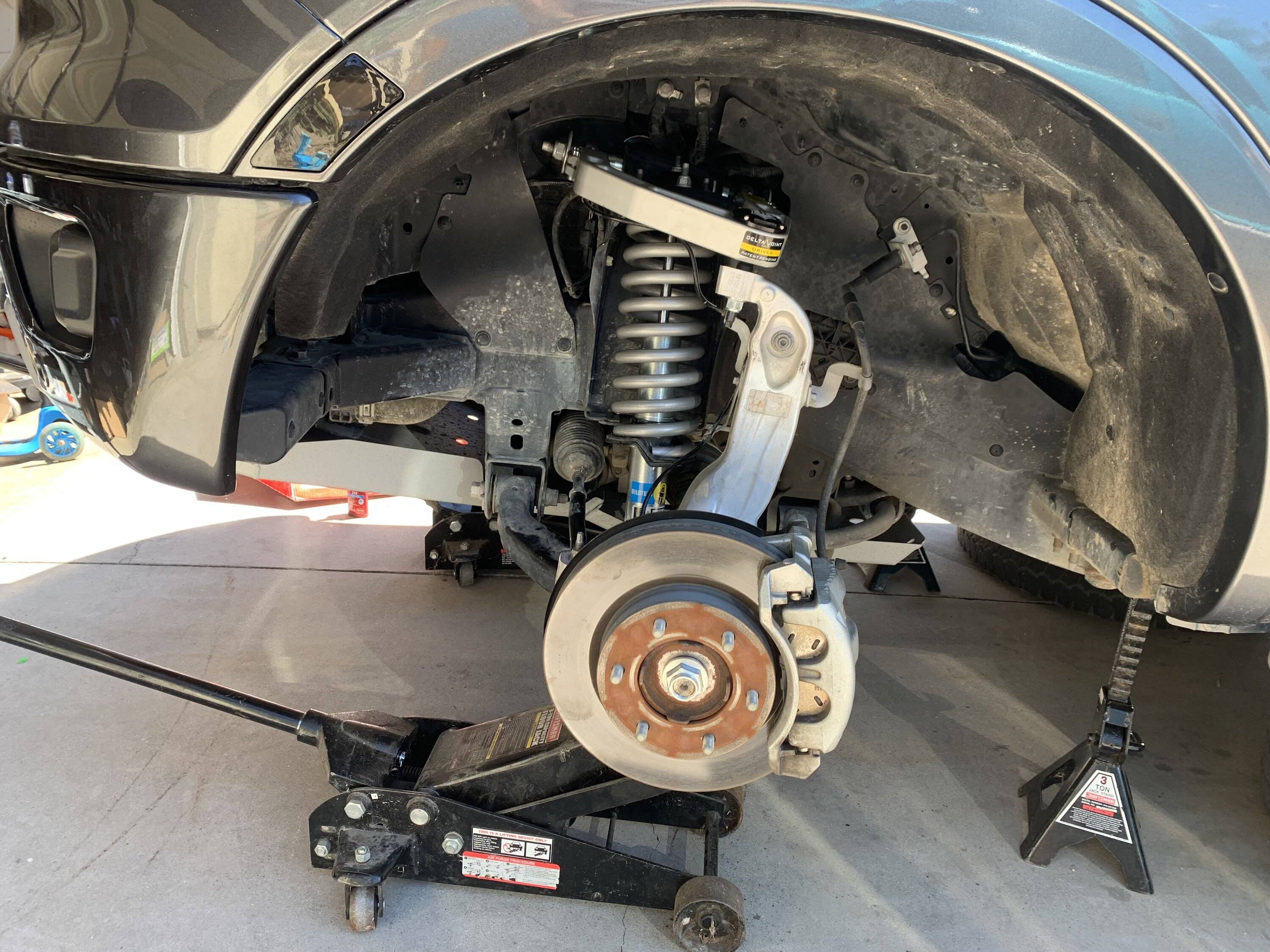

I think most on here would recommend you pony up for a proper suspension leveling system rather than just a spacer lift. Fox 2.0 (I have, and quite like), Eibach or Bilstein kits, all of those will give you the level you want and dramatically improved suspension performance.
And any kit for a 2019-2022 should work on the 2023. Only time you'd need to be more careful is if you gets something with upper control arms as the earlier Rangers have aluminum spindles while the later ones swapped to steel.

Eibach or Bilstein is a 100% improvement over stock. Just change all 4 at once and if price is no issue I’d recommend OME BP-51 with rear leafs. I plan on going to BP-51 hopefully soon. Right now I’m running 5100’s set at stock setting with Eibach springs I get 2.5” - 3” lift and still have full stroke on shock instead of lifting with tension ring.
