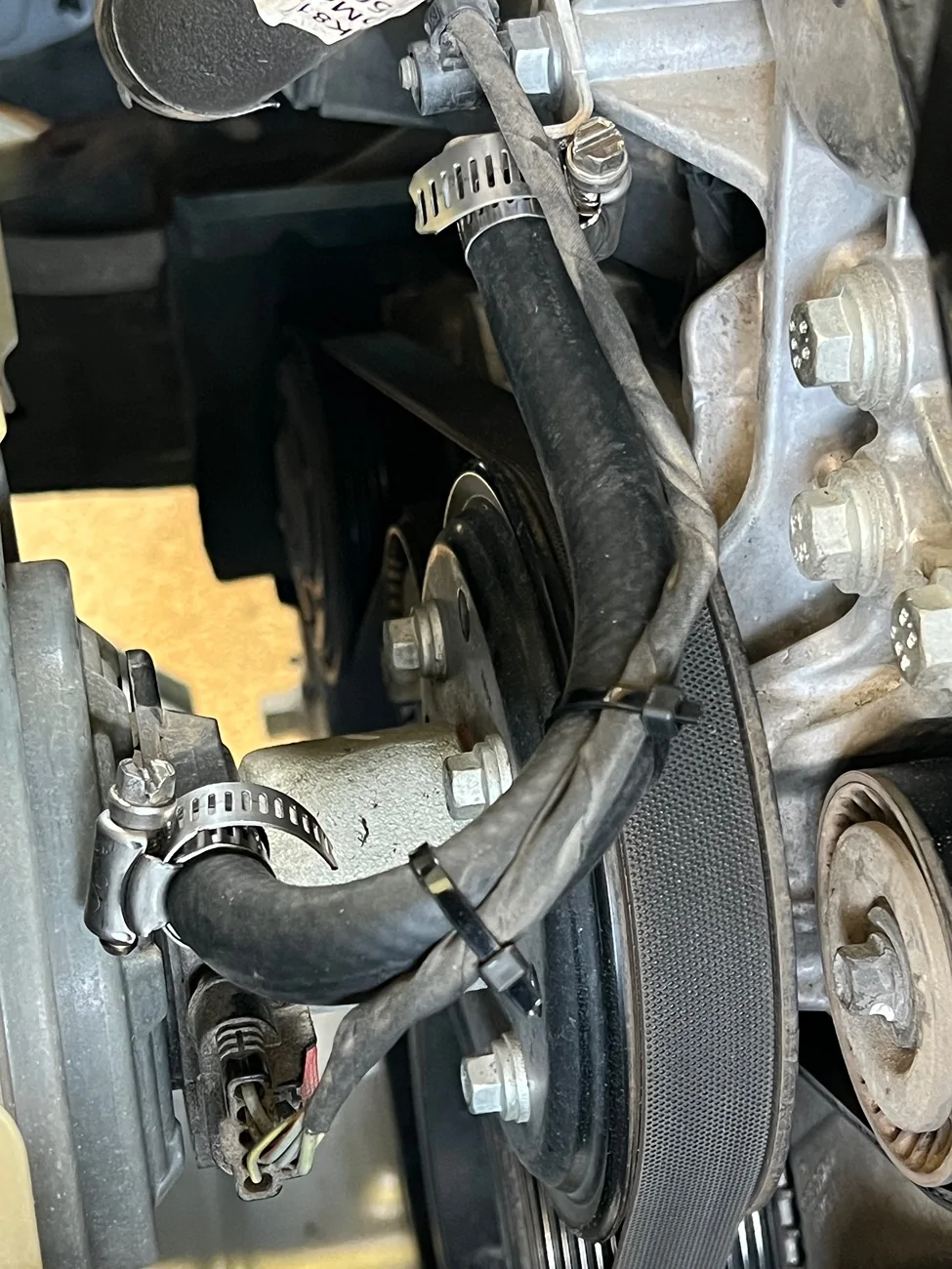

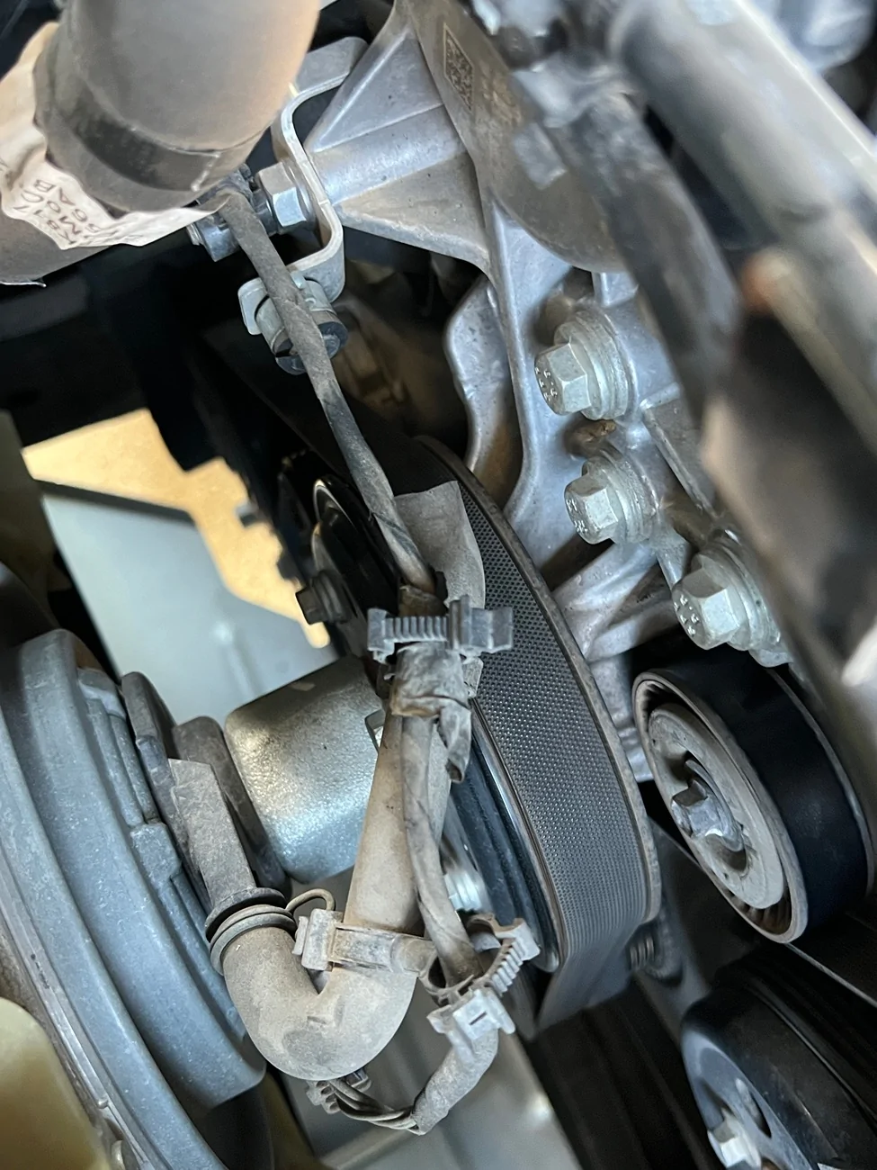

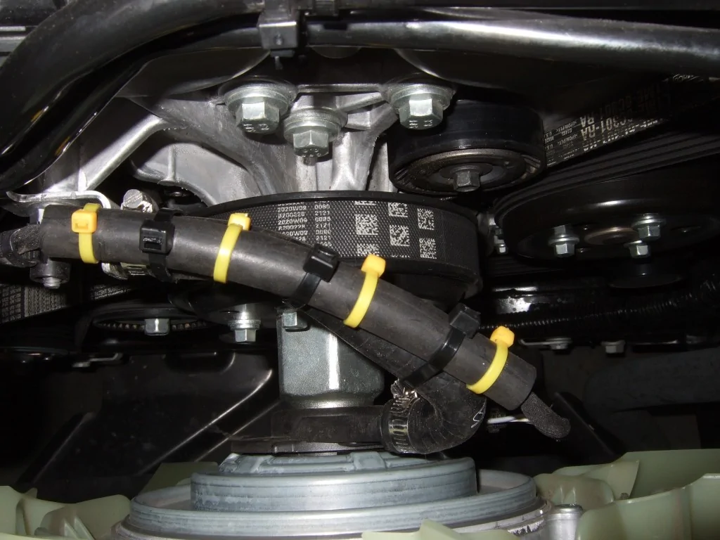

I’m bummed about OP’s experience with the hassle and cost involved, but super grateful it was shared with the forum as it prompted me to have a look at my own assembly and plan ahead to replace the hose regardless of what I found. I got an 18” piece of 3/8” fuel injector hose from AutoZone and brought out some clamps I already had at the house and then went out for a look. The hose was sheared off at engine side. Just glancing at it I wondered if it had been rubbing on the belt based on how close it was to it.
As you can see, the answer was “yes”……
…it was definitely rubbing on the belt. Needless to say I did not reuse the zip ties. Based on the shape of the new hose, I used 8” of it to make my new assembly.
The camera angle makes it look as though the clamps are too close to the harness and the back of the fan, but can assure there is plenty of clearance. The zip ties are a temporary solution until I can source some of those fancy swivel ties, and I placed them based on the harness’s natural shape and to minimize movement against the protective cover.
Add this experience to my growing list of reasons why I am super grateful for this forum and the knowledge shared here. This could have turned out very bad for me.

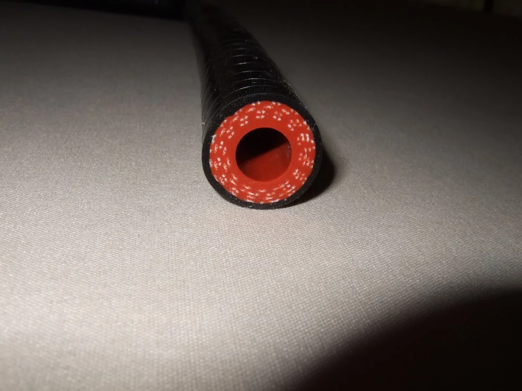

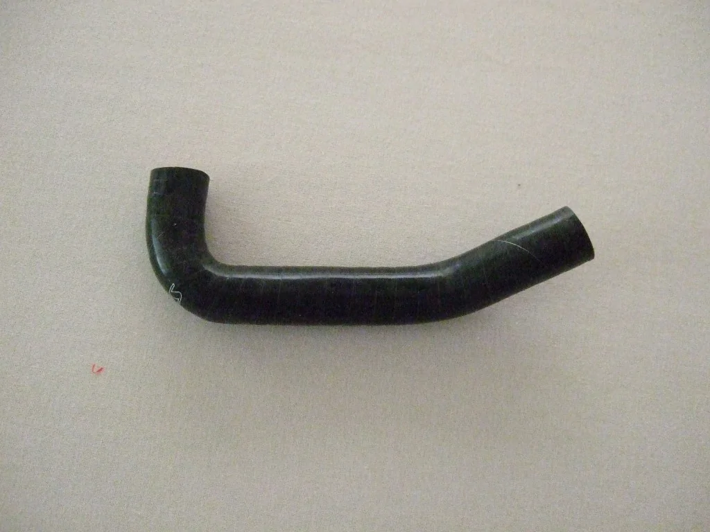

I used a flexible silicone hose and shaped it to the same form as the original hose by inserting a 3" shorter section of 0.25" diameter soft copper tubing into hose, leaving 1.5" free on each end to allow some flex.
I then slit a length of 3/8" fuel line hose, placed the cable inside, and used 4 zip ties to reseal the hose, then 3 zip ties to secure the hose to the top of the Silicone hose. It has held up now for 4+ years. I don't care what it looks like, I only care that the cable is protected. I built it this way to protect against two possible failure modes.
  1. The hose decaying, most common
    - The silicone hose solved this problem.
  2. The idler pulley failure, less common but happens in my model year.
    - The second fuel hose over the cable solved that one. It also protects against a belt failure.

With 45k on my '21 Ranger, I found my hose cracked and off on the engine side. Repaired with 3/8" fuel line. Good as new!

I had to do the same fix on my 2021 Ranger XLT 2 days after I bought it. After combing through the threads, I came across the aforementioned link showing the clutch assembly. I went to the parts store and opted for the power steering hose in lieu of the fuel hose. Power steering hose is much stiffer than fuel line. Bought 12" of 3/8" power steering hose and 2 band clamps and zero issues since.
