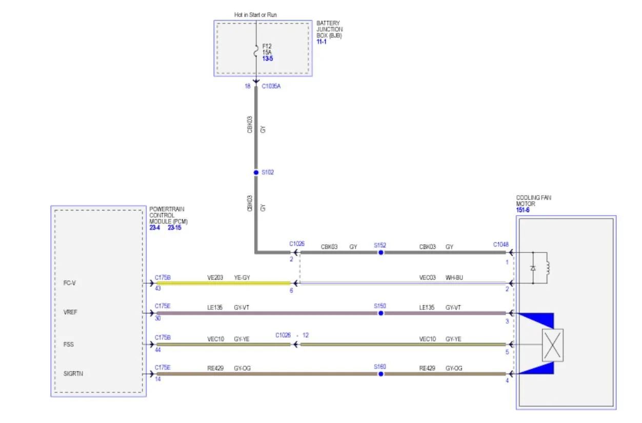

Here is the schematic for the fan controls. I would check for a short to ground on the vref and sigrtn to start, with the fan connector unplugged. Check on both sides of the connector. If no short to ground is found, check the other wires for a short to ground.

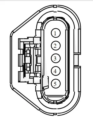

The root code out of all of them is: P06A8 - Sensor Ref Voltage, this is VREF circuit specific, so that spot where you say you see bare wire is the possible spot, I would open the harness up to expose the wires up the harness approximately 12 to 18 inches from the connector.
They make a replacement pigtail, but you will have to splice it in with environmental splices
PN: WPT-1504
Pin 1 = Pwr 12-Volts
Pin 2 = Fan Speed Control
Pin 3 = VREF
Pin 4 = VREF Signal Rtn
Pin 5 = Fan Speed Sense to the PCM
Your issue most likely lies on PIN #3 - The VREF circuit (Note this is a 5-Volt Circuit)
Key On - Engine Off - Check for 5-Volts (4.5 is normal) between Pins 3 & 4
with the leads hooked up - shake the harness and see if voltage reading fluctuates.
