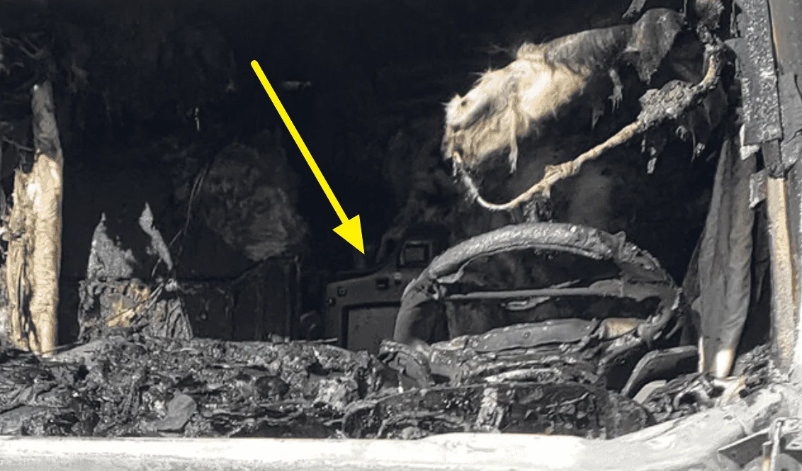

Amazing how much is gone with plastic & aluminum removed.
How did this survive ???
heat rises, passenger compartment is fairly intact. (seat is also not completely burnt away.) IMO that supports that the fire was mostly in the engine compartment. bed cover seems completely untouched. either the gas tank managed to not light off, or FD arrived in time to keep it from doing so? would be interesting to see investigation report from someone who knows what they're talking about. :D
